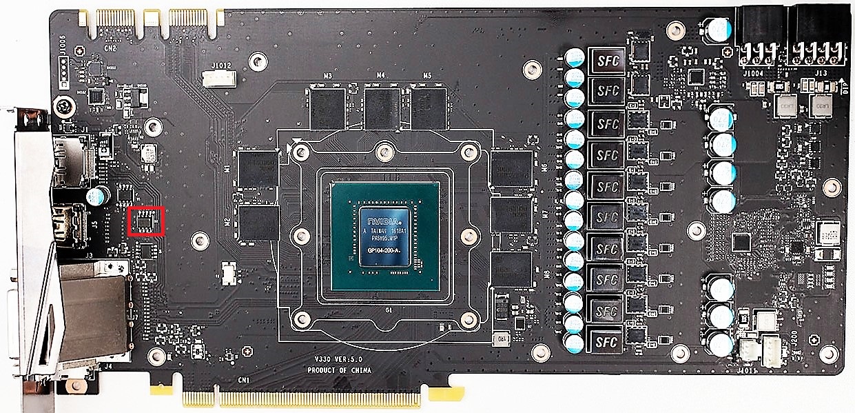

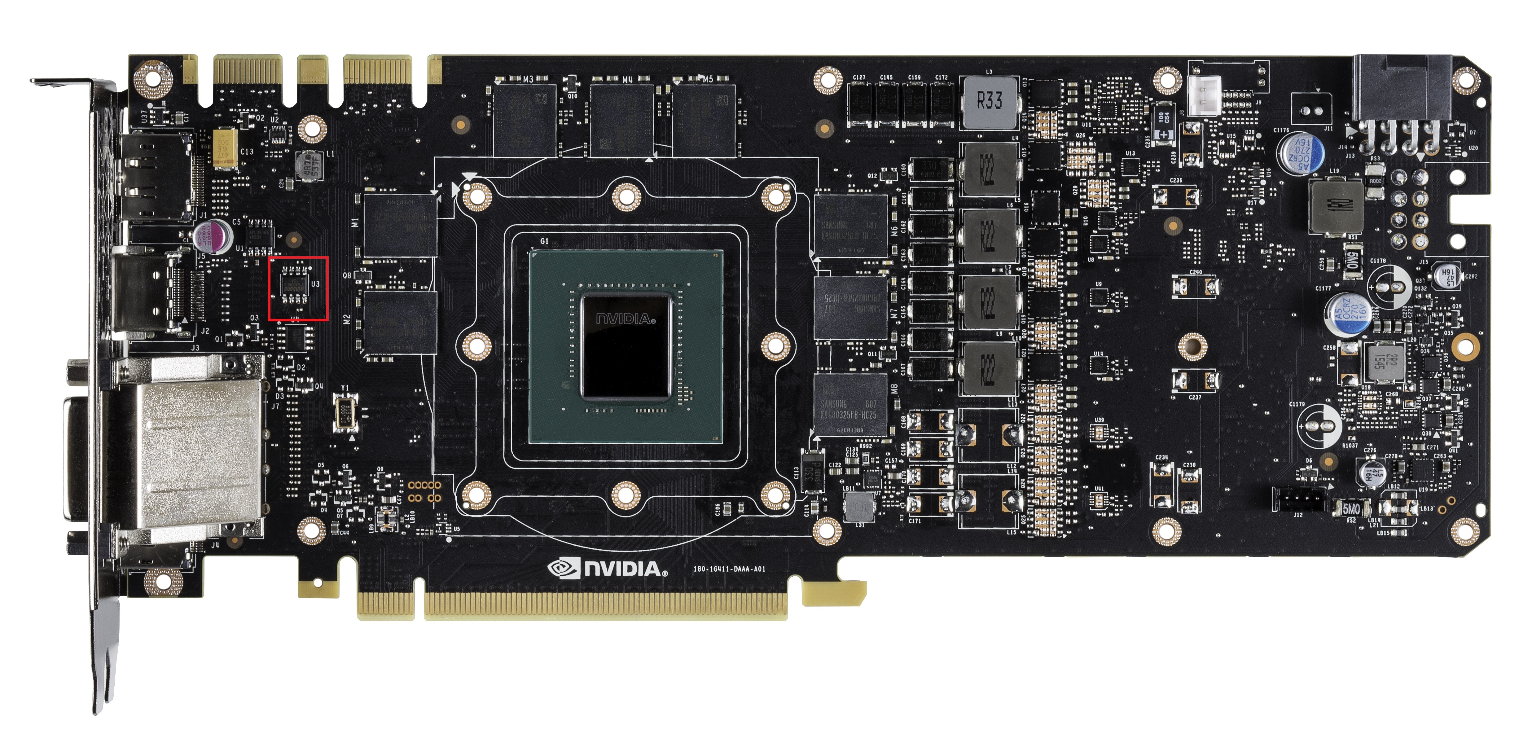

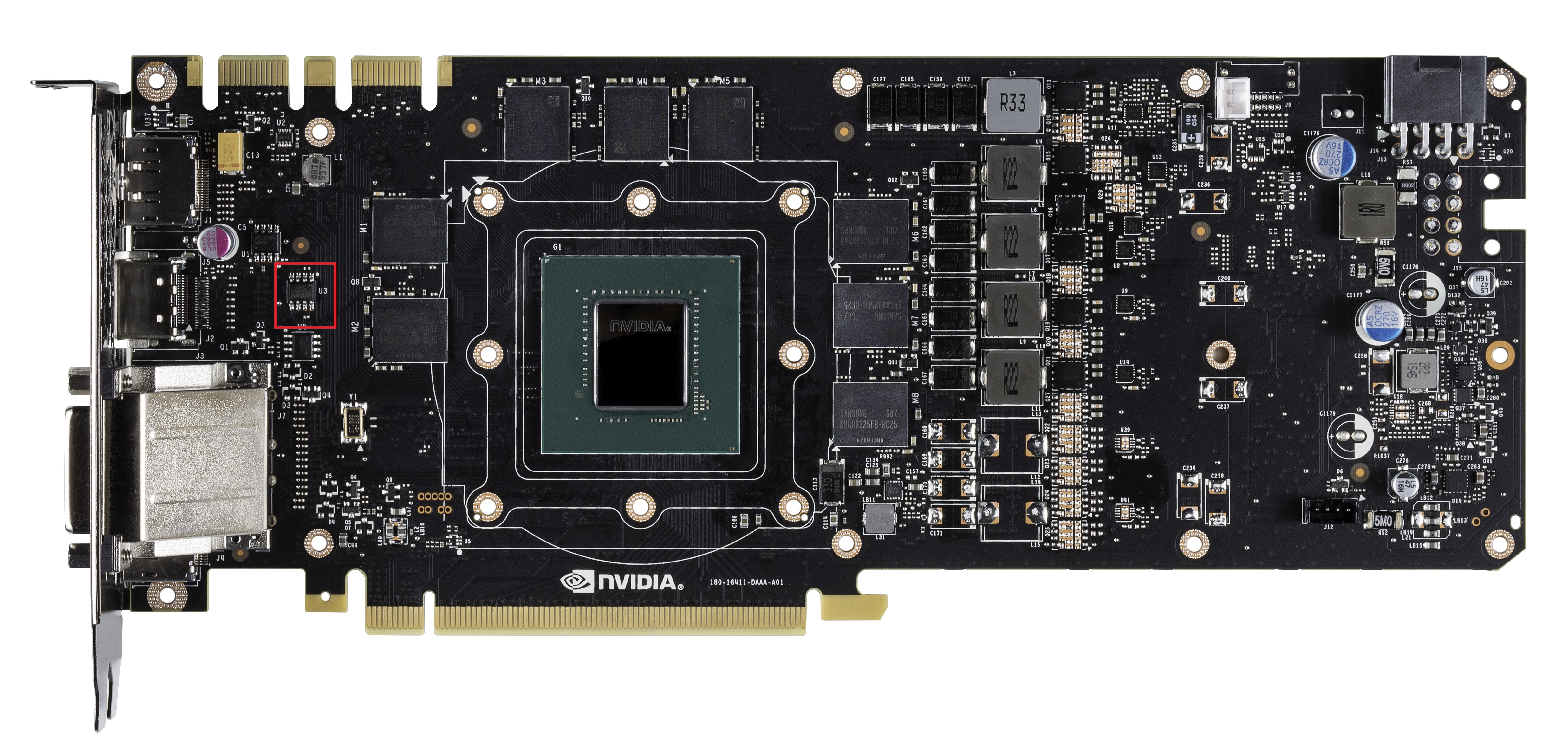

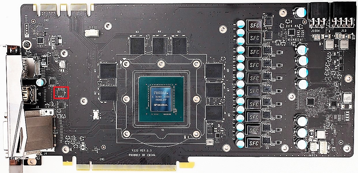

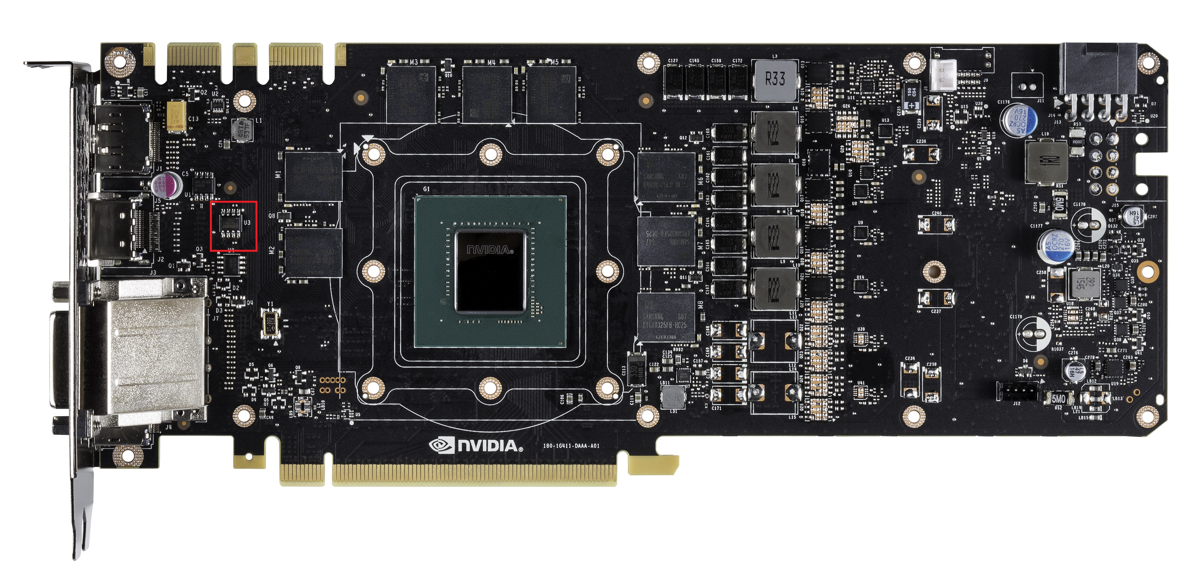

Just for reference, regarding the spi flash, i have attached two photos (thanks google 😉) of a gtx 1070 factory pcb and then a pcb of msi/asus. Both designs seem to use a 4mbit (512kb) Winbond 25Q40EW 1.8V SPI Flash.
