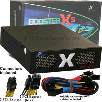

Can you tell me what brand/model of PSU you are using in the lower optical bay? I'd like to look into this as an option. Thanks.
I'm running the FSP Booster X5. I put it in about 4 years ago. This type of PSU is pretty difficult to find these days. I saw one last week (VisionTec brand) on Amazon and scooped it up as a backup in case I ever have a problem with mine.
Another good option is to use an Xbox PSU (easy to find). See Prince123's post here.

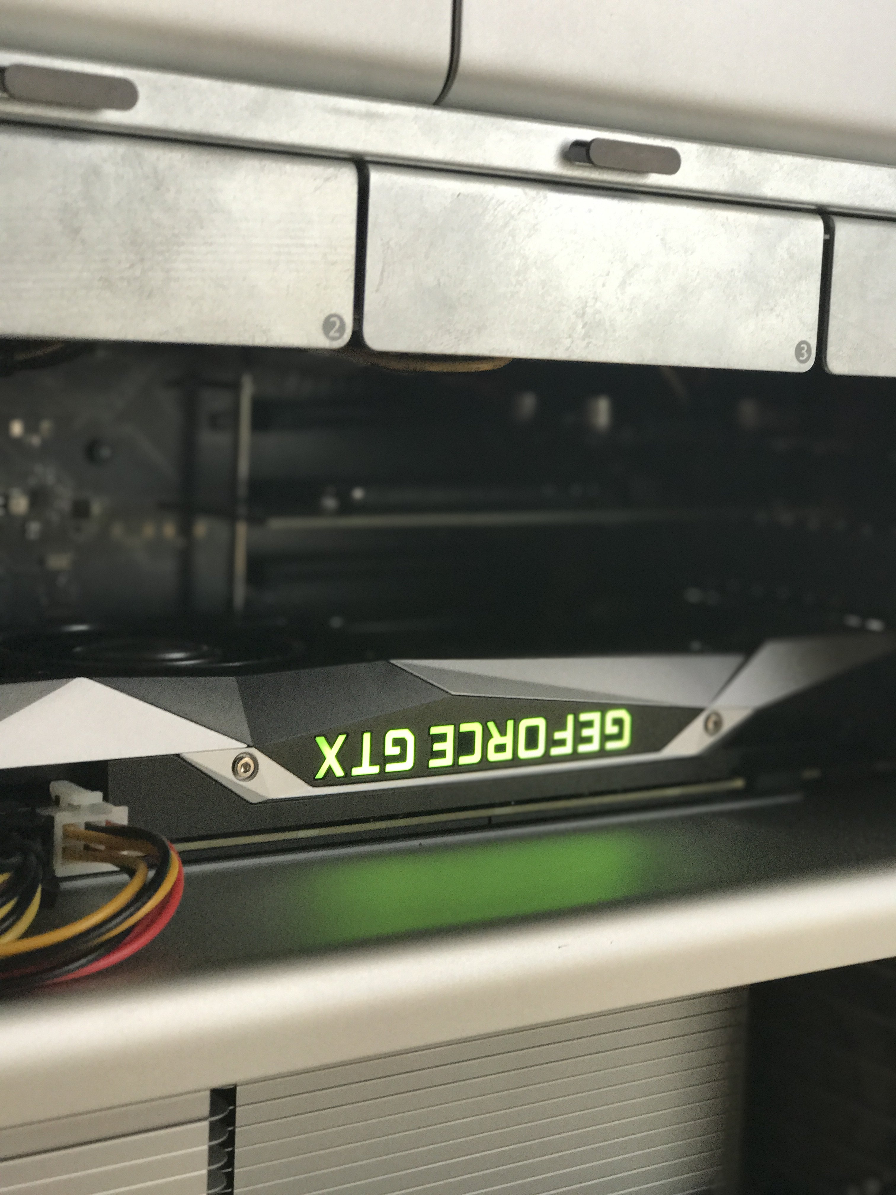

Used few month with bay 3 n 4 sata to 6 pin and dual 6 to 8 to drive Ti no matter mac or win 10 is work fine. Asus 1080Ti FE
