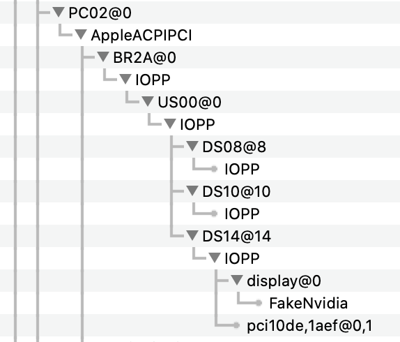

So far, so good. After rebooting the login took a lot longer, and the screen went black in the middle of it. That *felt* different.
But still: kextstat | grep -v com.apple does not yield a result.
Any ideas?
So yeah, seems not to load for you as well. No idea what is different with joevt's setup.
But there is a major difference: sleep mode "kind of" works... at least the display goes off, and "waking up" does not crash it. But it does not really sleep either, at least the lights on the USB components are still on and the computer fans are still audible.
UPDATE: seems joevt's solution seems to work anyways! So the messages regardin kext not being loaded may be misleading. I too noticed the longer black screen on boot, so I thought something must have been happened.
So I just put the MP into sleep, and guess what! It woke perfectly! Maybe you just try the same?
Edit: just saw your message, and at least for me it seems that the machine is able to totally shut off.
Maybe others with 30XX sleep problems (apparently that affects all cards) can try this route as well, and see how it works?
Edit2: so there is another hint that this is actually working, just look at the ioRegistryExplorer (screen attached)
Now, the quesion would be if this runs for Big Sur as well, but apparently on Catalina it does!

kextstat doesn't show codeless kexts because a codeless kext points at a different binary for the code. In this case, we are using the binary that includes the IOService driver, which is the base for all other drivers. The binary is com.apple.kpi.iokit.
Yes, ioreg -rn FakeNvidia will tell you if it got loaded.
OK, understood - thanks. And by the way... thanks for all your support, you have been of great help!
What do you make of this though? It says !registered and !matched... (but obviously it somehow worked)
Code:
+-o FakeNvidia  <class IOService, id 0x100000aae, !registered, !matched, act$
