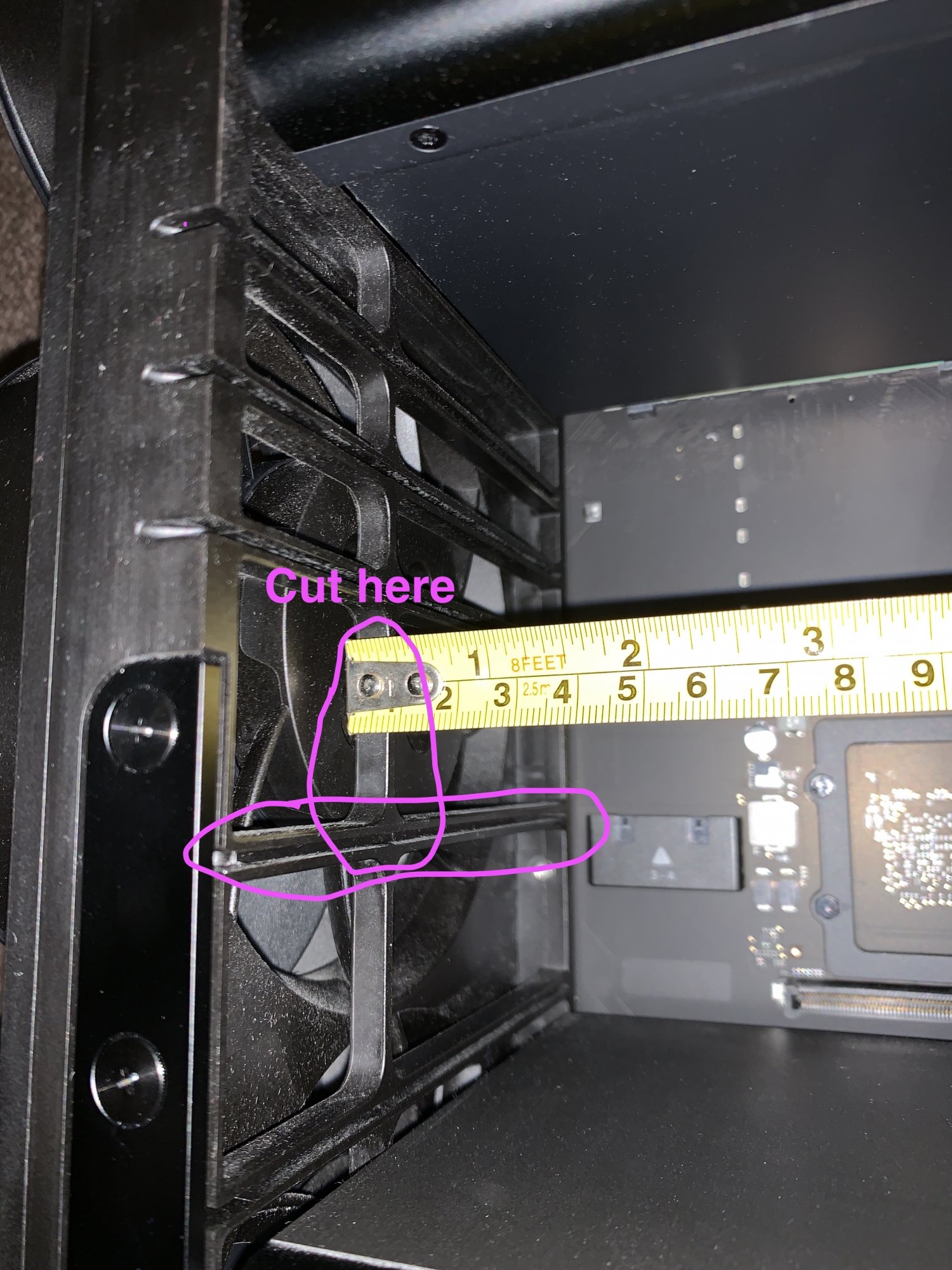

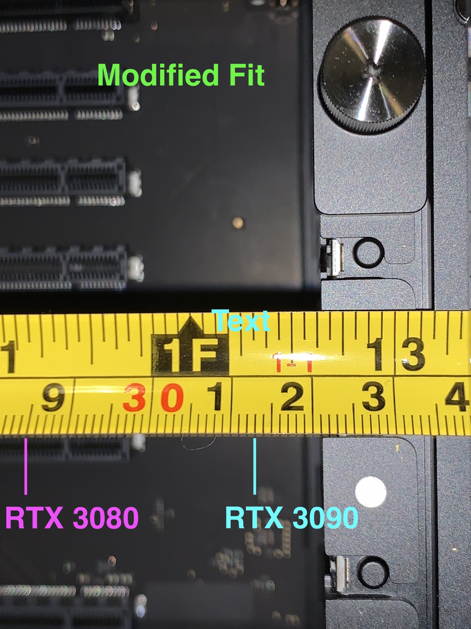

I just successfully placed an order for a 3090 on Nvidia.com. Only issue is the card is 313mm and I'm nervous about cutting that part in the computer to make it fit.
Reactions: MadJuju
Has anyone actually done this? Tips and tricks please! Cutting up a $12k computer is very scary.

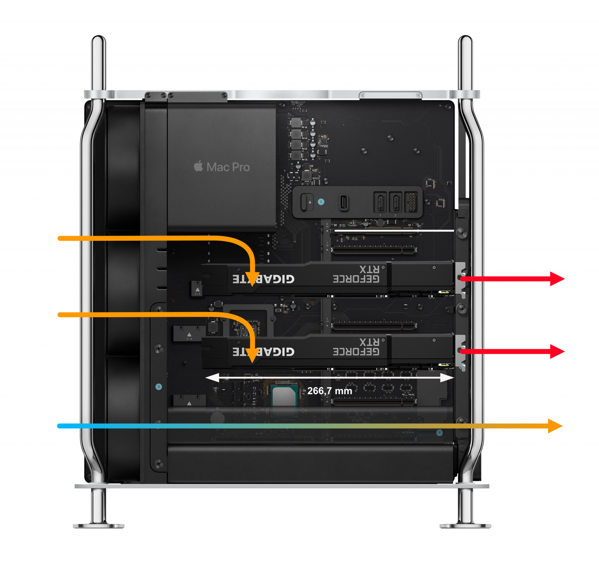

I'm just curious to know if the Mac Pro can power this beast. If it works I will adopt this config. 2XRTX3090 blower edition.

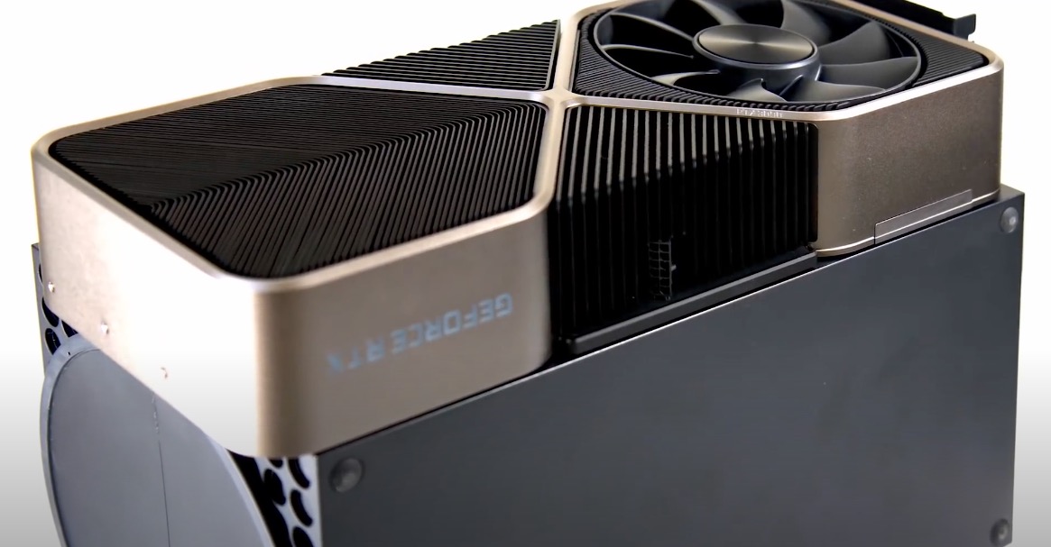

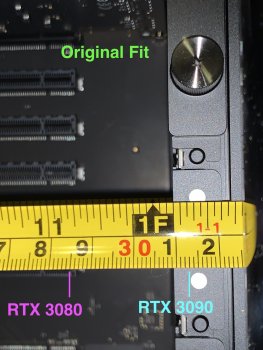

For reference, here is the precise fitting of both founders editions, note that 3080 3rd party cards are larger than shoown here.

I would say a blower design would be the best, right? So the Gigabyte one looks quite interesting to me, and looks like it would fit into the case without cutting anything.
I'm considering a 3080... so only the Founders Edition has a blower fan design?

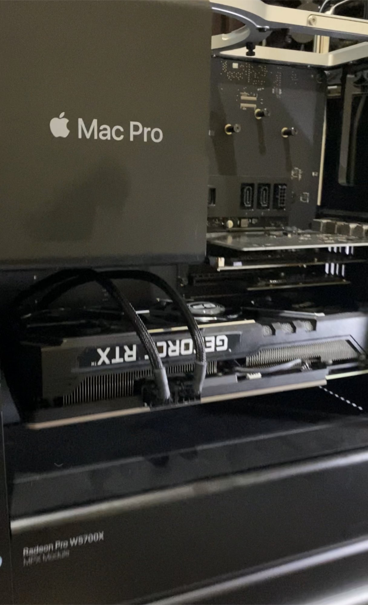

got my RTX 3080 today
installed in the Mac Pro 7,1 very easy process, also installed latest nvidia driver
View attachment 957405View attachment 957404
doing fast testing using 3dmark and play doom eternal well it is a 100% up performance vs W5700X
Do you have any thermal problems? Or noisy fans?
So far until now there is no problem whatsoever, even I overclocked the card and test using game(s) and benchmark apps. I set the fans to at least 50% that's keep my card cool and still quiet while using it

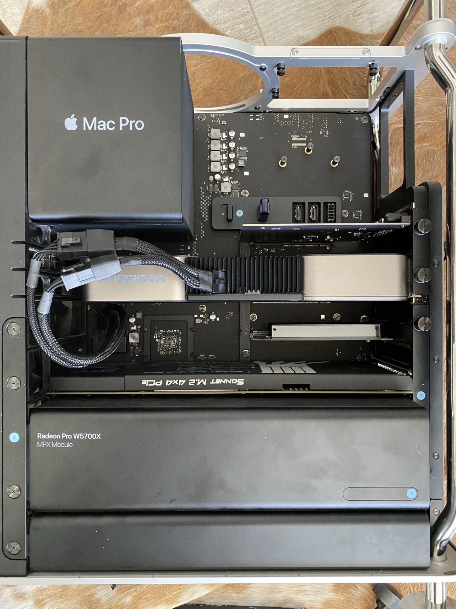

I switched from the msi card to the founders addition. Much cleaner look and a better fit in the Mac Pro
Awesome! Thanks for sharing.
How does the card perform? Any hiccups? Did it fit without any mods? Noise? Does increase the internal case temp significantly?
I'm I correct that you have your card in PCI-E slot 5 and Sonnet in slot 3? What's in slot 4?
