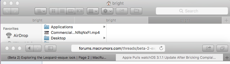

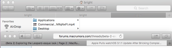

There's some issues getting the inactive tab-bar state to not be as jarring. It seems to be the case that Finder totally owns that part of the system -- I worked on the issue last night and tried in different ways to duplicate the front active window look to the inactive look when the Finder is in the background - macOS Sierra cares not for that.
What I'm seeing is that the inactive window background has to be a darker grey but not too dark so that the font color is washed out. The issue with doing that is that there's a line that goes around the active tab in Finder and other apps that use tabs - and that has to be found and eliminated. I'd like to just have it be transparent .. we'll see how that goes.
I'll work on it some more.. too bad that the author of ThemeEngine never implemented a live preview of the Finder when changing elements - and I can't code to save my life - I would never get off the island if all I had to do was code to get off.
The thing I said about the inactive Finder tab appearance being fixable is to be taken with a pinch of salt.

That's the line - it's really persistent.
Yeah - a SIMBL plugin is probably the way to go :) I think perhaps the author of cDock could help since he helped us with the Dock already and also DoctorDark for dark windows. He can't help with our menubar in El Capitan and Sierra(I asked him in a previous thread - he doesn't know which process controls the menubar he explained and if it's even patchable)
The thing about the window frames when just using ThemeEngine to edit the .car files is that there's nothing that control the tabs separately; the gradient or image goes all the way down from the top window edge down and takes the tabs too.. in order to have everything fall into place I will have to create custom gradient that stops where the tabs begin and then shift to a different color or gradient for the tabs.
There will have to a few stops and starts in a gradient for the tabs to be readable - I don't think a darken out the tabs would be preferable - if I understand correctly you would want to also darken the text for inactive tabs?
I once experimented with a theme that had a black/darker than usual window gradient/color and stopped right where the tabs begin(from the top edge) The issue with that I have to take account for margins too so that it adapts to the window with or without tabs without looking too weird according to my idea.
And with less a live preview you can imagine the copy pasting that goes on ;)
I have an idea that has helped me before; take a different .car an work from that . there's the AccessibilityAppearance.car that can sometimes do the trick with certain issues(it helped swapping around and renaming a few .car files for my dark theme - it was less ideal because as a user you would have to copy all original .car files out and replace them all in order to go back because I renamed from other files to a SystemAppearance.car(if I remember correctly - might have just been the VibrantLightAppearance.car - in order to change the titlebar font color to white)

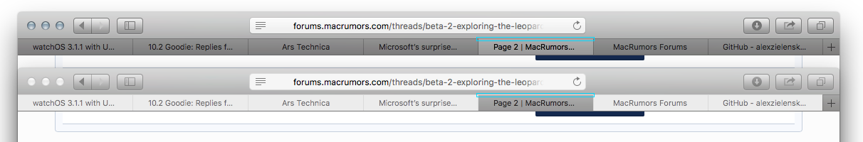

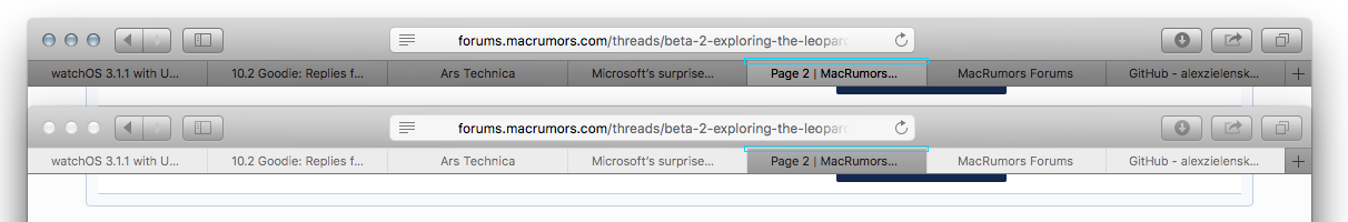

The tab bar coloring is a bit strange. The issue is not for inactive tabs when the window is in focus, but an issue with inactive tabs when the window is not in focus. When the window is not in focus, inactive tabs are completely white, which looks a bit out of place. There also appear to have two different looks for inactive tabs. Top: Finder, Bottom: Safari.
Now that I think of it, Safari may be an anomaly. Probably because Safari is drawing its own tab bar, since Safari 10 has to retroactively support El Capitan...?

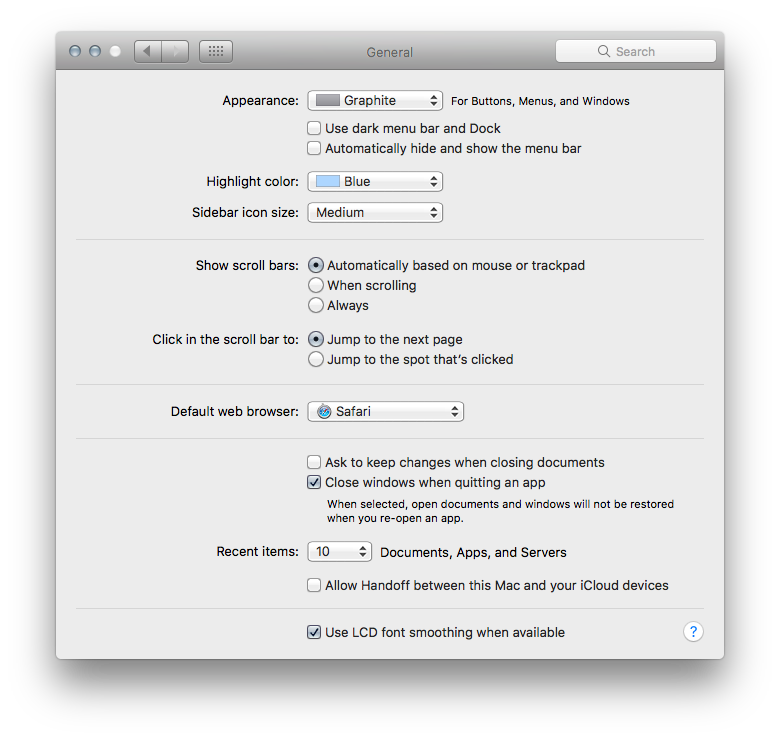

The SystemAppearance.car file provided by allan.nyholm can co-exist with XRevert with a catch. Install XRevert first, then replace SystemAppearance.car with the one from allan.nyholm.
Then go to System Preferences -> General -> Appearance. Change it from "Blue" to "Graphite".
This is because macOS loads resources of Aqua widget controls from GraphiteAppearance.car, rather than from SystemAppearance.car when the appearance is set to "Graphite". While at the same time, macOS still loads resources of titlebar/tool bar gradient and button shape + masks from SystemAppearance.car.
It all works together nicely.
