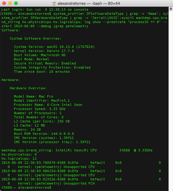

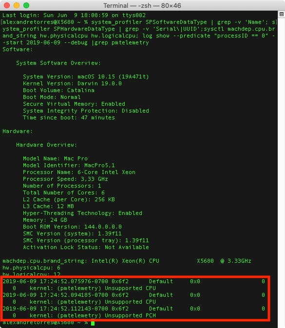

Another item for the Apple won't support MP5,1 with Catalina:
I think those things have been in Mojave as well, you can see them at the end of the verbose log just before the GUI loads
I have seen it on other Macs as well so I dont think its a 5,1 thing specifically
Yep, you are correct. I remember seeing this with MP3,1, don't remember ever seeing this with MP5,1 until now.
Reactions: LightBulbFun

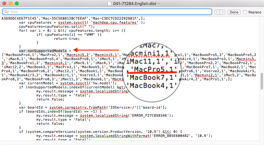

  2. Before anyone asks again, Catalina is not supported (actively blocked) on a MP5,1:
The block showed above is in the distribution file, InstallESD.DMG/OSInstall.mpkg/Distribution. It's a double block, since you need to add the boardID to the list of supported ones.
Looks very similar to the way you had to hand build the installer for El Capitan on a 1,1. Once I figured out all you had to do was clone an El Cap drive and drop the appropriate files in the right places it was dead simple. I forget but I think you did the same thing with Leopard on G4’s below 700MHz. Cloned the drive and then dropped it into the machine.
If all you need to do is drop in the board ID and get rid of the MacPro 5,1 comment on the MPKG all you’re going to need to do is edit the plist file on the MPKG. You’re going to have to do it as a root user though or as “System”.
Thoughts?
Thoughts?
Installer is not working with the edited OSInstall.mpkg, no one seems to know why yet.
