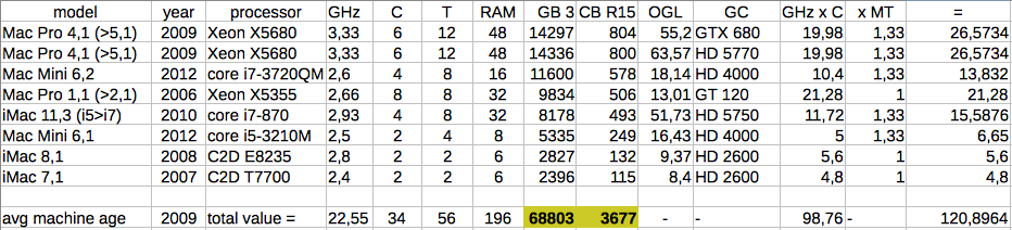

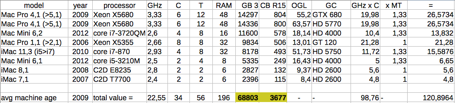

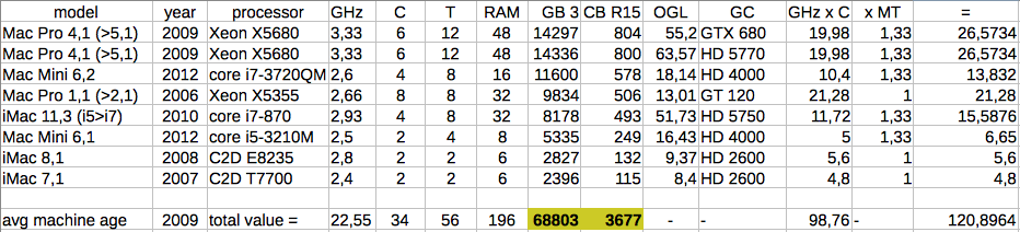

In the beginning of this year I had a render farm described in the attachment. The speed increase stopped at 5x of the host machine somewhere between 5-6 machines total in my team render network. So the slowest ones are to be dropped now. Actually they allready have been dropped, they were not usefull. I have a faster one to replace 4 of them. And I need to upgrade the LAN from 100Mbps to 1Gbps too. It surely can be a bottleneck here.
But teamrender is good to have. Sometimes 5x speed is undoubtly a good thing, isn't it.
