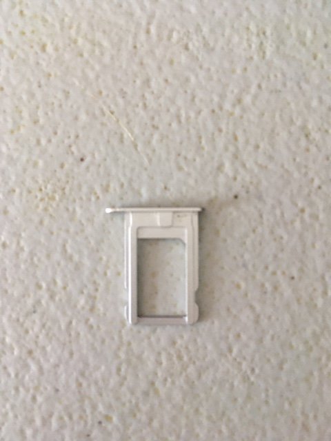

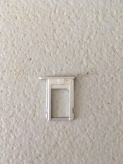

Gently, gently tap with the smallest hammer you can find or use pliers. Something like this if a small hammer isn't available
Ear, tab, flange many different names used to describe that area of the tray

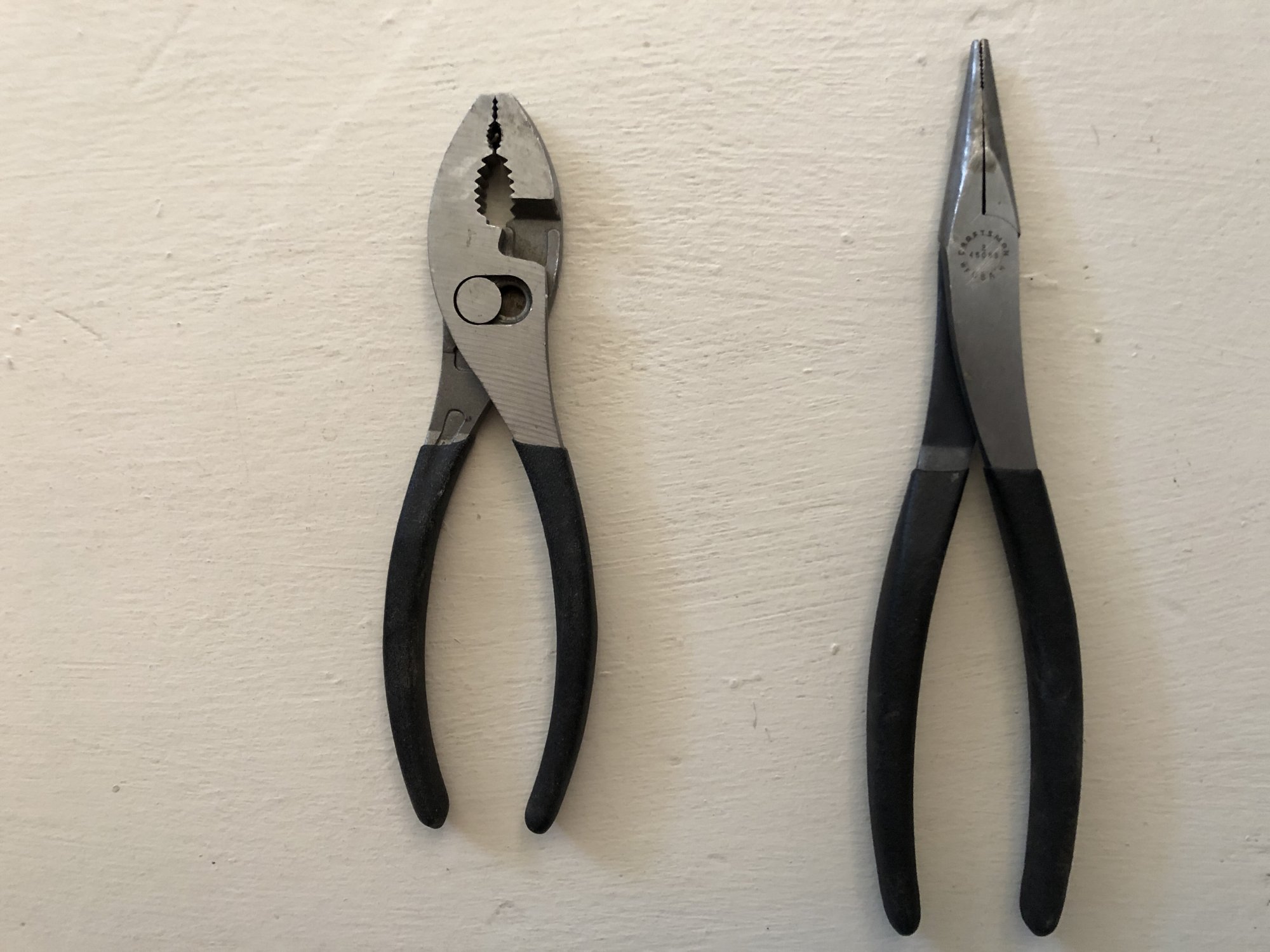

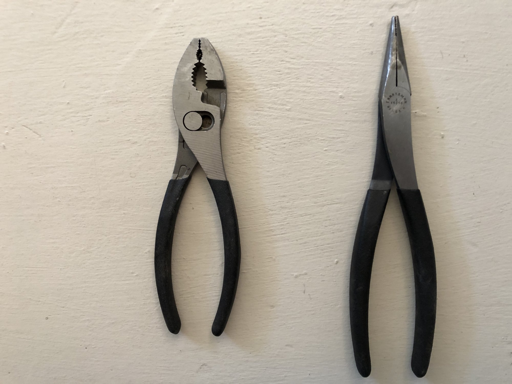

I used one of those pliers in the photo to unbend it. I then put sim card into the sim card tray and pushed it back in.. It doesn't look like its pushed back in completely but very close to it though. But when i power on iphone... still shows

You have a new pic after bending it?
Yea I will post it up in few minutes. For some reason having some issue with my iphone at the moment sending to my email.
Care to share it so I can see the repair
For some reason, when i send the pictures from my phone to the email, it doesn't send for some reason. Earlier it did... I do not know why.

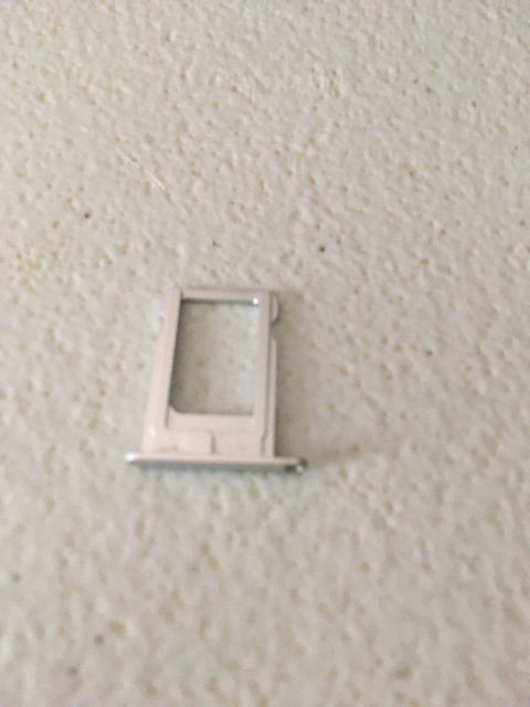

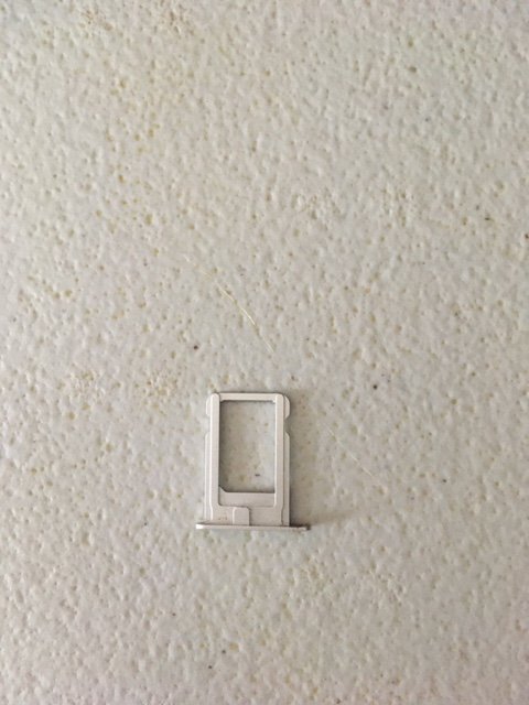

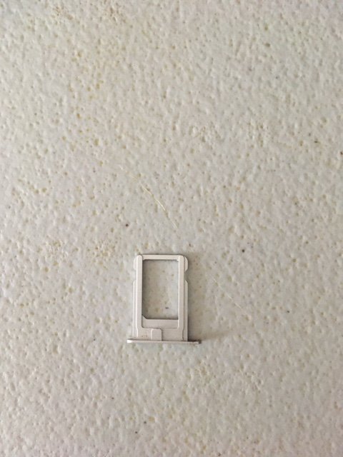

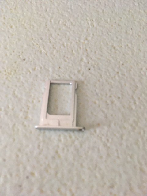

For some reason, the pictures got sent an hour later... I do not know why. But here are the pictures of it.
Well when i put the sim card into the sim card tray... assuming i just hold it like that... it is like in place. But let say i were to turn it over while not holding it... then it falls down. That is normal right? Like when you put the sim card into the sim tray... its like you putting a jigsaw puzzle in it... but if you were to turn it around or anything without holding it... it drops. That is normal right?
I do not know if im for sure inserting it correctly... but im just putting it in... along with the sim tray...
View attachment 1828914View attachment 1828915View attachment 1828916

I place the SIM card into the tray while holding it horizontally then orientate the phone so I can slide it into the slot without having to turn the tray if that makes sense. From the pics it looks like the tab is still slightly bent. Maybe laying it on a flat surface will help you determine when it's flat. It's also possible the card was damaged so if you have access to another phone you might try to install it and see if it works in a different device. It is also very possible the card reader may have been damaged from the drop or it's connector came loose, damage to the logic board solder joints is another possibility. I'd try the easy stuff like test the card in another device and if your technically inclined checking the connection of the reader inside the phone.. There are many YouTube videos showing tear downs of the SE
Well the way i put it in... i just hold it horizontally and then push it in. Yea the tab is still slightly bent... it looks like a bit of damage if you look at it closely. But wouldn't that have nothing to do with it though as long as it goes in?
Well i can still use the plier to unbend it. I was unbending it from both directions to make it straight. If you look at the iphone from the side, it looks like its fit in correctly... except the other end of it where its not completely flat because there is some damage to that area.
