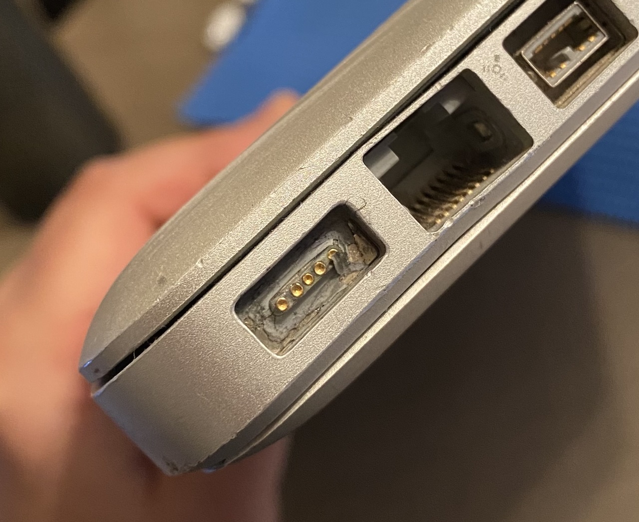

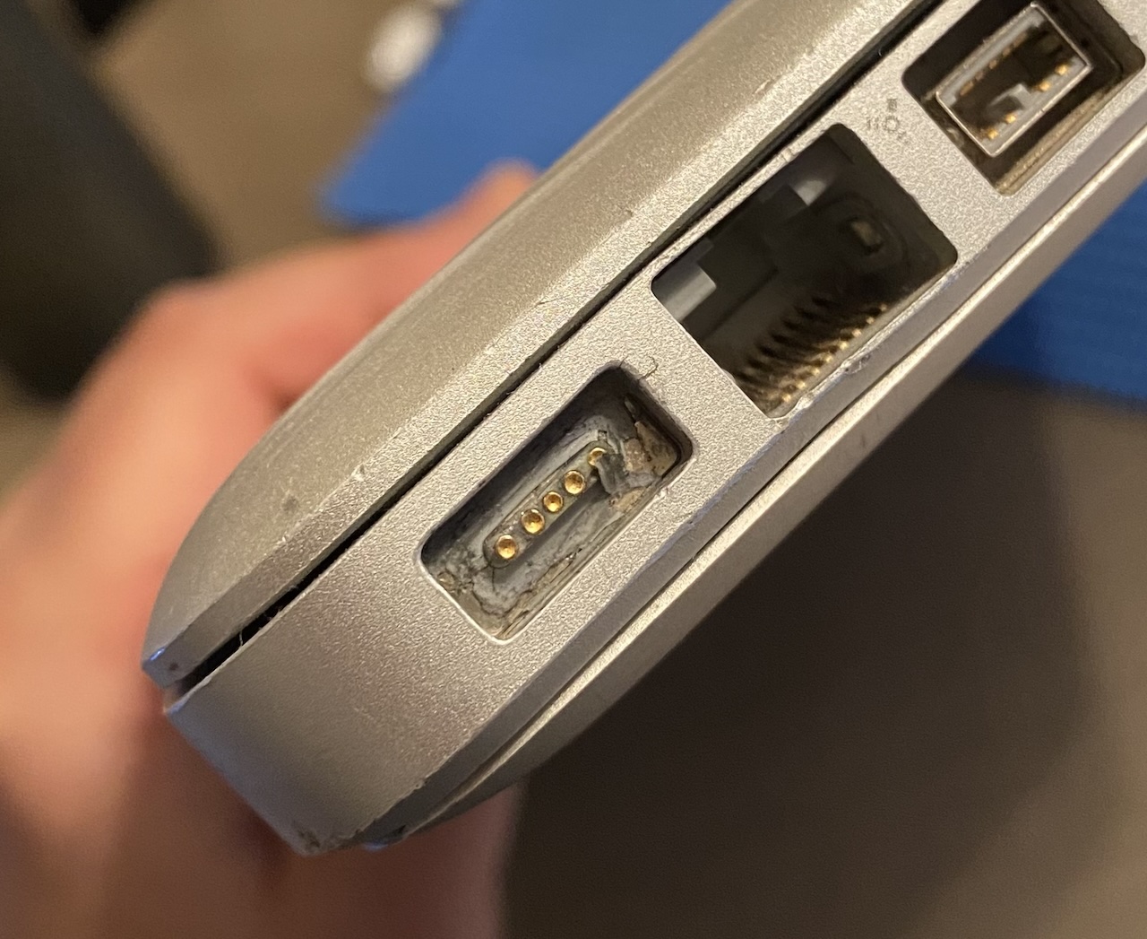

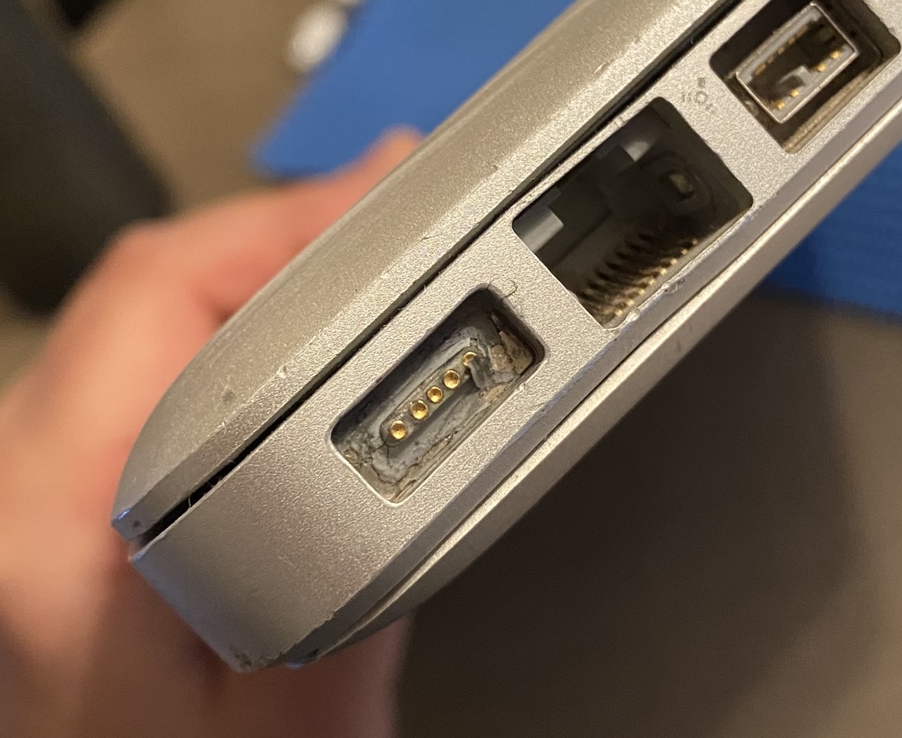

Here's the picture of the power port.

Does the light come on the charger at all? As someone noted above, there is paint covering one of the pins. Get that uncovered and clean up the port with 99% isopropyl alcohol on the end of a q tip. Also try an NVRAM and SMC reset. if that's a no go, then there's likely an issue with the port. Any decent repair shop should be able to take care of that for you.
yes. Clean first. But it also looks like the case is bend a bit and the plastic inside the port looks a bit molten, no? Hard to see.
And its a 1st gen MagSafe if you need a new power brick.
But i would not invest much in hardware that old
Looking at the pic, that connection port is a mess.
Clean it out thoroughly, and try again.
If that doesn't work, aren't these ports actually "replaceable" (with a new "DC in board", or something like that?).
Check ifixit.com.
But you need to know WHAT YEAR the MBP is.
