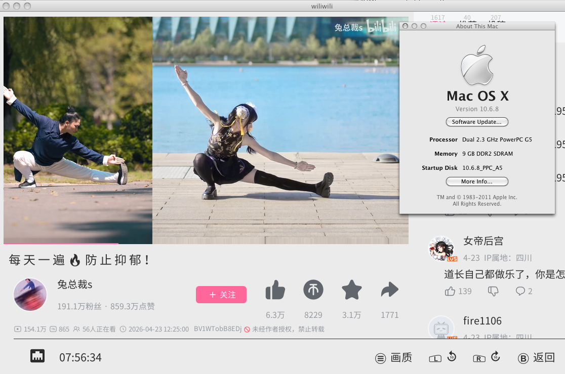

I gave ani-cli a try and it seems to work but the video plays slow as expected since it's using MPV but will try it with Mplayer to see if it works better.

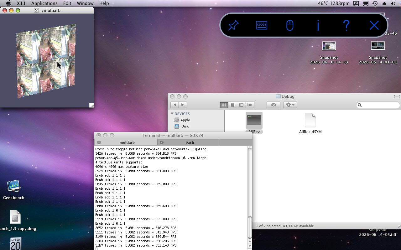

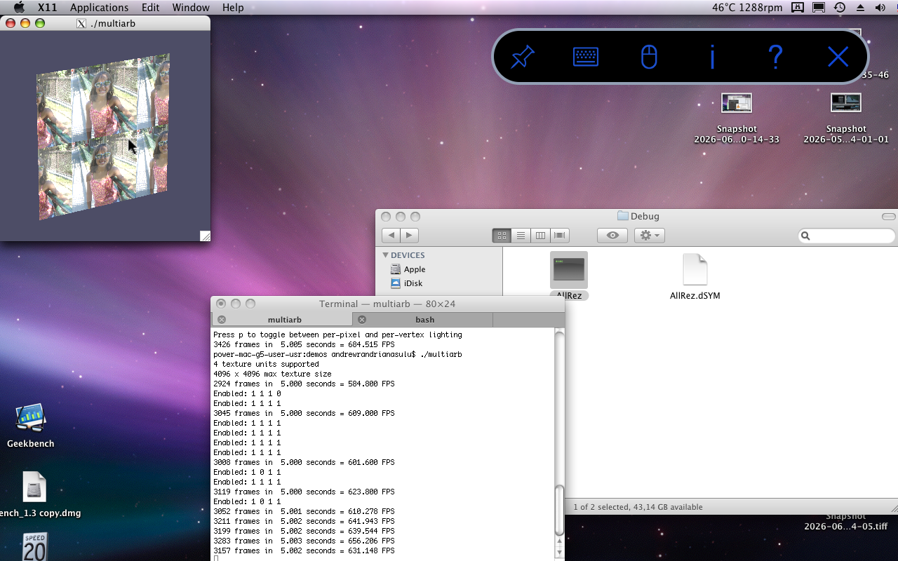

Not as cool as above, but I compiled mesa-demos 8.5.0 with freeglut from macports! (this enables a lot more demos, need X server). Many can print fps and pretend to be benchmark!
Code:
LDFLAGS=-L/opt/local/lib CPPFLAGS=-I/opt/local/include/ ./configure --enable-autotools --with-glut=/opt/local/lib/

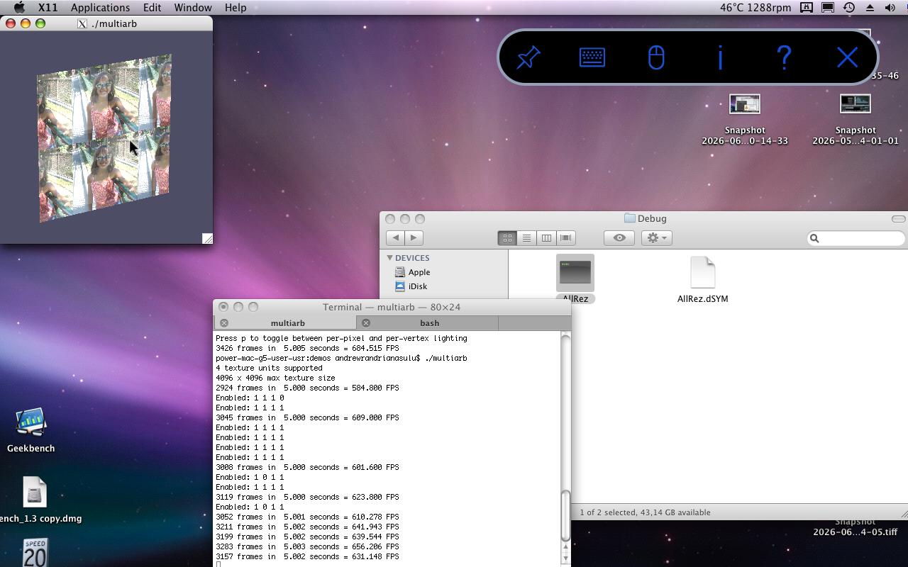

Code:
Which version of mesa is used btw?

A bit hard to say, because Mesa apparently only does glx part, actual OpenGL driver is hw accelerated proprietary Nvidia! Never saw this before, but may be Windows version of mesa can do this, too?
Code:
  otool -L ./src/demos/multiarb   ./src/demos/multiarb:
 /opt/local/lib/libglut.3.dylib (compatibility version 3.0.0, current version 3.13.0)
/opt/local/lib/libGLU.1.dylib (compatibility version 5.0.0, current version 5.1.0)
/opt/local/lib/libGL.1.dylib (compatibility version 4.0.0, current version 4.0.0)
/usr/lib/libSystem.B.dylib (compatibility version 1.0.0, current version 111.1.7)
 /usr/lib/libgcc_s.1.dylib (compatibility version 1.0.0, current version 1.0.0)
I assumed you know what mesa you have installed, but in any case:
Code:
port -v installed mesa
And if it is not sure which port provides a given library, then:
Code:
port provides /opt/local/lib/libGL.1.dylib
Code:
Code:
thanks, for me as relative novice to macports this kind of help is valuable (I use macports on my accidently hackintoshed laptop, but for now mostly in frozen-in-time mode)

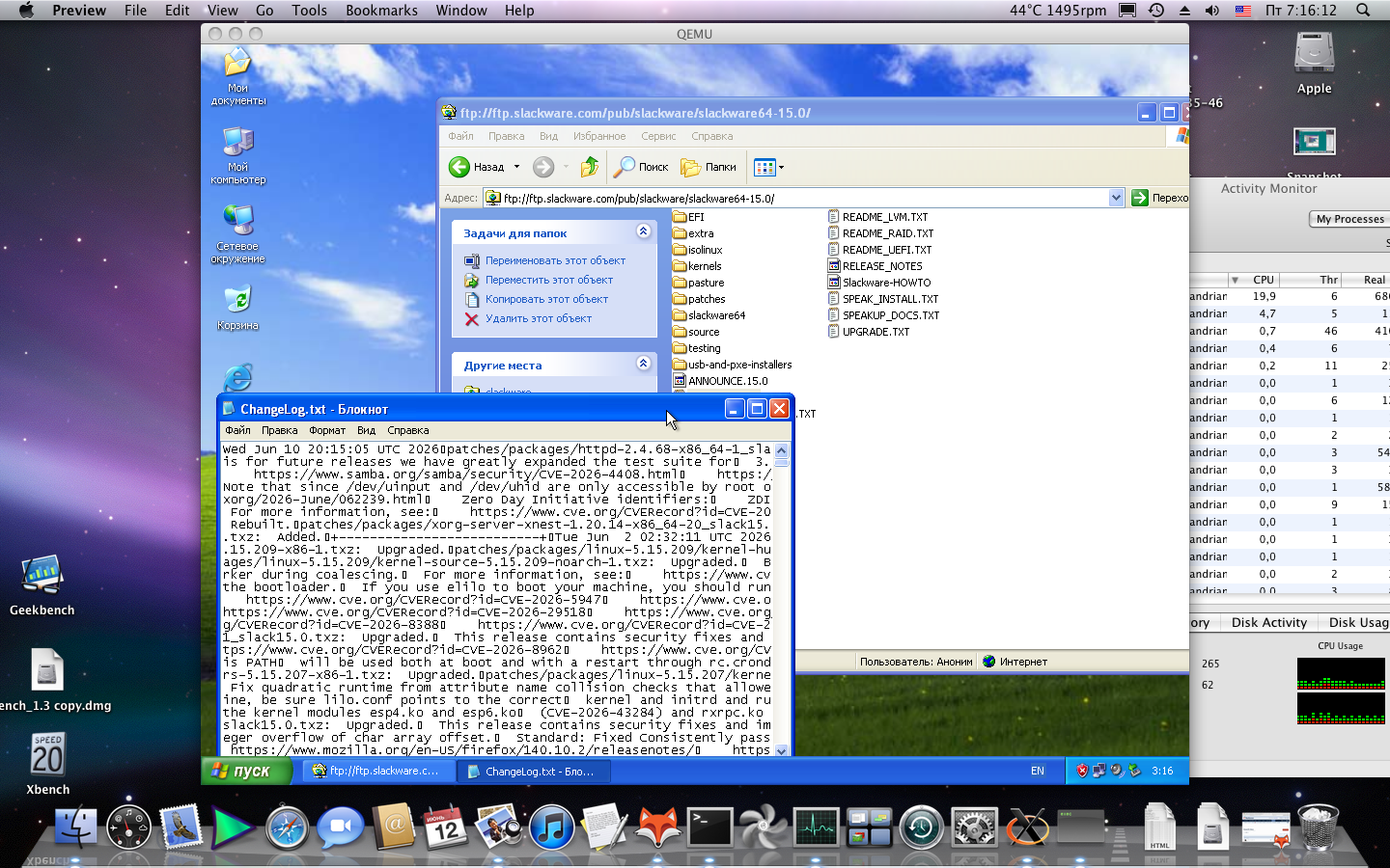

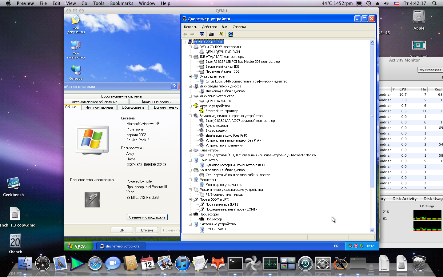

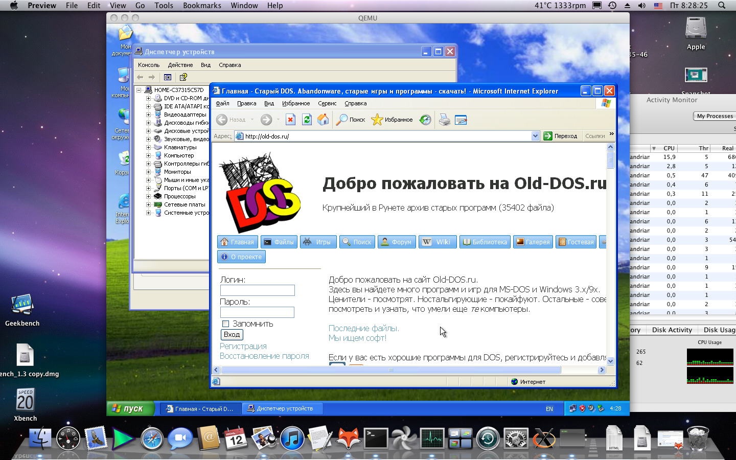

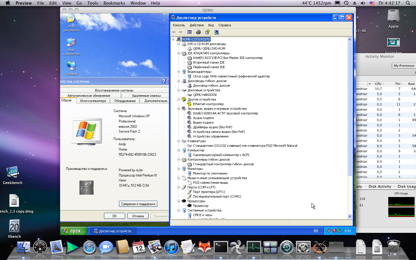

Tested QEMU emulator version 2.3.1 with pre-installed Windows XP 😛
Best line was
Code:
qemu-system-x86_64 -cpu pentium3 -m 512  -vga cirrus -hda VMs/2gb_xp-compressed.img -M pc-0.10 -soundhw ac97
Not sure if any usb (OHCI, UHCI) works normally here - I got some very long boot times if I add it
adding network card ne2k_pci seems to be more harmless, but not sure if it ever worked - Explorer crashed 😀

Edit: networks seems to work, too, just anything using mshtml, even just for text file from ftp crashes??
Code:
qemu-system-x86_64 -cpu pentium3 -m 512  -vga cirrus -hda VMs/2gb_xp-compressed.img -M pc-0.10 -soundhw ac97 -netdev user,id=myslirp -device rtl8139,netdev=myslirp -cdrom ~/win98/Windows_98_Second_Edition.ver.4.10.2222.Russian.iso

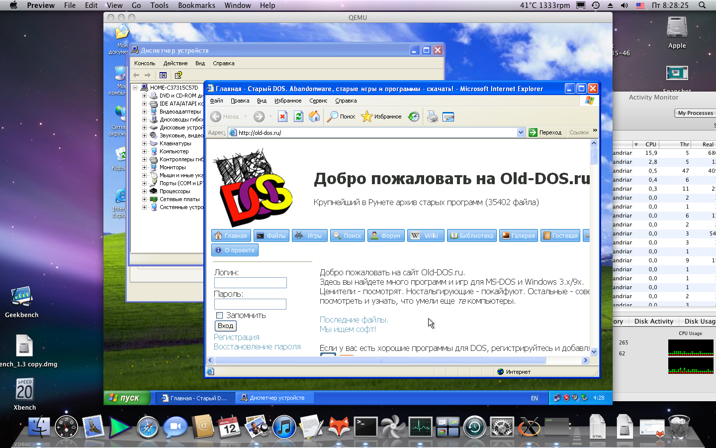

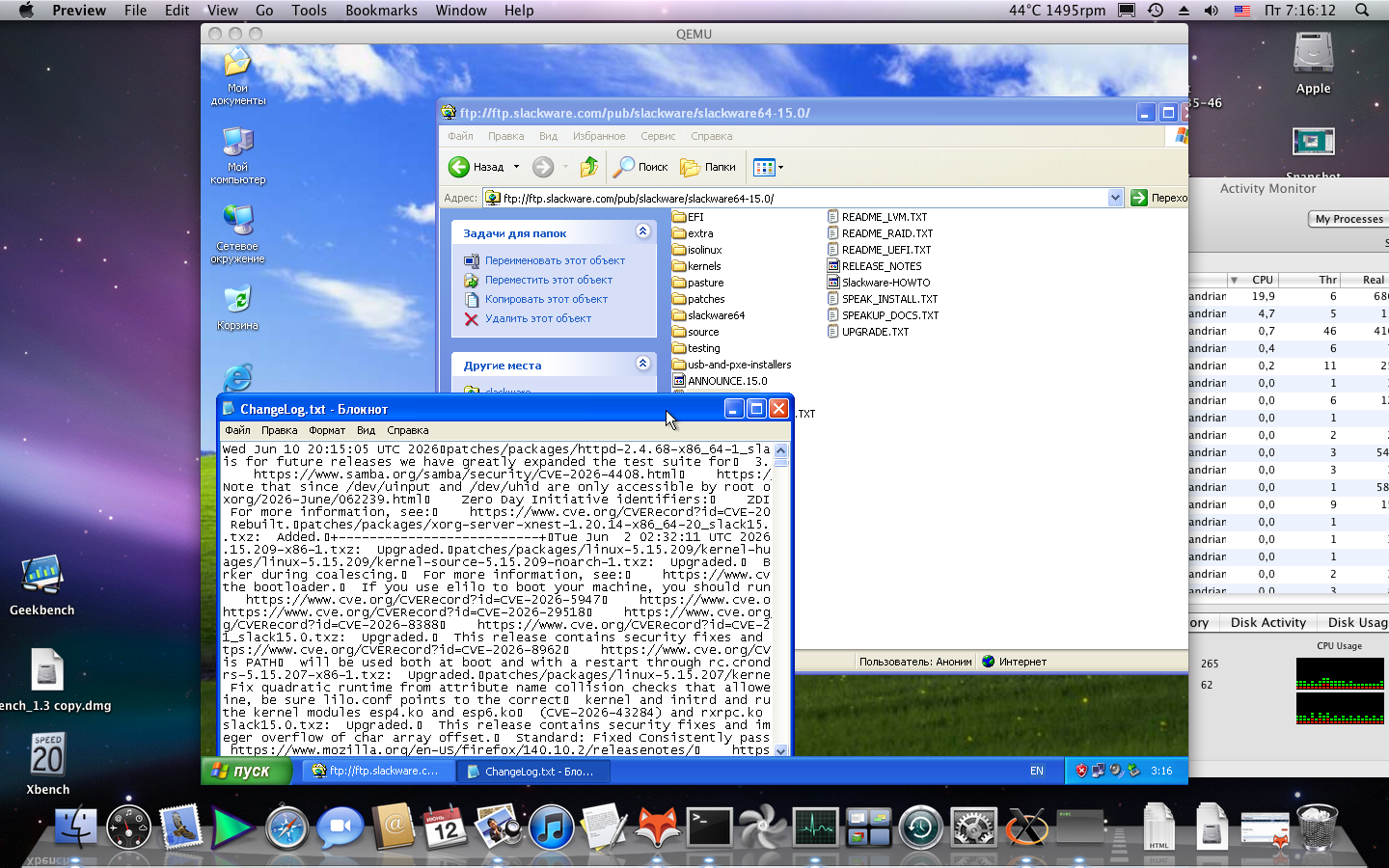

Edit 2: even stranger, my self-compiled qemu 2.2.0 does NOT have weird delay, plays direct music test, and iexplorer does not crash!
Code:
~/src/qemu2/qemu-2.2.0/i386-softmmu/qemu-system-i386 -cpu pentium3 -m 512  -vga cirrus -hda VMs/2gb_xp-compressed.img -M pc-0.10 -soundhw ac97 -netdev user,id=myslirp -device rtl8139,netdev=myslirp -cdrom ~/win98/Windows_98_Second_Edition.ver.4.10.2222.Russian.iso
May be 2.3.1 had regression, or just miscompiled ?
Best line was
Code:
Code:
You can check configure options in the port. The only patch added in 2.3.1 is a no-op for 10.5. What did change was a switch from Xcode gcc to modern one (required due to thread local storage need). This is 2.2.0 when it was initially added.
AFAICT, the port in effect uses unmodified upstream source on 10.5 (and on 10.6 falls back to 10.5 behavior in one code block). So if there are apparent regressions, those may be due to:
– actual regressions in upstream code;
– suboptimal configure args;
– usage of modern gcc over Apple one (can be relevant for ObjC code, in most cases fine).
You can try compiling 2.3.1 without the port (assuming you did it for 2.2.0, nothing much changed). If you get identical behavior with 2.3.1 from ports, it is either a bug in upstream code or regression brought about by gcc. If you get the outcome as with 2.2.0, then something is not quite right in the portfile (either from original port or from my update to it).

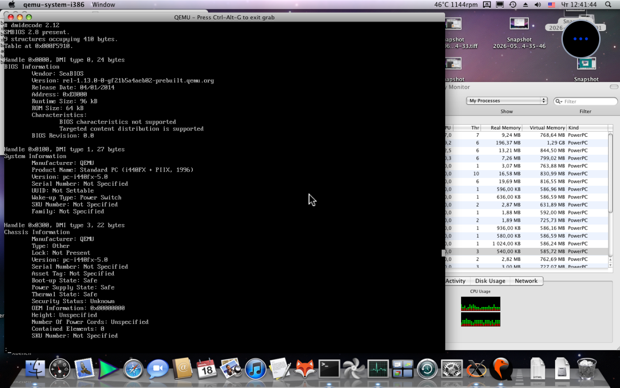

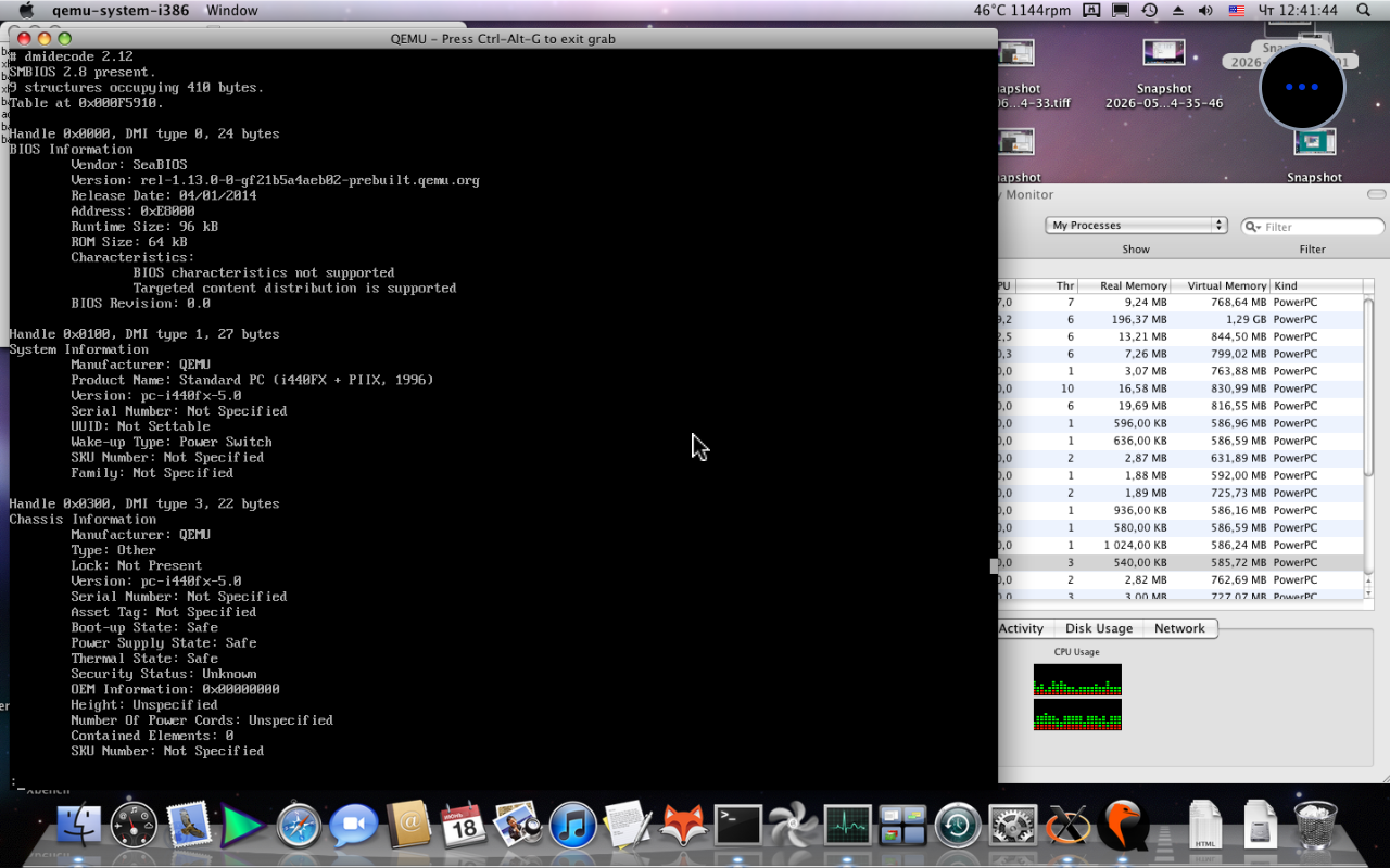

ok, on OSX side i386 part of qemu 5.0.0 works, but ppc side segfaults booting finnix 111 ??
Code:
export CXX=g++-mp-14
export CC=gcc-mp-14
./configure --target-list=ppc-softmmu,i386-softmmu --disable-gtk --python=/opt/local/bin/python3.12 --extra-cflags="-I/opt/local/include/LegacySupport/ -I/opt/local/include -I/opt/local/include/SDL" --disable-cocoa --extra-ldflags="-L/opt/local/lib/ -lMacportsLegacySupport"
plus there was some strangeness if SDL and APPLE defined, I if 0'ed it
qemu-5.0.0/softmmu/main.c
and set cacheline_size to 16 in
util/cacheinfo.c
because autodetect was failing.

Well, for me main problem for now is qemu-system-ppc 5.0.0 blowing up on OSX while working on Linux 😉 qemu 2.2/2.3 can't boot MACOS 9.2 or my Tiger install copied from PC. qemu 5.0.0 ppc starts macos 9.2.2 installer from cd, but after loading first extension it sits for a while using host cpu, and then nothing. Tiger install just explodes early. Linux never goes to pci device enumeration. So something is off, just not sure what exactly.
My self-compiled qemu-system-i386 2.3.1 also hang on booting windows xp (due to rcu.h/thread local storage it *needs* gcc 14 or at least something above Apple's gcc 4.2), so I suspect qemu codebase just sensitive to what compiler does .. I'll try with optimization level turned down, but outside of this I have no idea how to debug such bugs :/
wow, I turned down optimization level to O1, disabled fortify_sources in configure at the same line, disabled stack protector by configure switch and it worked!
Mouse kinda weird in gtk3 UI, but I am about co compile qemu 5.0. with SDL ui and see how it perform
