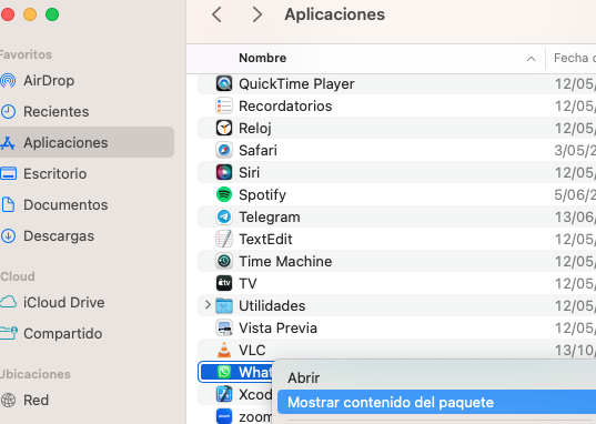

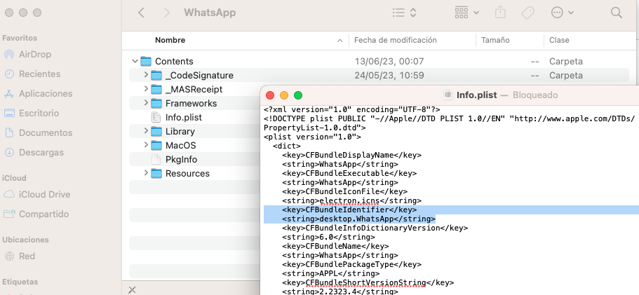

Hi, look carefully the name of the app in this file "Info.plist" for each app (Attached image), in my case WhatsApp name is: desktop.WhatsApp
