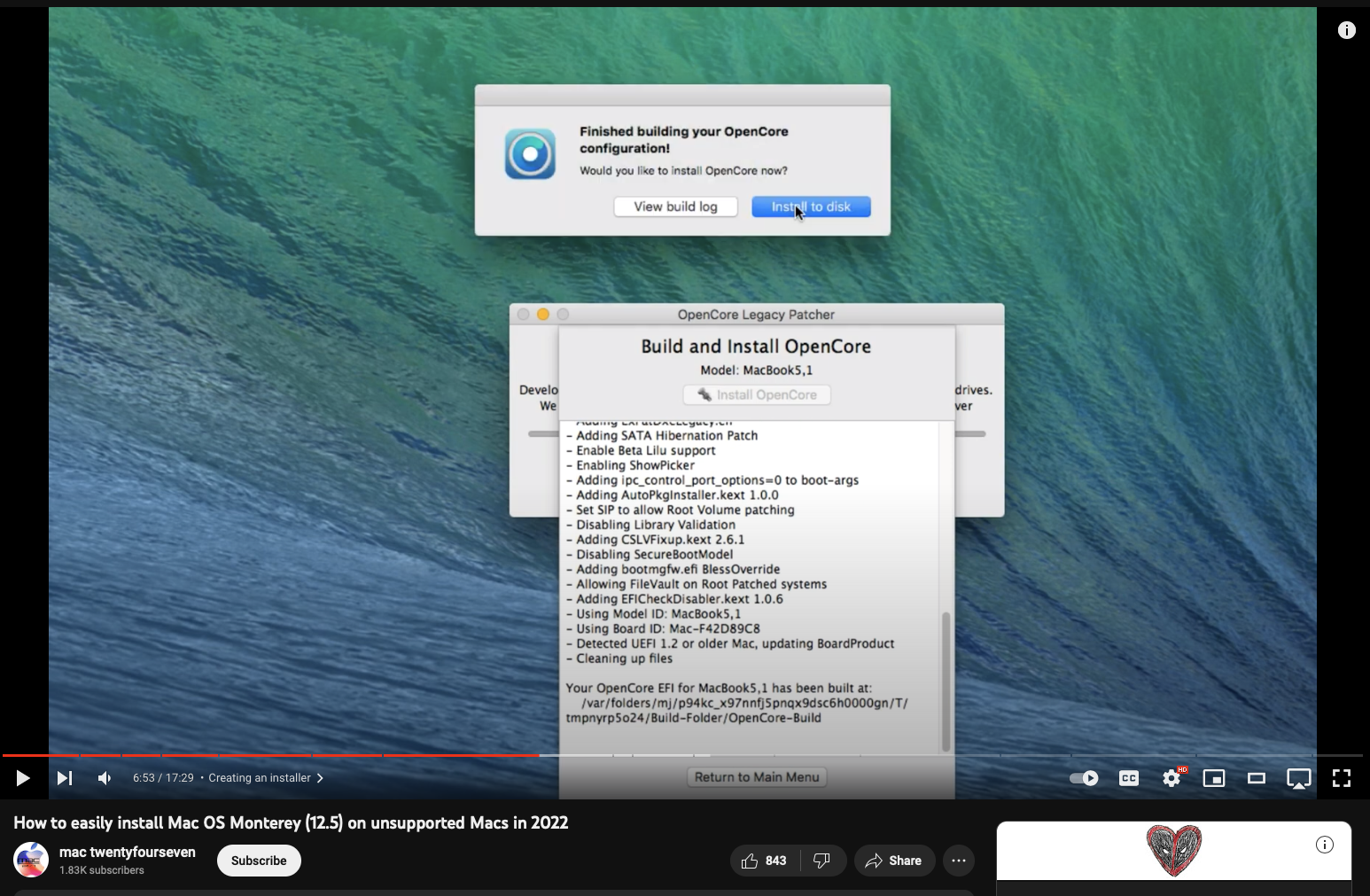

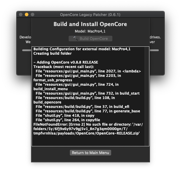

I'm currently using the OpenCore Legacy Patcher 0.6.1 so I can install monterey. I'm currently getting this message.
Following this Youtube Video for instructions. I'm not getting the message after stating "Finished building your opencore configuration". Any idea what I may be doing wrong? Everything else has worked until this step.

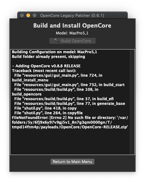

Did you change to 5,1 the first time, when it failed? Or did OCLP choose 5,1 automatically?
OCLP chose 5,1 automatically when it failed. I later switched it to 4,1 to see if it would work. But I'm still receiving this message below.
