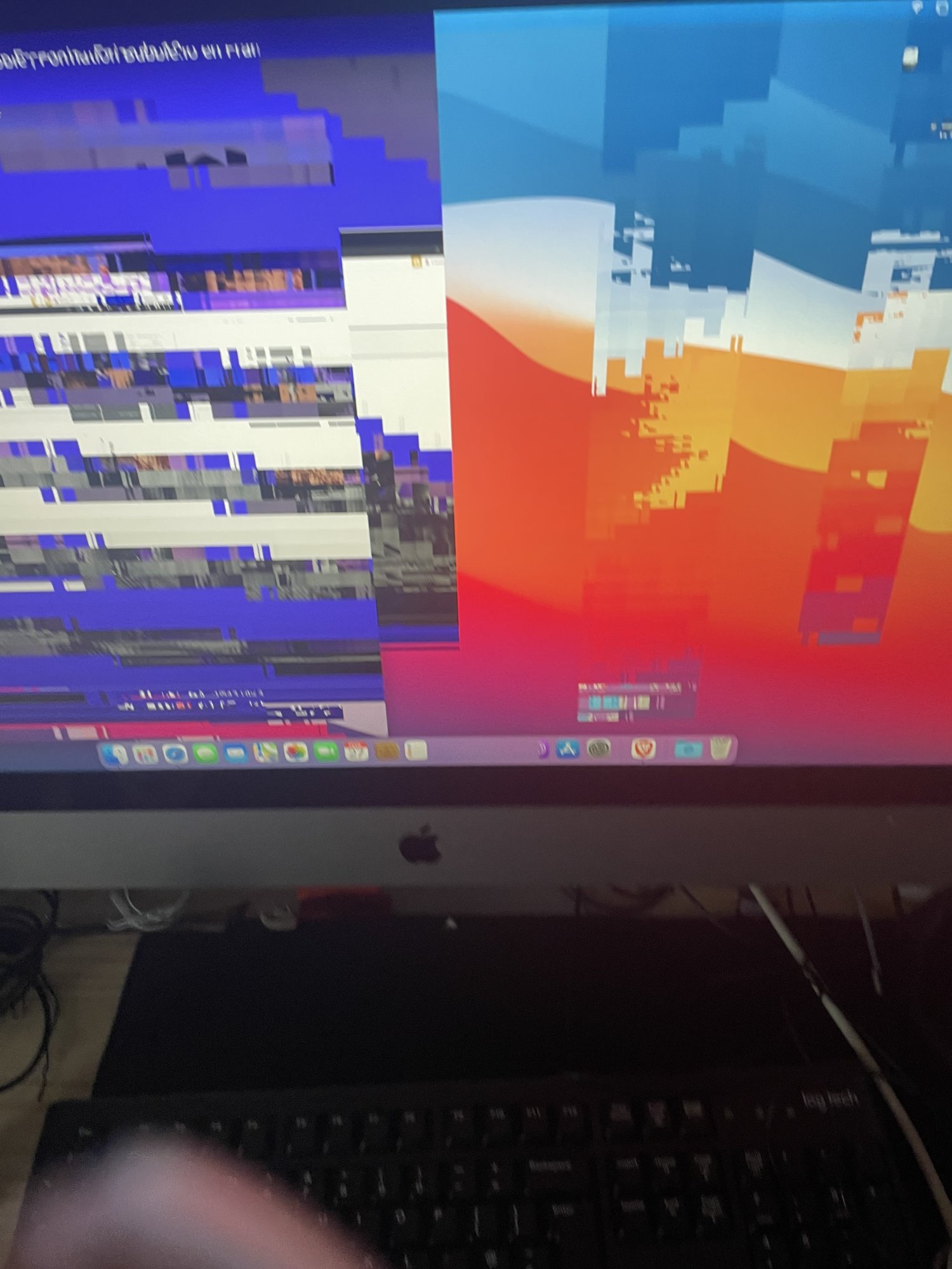

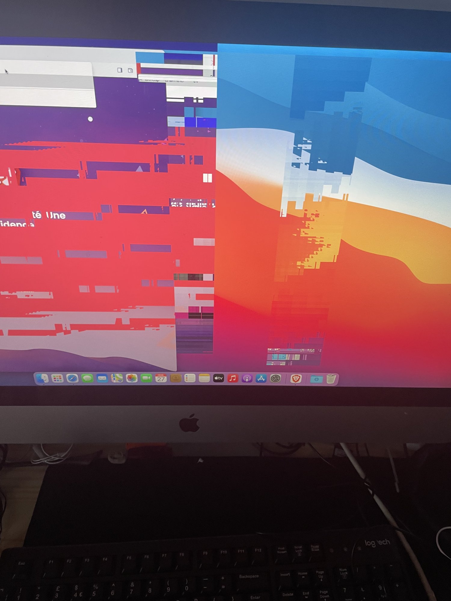

Hello all
I'm coming back to you because I have a problem.
I have a 2009 iMac
10,1"27" model
1To mechanical disk (replaced by a 500go ssd)
12go ram 1067
graphics card ATI Radeon HD 4670 256 Mo,
processor: 3.06 GHz Intel Core 2 Duo
I tried to install sonoma,ventura,monterey and big sur with open core Legacy last version 1.3 all installation goes correctly boot same post Install same but when I launch a YouTube video in full screen after a few minutes by switching back to window mode I get gliche (see images attached),
I tested my memory: Nickel test, tested my graphics card: nickel, tested my hard disk: not really in shape, but I changed it for an ssd, thinking that the problem could be nothing.
I said to myself that it could come from the fact that I created the key on a MacBook Pro M1
I then recreated the key with my iMac 2010 21".
same configuration except for the processor which is an I3
I finally managed to reinstall Catalina with dosdude1's patch
but I don't understand why with core Legacy nothing works, whereas on my mac 2010 sonoma runs perfectly.
I wonder if this isn't due to the 13.1 update.
you'll find the images of the famous glich if you have an idea I'll take it.
Sincerely
