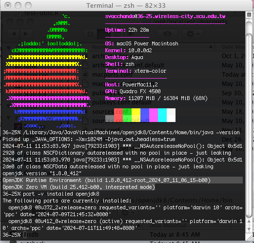

The latest release of JDK8 (2024).
There is a caveat, it is built as headless, so no GUI. But otherwise it appears working.
(Silly ObjC complaints are nothing PowerPC-specific and do not affect functionality, but I do not know how to get rid of them. Upstream apparently fixed them at some point, but used clangisms, so made it incompatible with gcc.)

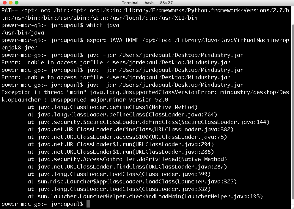

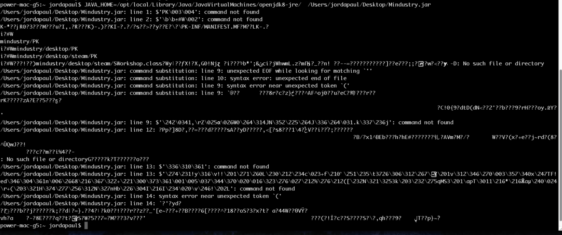

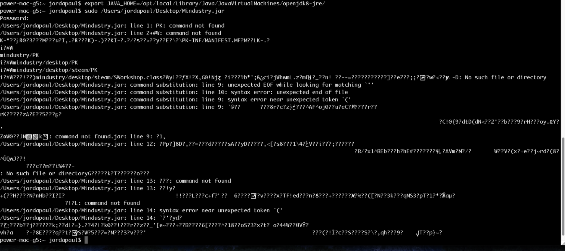

Hey,
There is a Java game that my friend introduced me, and i wanted to play it on my PPC G5
So i suceed to build OpenJDK8, but it wont work
The game is Mindustry (it's on github)
(this are the printscreen of what i tried to do)

I am not a Java developer and I have no idea what that executable is supposed to do – from the screenshot it appears that it does not find its own components rather than failing on JDK itself – however I would not expect any GUI-requiring stuff to work. I never tried to check what an error may look like, but as it is stated above, there is no X11 support in this build (or elsewhere in existence, AFAIK), and Cocoa is broken due to Apple leaving it that way. So unless your game can run in terminal, without X window, I am afraid, it cannot work. Until/unless someone finds time to fix JDK build system and, if that be needed, sources, so that X11 backend works on macOS.
P. S. I did confirm that my builds of OpenJDK are functional – with non-GUI software. (For example, building R with Java support and then using it to build R package which uses Java. I think `fop` also uses JDK when it generates some types of documentation, and that also works fine.)

The command and errors don't look right to me. Usually JARs are run with the java -jar command unless it's an applet, a servlet, or the developer didn't set a default class in the manifest.
Please try running the following commands from the Terminal:
Bash:
echo "PATH=" $PATH
which java
export JAVA_HOME=/opt/local/Library/Java/JavaVirtualMachine/openjdk8-jre/
java -jar /Users/jordepaul/Desktop/Mindustry.jar

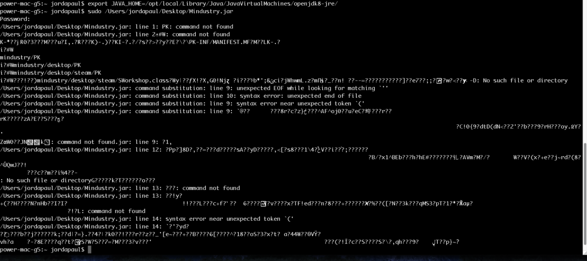

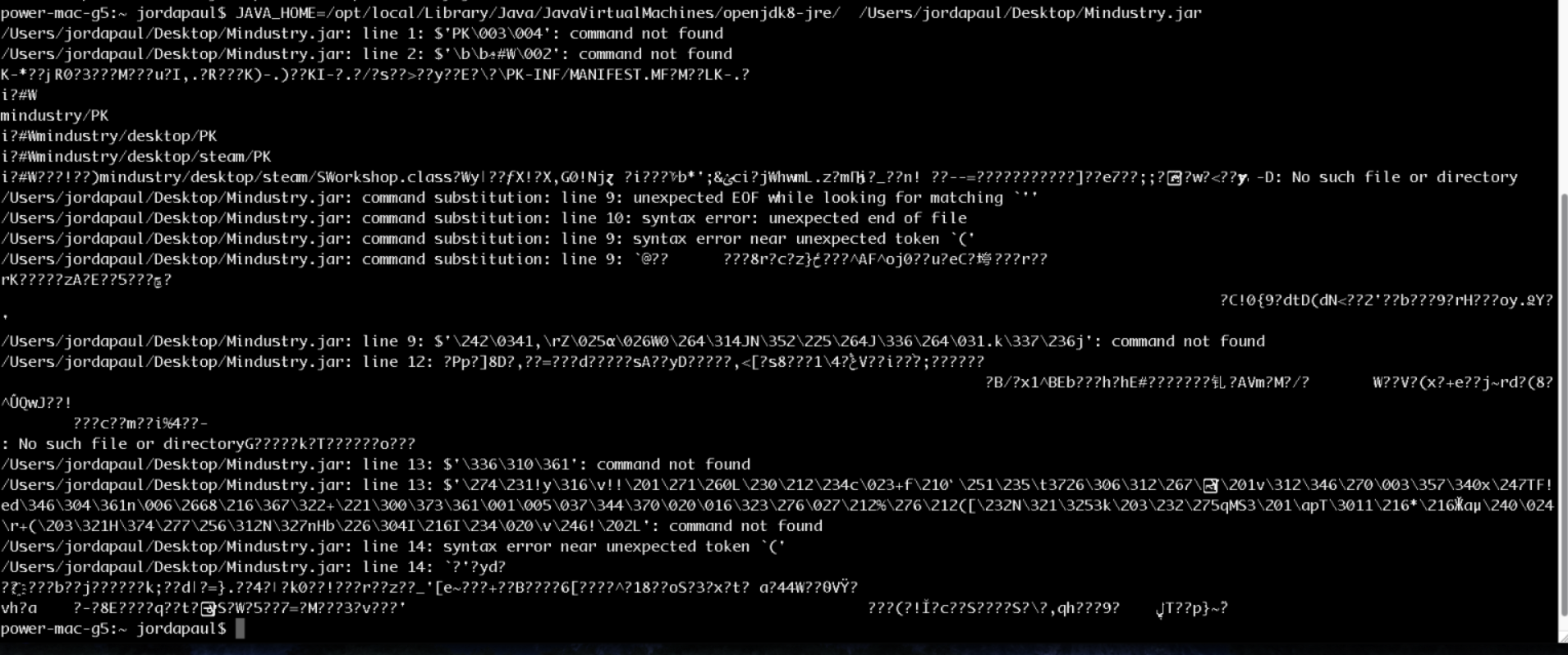

That looks more like Java. However, it seems to be now using the system's Java (/usr/bin/java) instead of OpenJDK8. From what I see, your path looks correct with /opt/local/bin being included before the system's directories, so I'm not sure why it is not finding OpenJDK8. @barracuda156 , by chance, does the OpenJDK8-PowerPC java command have a prefix or suffix added?
EDIT: On second thought, I think I may have just answered my own question - I just noticed in @barracuda156 's screenshot in the first post that OpenJDK's java binary seems to be stored in /Library/Java/JavaVirtualMachines/openjdk8/Contents/Home/bin/java on his machine, so it is likely that it will either be the same on your machine, or if not, then perhaps a similar location based on $JAVA_HOME. @Gamerabbit , please try running the following in the terminal, which should hopefully either provide the location of OpenJDK8's java command or run the program if it is in the same path as @barracuda156 's which is likely the case:
Bash:
ls -ld /opt/local/Library/Java/JavaVirtualMachine/openjdk8-jre/Contents/Home/bin/j*
ls -ld /opt/local/Library/Java/JavaVirtualMachine/openjdk8-jre/bin/j*
/Library/Java/JavaVirtualMachines/openjdk8/Contents/Home/bin/java -jar /Users/jordapaul/Desktop/Mindustry.jar
By the way, the error message you are seeing is that the JAR needs JDK 52 to run, which corresponds to Java 1.8. So, it is likely that OpenJDK8 should work as long as the game does not require anything that may not be supported in the headless build (it may also be possible to recompile the game for an earlier version of Java, depending on the source, since java often will just default to compiling it to the JVM version that's installed regardless of whether the code may be compatible with an older version).

It is easy to check what files a port installs with
Code:
port contents openjdk8-powerpc
The port file also has a note regarding paths:
Code:
% port notes openjdk8-powerpc
--->  openjdk8-powerpc has the following notes:
  If you want to make openjdk8-powerpc the default JDK, add this to shell profile:
  export JAVA_HOME=/opt/local/Library/Java/JavaVirtualMachines/openjdk8/Contents/Home
  If you want to make the JRE installed by the openjdk8 the default JRE, add this to shell profile:
  export JAVA_HOME=/opt/local/Library/Java/JavaVirtualMachines/openjdk8-jre/Contents/Home
There should also be a symlink from the real install location inside MacPorts prefix to the standard one outside, it is done here: https://github.com/macports/macport...c56f/java/openjdk8-powerpc/Portfile#L288-L289
