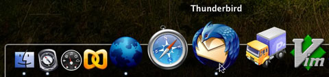

Stumbled upon this. If anyone wants to try it, this may help. Type this into terminal to get the 2D dock at the bottom of the screen:
defaults write com.apple.dock no-glass -boolean YES
killall Dock
NO at the end restores it. Those who want to fiddle with the system, /Library/CoreServices/Finder.app -> show contents and then somewhere you'll find PNGs to customize your dock :)
