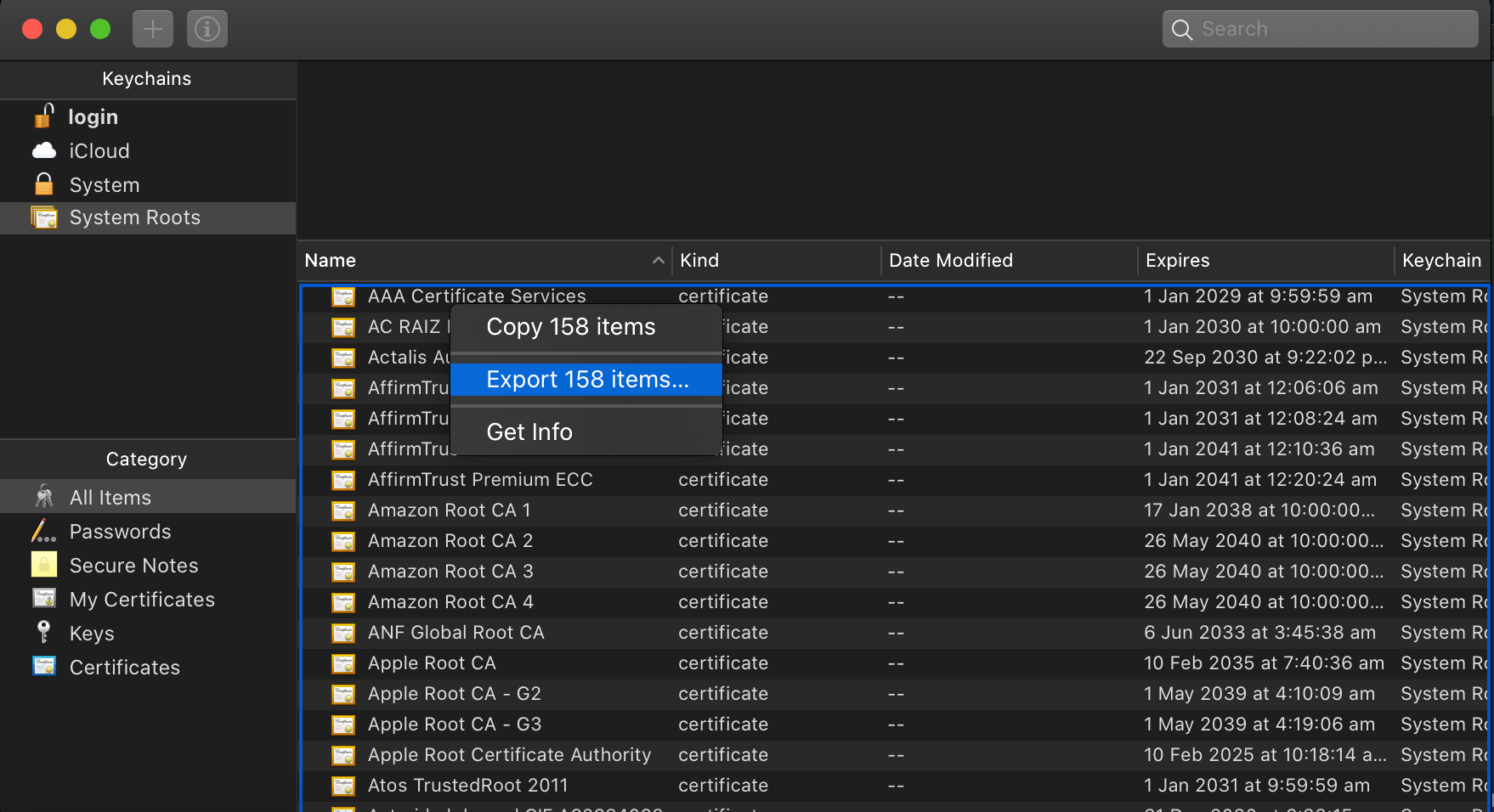

Go to your more recent Mac:
6. On your more recent system, open Keychain Access.app (/Applications/Utilities/)

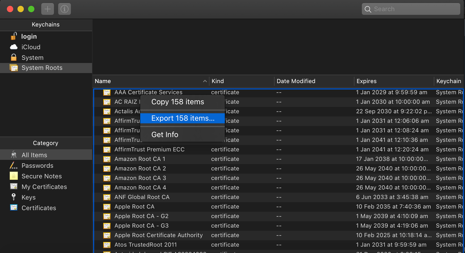

7. Click System Roots in left pane
8. Click into Certificates pane and Select All (Cmd-A)
9. Right-click and Export X Items (or File > Export...)
10. Save as `catalina-rootkeys.pem` (or similar)

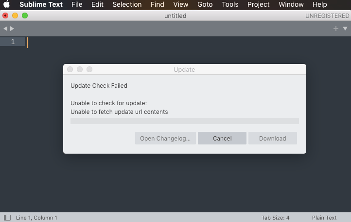

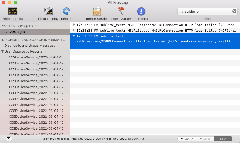

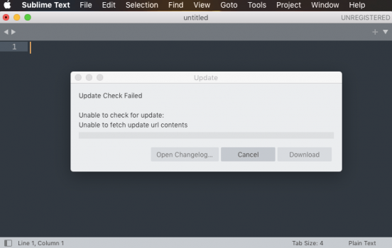

Example of an error caused by the expired System Root certificates (Sublime Text shown) on OS X El Capitan.
NSURLSession/NSURLConnection HTTP load failed (kCFStreamErrorDomainSSL, -9814) error exceptions logged in Console.app
Keychain Access.app on a more recent OS (macOS Catalina 10.15.7 shown)

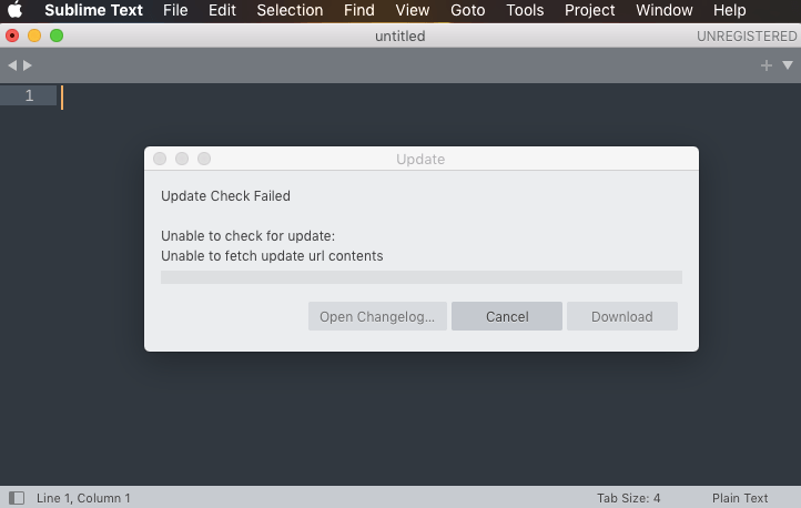

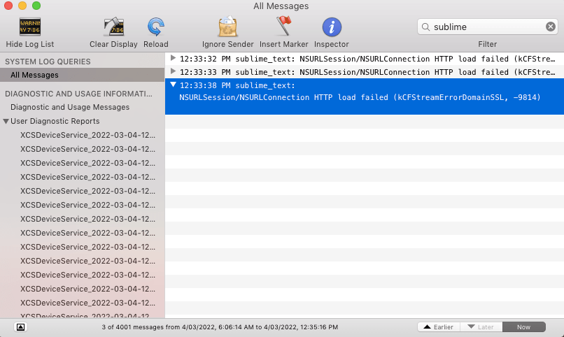

In El Capitan, I am seeing some apps not connecting to servers due to outdated / expired SSL Certificates. This has been seen in Safari and when attempting to update select apps - Sublime Text and VSCodium in my experience.
This issue can be resolved by upgrading the System Roots certificates in Keychain Access.app, which will require access to a more recent Mac system (macOS Catalina 10.15.7 in my usage).
1. Terminal: Install the MacPorts script and bundle; `sudo port install apple-pki-bundle coreutils`
2. Terminal: Backup your existing System Keychain: `sudo cp /Library/Keychains/System.keychain /Library/Keychains/SystemElCap.keychain`
3. Terminal: Edit the pem install script to enable usage:`sudo vi /opt/local/share/apple-pki-bundle/bin/pems_add_to_macOS_System_Keychain.sh` (or pico, if preferred)
4. Terminal: At line 6, change: `if false; then` to `if true; then` and save.
_____
(Optional to install the pem keys included in this bundle)
5. Terminal: `sudo /opt/local/share/apple-pki-bundle/bin/pems_add_to_macOS_System_Keychain.sh /opt/local/share/apple-pki-bundle/apple-pki-bundle.pem`
_____
_____
Back on your El Capitan Mac:
11. Copy the saved pem key bundle to your El Capitan Mac. (copy into Home > Downloads or similar)
12. Terminal:`sudo /opt/local/share/apple-pki-bundle/bin/pems_add_to_macOS_System_Keychain.sh /Users/<username>/Downloads/catalina-rootkeys.pem` (replace `<username>` as needed)
13. Launch Keychain Access.app to verify installation OK.
You should now see no more expired dates in the System Roots certificates list. If there are expired certs, you'll need to repeat again from a more recent OS (Big Sur or later).

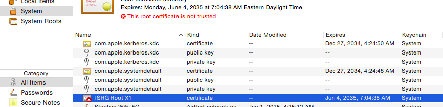

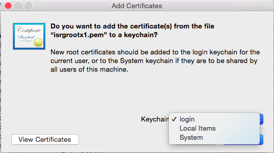

Hi, are you sure you installed the updated certificate? I've tested this on my systems going back to Snow Leopard 10.6. Here's Yosemite which you specifically mentioned:
These screenshots should help, you just have to follow them in the order I've provided. You will be prompted a couple times to update the Keychain, which I've shown below.

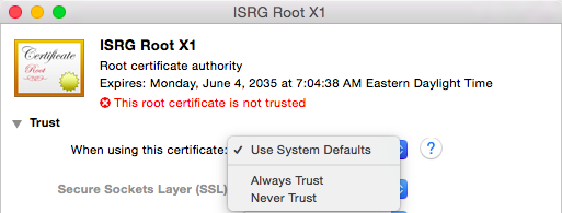

Once you've downloaded the isrgrootx1.pem, double-click on it. Then,
1) Change from "login" to "System":
2) If you have a password you will be prompted to authenticate. If not proceed to Step 3.

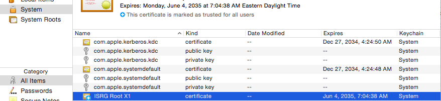

3) Navigate to "System" in the far left bar and double-click on the certificate with the "X":
4) In the window that opens, click on the dropdown for "Trust" and select "Always Trust":
5) If you have a password you will be prompted to authenticate again. If not proceed to Step 6.
6) Once you've done this, you will see blue X. You can now quit Keychain.

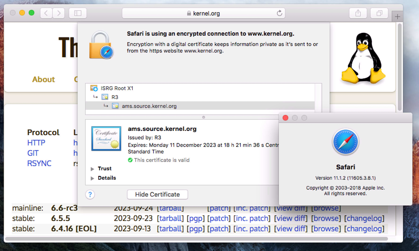

aonez
macrumors newbie
Jan 30, 2018
15
15
Hi, are you sure you installed the updated certificate?...

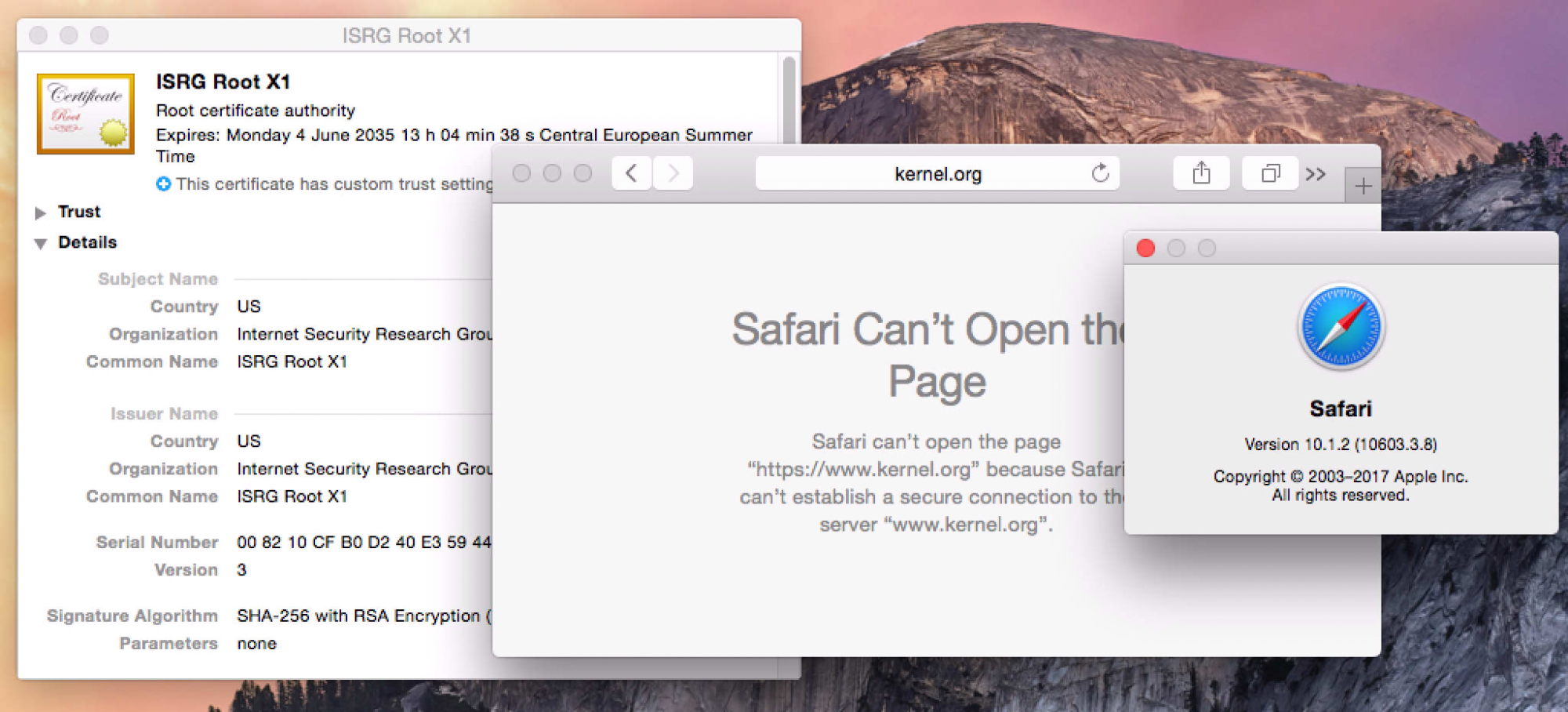

Thanks a lot for your reply sdfox7 and sorry, I should have been more descriptive. I've used the method to export and import the Keychain certificates from an updated version of macOS, did not used the downloaded pem file.
Anyway the result appears to be the same, since updated versions of macOS have those valid certificates and they were properly imported, specially the "ISRG Root X1". Safari works, I can browse almost any https without issue but one address I needed (https://www.kernel.org/) is not working.
The same procedure worked on Mac OS X 10.11, and since it was enough for me I did not investigated more.
Working on Mac OS X 10.11:

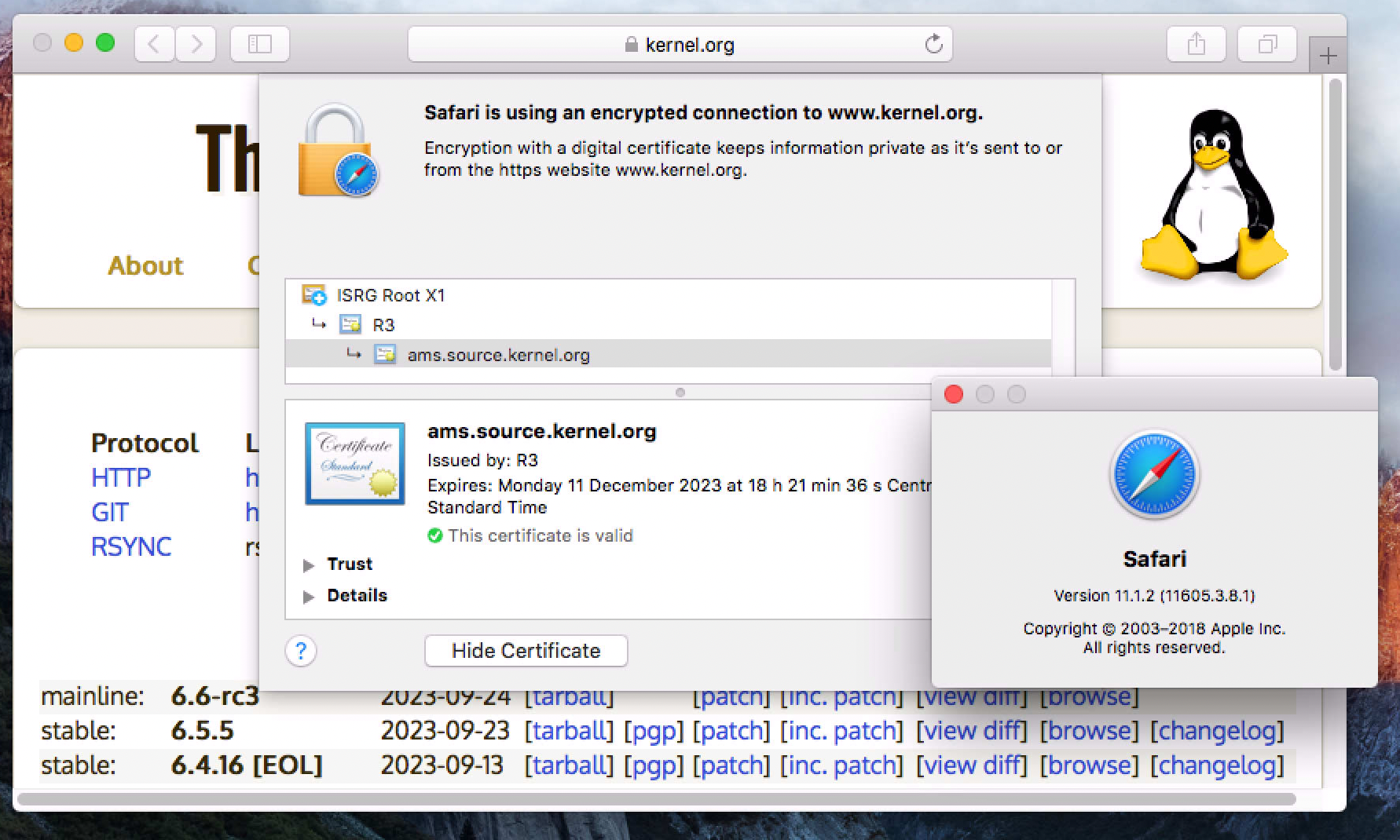

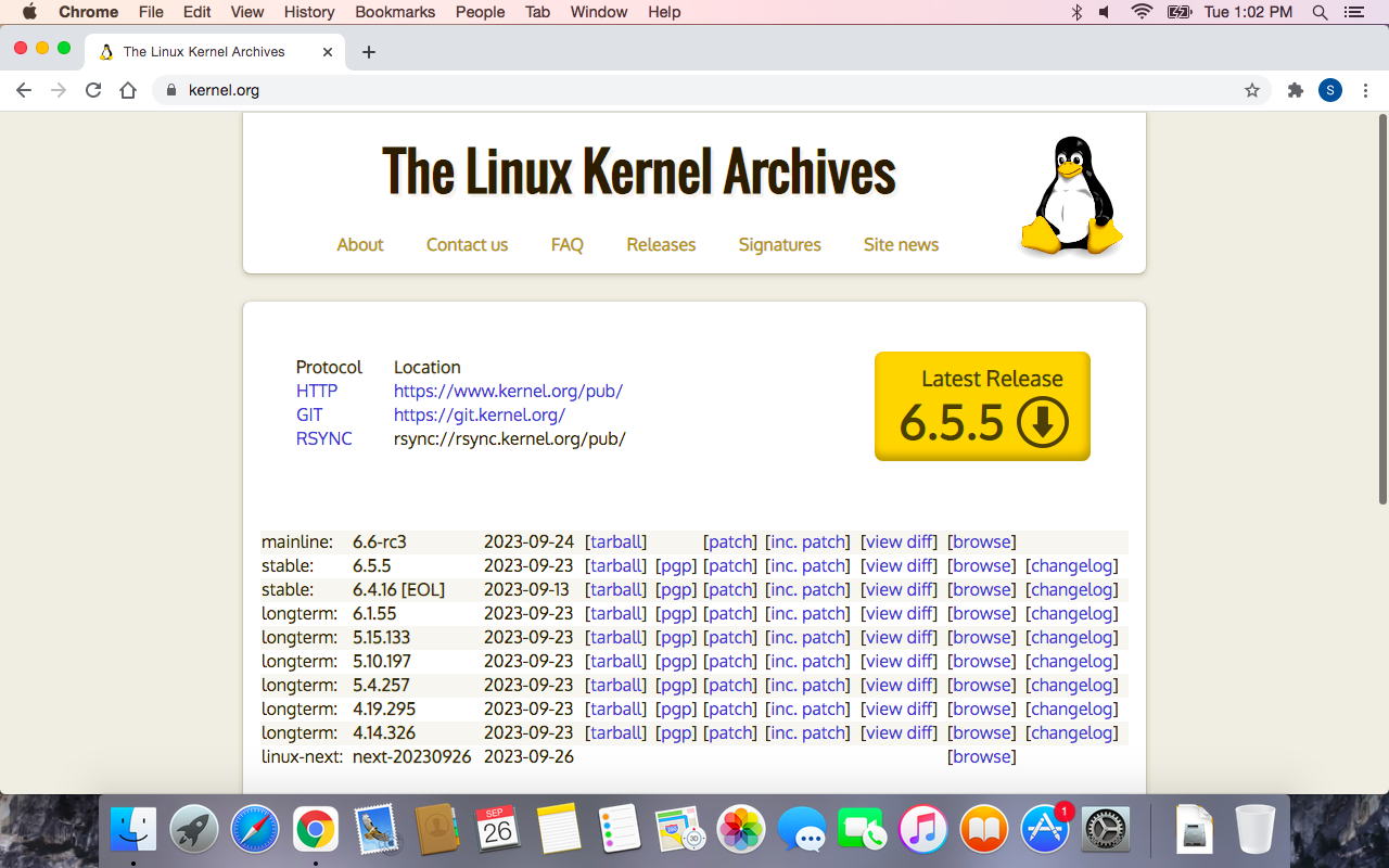

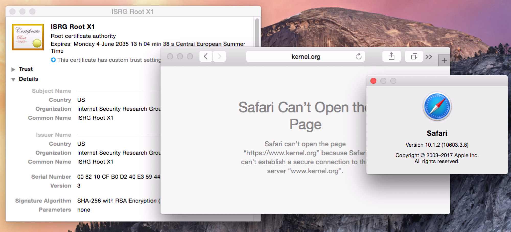

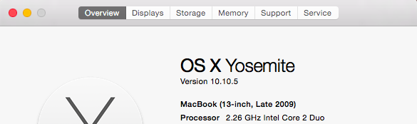

Same certificate, not working on Mac OS X 10.10. Trusted for all cases:
sdfox7
Contributor
Jan 30, 2022
261
158
USA
Safari 10 is too old for most websites. Google would probably work though, it even works in my old Windows 95 with Internet Explorer 3.02!
aonez
macrumors newbie
Jan 30, 2018
15
15
To be fair I was trying to install some packages using brew, so really just used Safari to show you the issue.

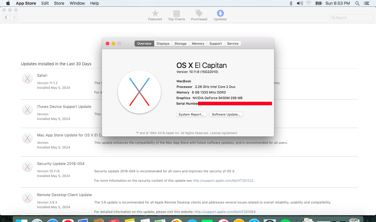

I followed up your post and now App Store shows up this error:
Can you please be more specific? Which OS are you running? 10.13? This thread hasn't been posted to in almost a year.
You can probably correct the issue by confirming you have the latest updates installed.
El Capitan 10.11.6 (download the combo update, install, and then do the rest of the updates through App Store):
https://support.apple.com/en-us/106389
Sierra 10.12.6: https://support.apple.com/en-us/106425
High Sierra 10.13.6: https://support.apple.com/en-us/106398
sdfox7
Contributor
Jan 30, 2022
261
158
USA
PS El Capitan 10.11 updates perfectly in the App Store as of today, so if you are running that or anything older/newer you need to install the combo updates above, and make sure you have the updated ISRG Root X1 certificates file (right-click to download): isrgrootx1.pem
