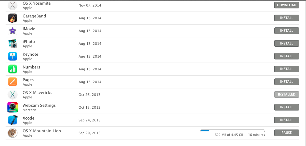

Unfortunately I can't re-download Mavericks. It says installed (from within Mavericks):

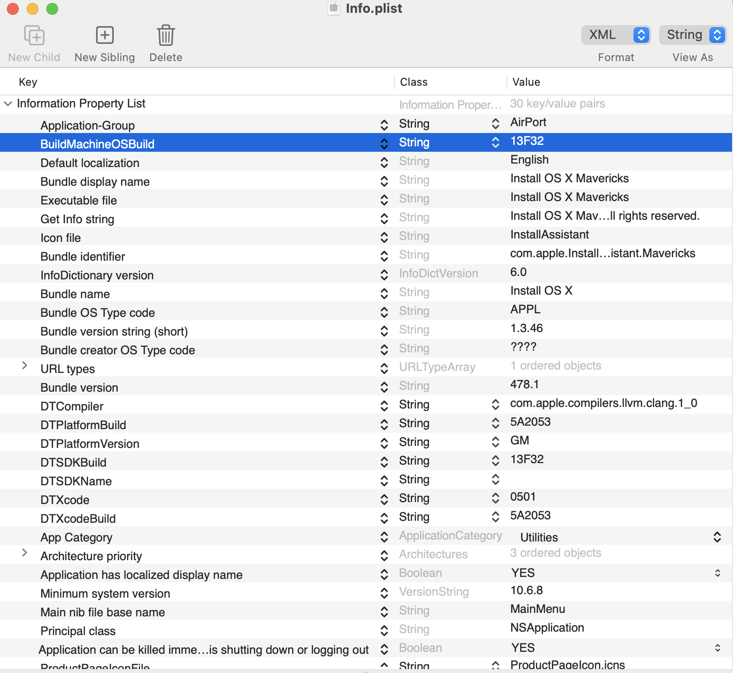

In the plist it says 13F32

the buildmachineosbuild is the machine that the installer app itself was built on. 13f32 is likely some internal apple build. I saw the same thing on my version.
The build version of anything downloaded post 2016 should be 13f34. So it's not clear why there are several different checksum for InstallESD even when downloaded from apple. I think maybe as that GH post mentions "container checksums" vs file checksums might explain it?
