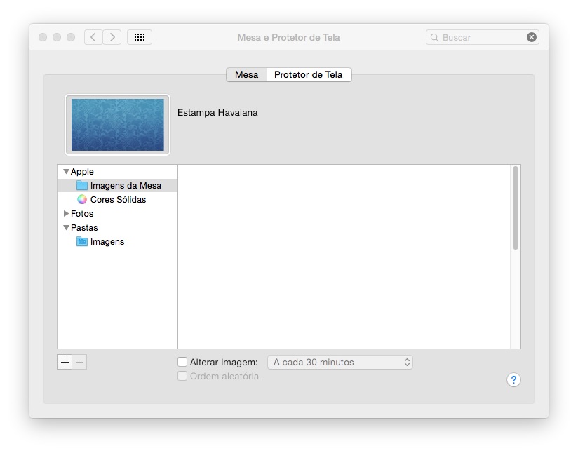

Hi there. Does anyone have this issue? I can't see the images but I can change them.
I've tried to disable "transparency" (Accessibility menu) but no success.
