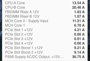

Hi again, luxmark crashes when i open it, i mean the app crashes, if i quit the option GPU then the app pauses and i can select CPU and the app continues the benchmark or the stress, but with GPU the app crashes.
With furmark, the whole system crashes when i put a res bigger than 1440, with 1200 the system still on, but with 1440 and no full screen, the system hold on about 20seconds.
and these are the current values:
The GPU clearly pulling too much.
Slot 1 - 4.21A x 12V ~ 50W
Boost 1 - 9.21A x 12V ~ 110W
Boost 2 - 9.14A x12V ~ 110W
The card actually pulling 270W, and that's not the peak yet. If the 3,1 has similar characteristic as the 4,1 and 5,1. The mini 6 pin can only deliver up to 120W (official limit - 75W), 110W is already very close to the real world limit, it's a sign that your GPU may occasionally pulling too much from the mini 6pin and crash your Mac.
Luxmark crash may also means that your card produce error when using OpenCL. You may try Luxmark 2 (if you only try Luxmark 3), CompuBenchCL, and OpenCL_NBody_Simulation to check if your Mac always crash when running OpenCL by the GPU.

Thank you h! Do you think that the Wattage problem could be from this card or maybe with all the GTX570?
GTX570's TDP is 219W from Nvidia website. So, your card clearly pulling way more than that (>20%). May be it's a OCed after market card. Also, when the thermal paste dried up, or the heat sink is dusty (old card). The ineffective cooling will also make the card pull more (the hotter they are, the more they pull).
To be honest, the power consumption doesn't looks like coming from a dual 6pin card. 110W is a 8pin figure.

i noticed that with only 1 screen connected, the Current decreases a lot, about 2A less.
can be this the point?
That's normal for some AMD card. When multi screen connected, the GPU will idle at a much higher clock speed, that makes the idle power consumption much higher than with only one monitor connected.
For example, my 7950 idle at about 15W with one (or no) display connected. If 2 or more displays connected, the idle consumption is about 50W. That >200% increase.
