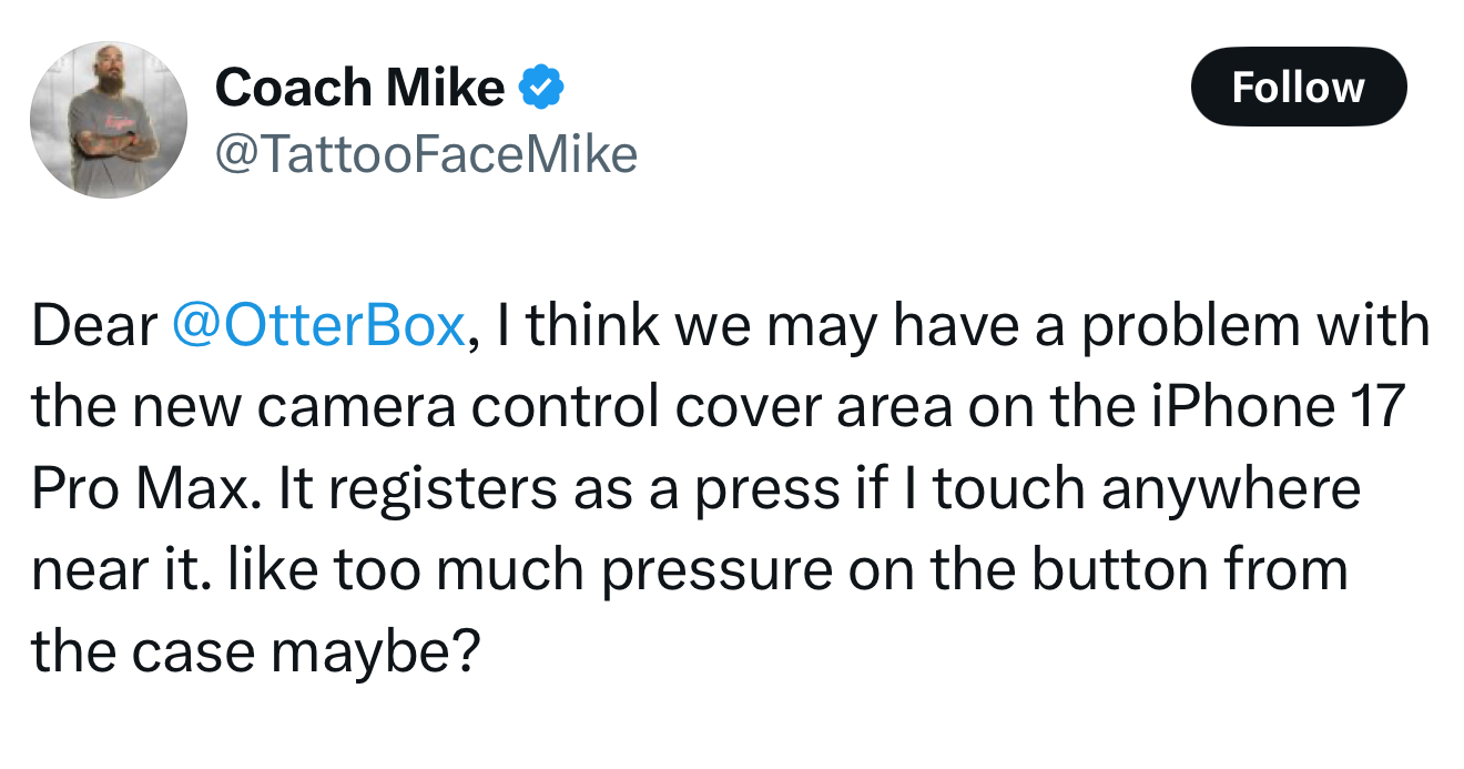

As the title says, beware of buying an OtterBox Defender Pro for the iPhone 17 Pro Max. I think I can confirm they made the case using dimensions and not a real iPhone.
As soon as I received my Pro Max today, I put it in the case and noticed something was off. It feels a little bigger than the phone. On the right side, near the Camera Control button, it doesn’t make a proper click and feels loose. If I press slightly above it, the Camera Control activates even though I didn’t press the button. I can even see the orange color showing at the top corner of my phone near the Dynamic Island. Something is definitely wrong.
I wasn’t sure if it was just mine, so I went to Best Buy and bought two more. Guess what? They all had the same problem.
I emailed them about it. Let’s see what happens.
More and more people are confirming the problem. Hopefully OtterBox fixes this soon. It’s incredible that the entire first batch has this design flaw.

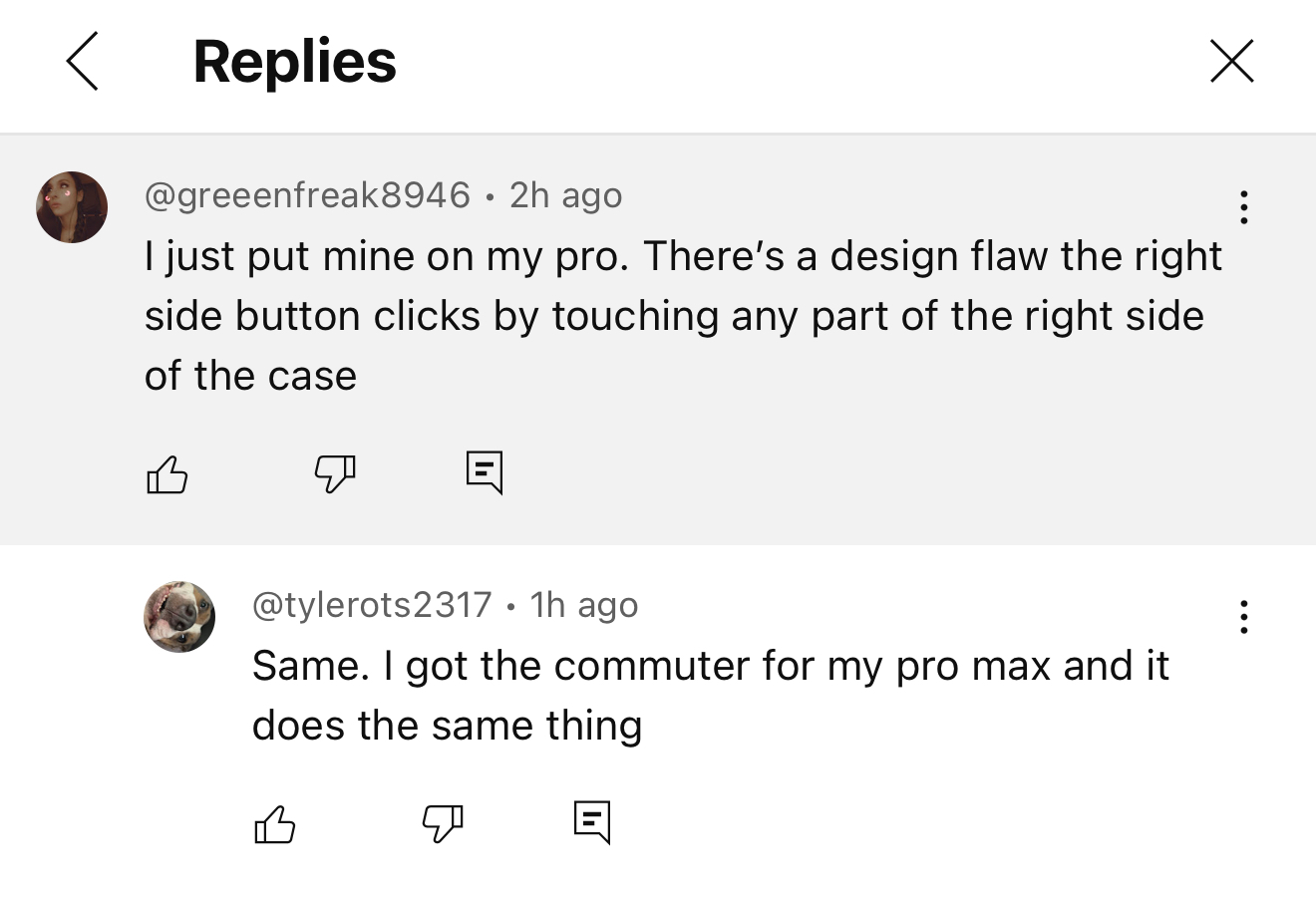

I came here looking to see if it was just my case. Same issue on my 17 pro max and plan on returning it.
