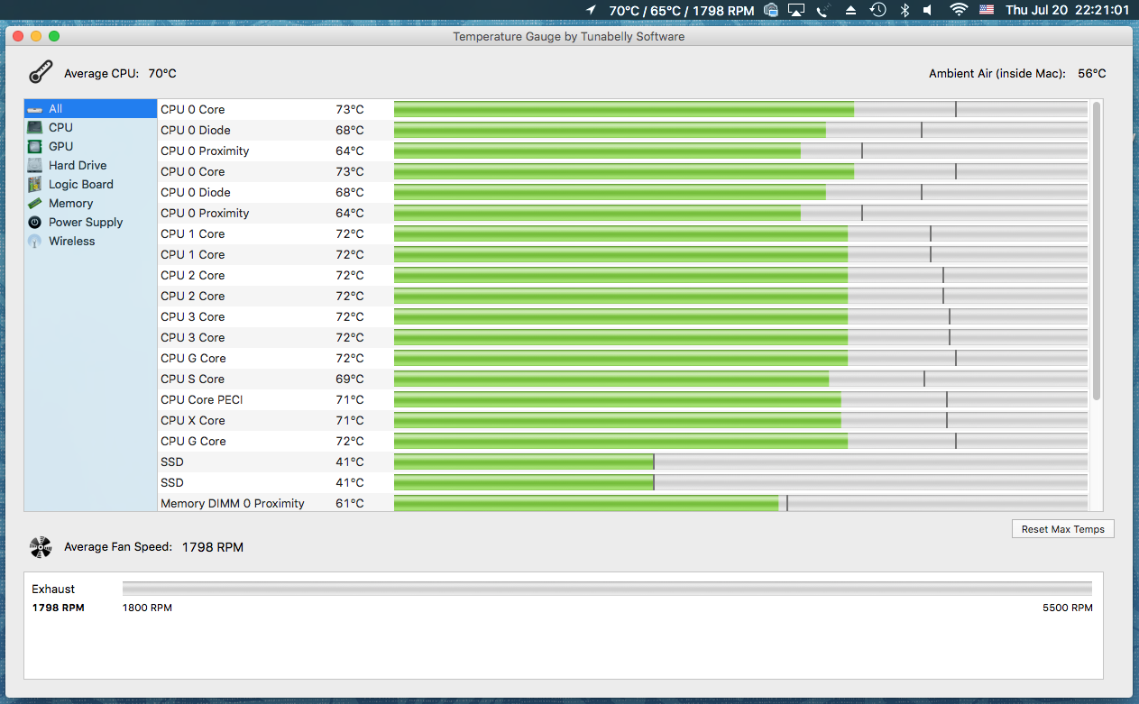

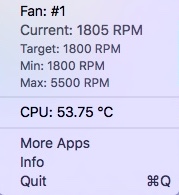

We should find out how hot your Mac mini really is! If you download Temperature Gauge by Tunabelly Software you can also determine the cooling fan speed.
I agree with your wish to avoid baking that Mac mini. 😳
Note: This screenshot shows the temperature profile of my 2012 mini. Because the Tunabelly utility displays historic high readings a user can compare current temperatures and fan speed with numbers from other times.

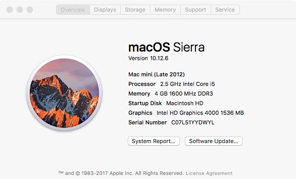

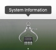

I suggest that you also should try Temperature Gauge software or something similar. With that program and the Activity Monitor application that you already have you can find out exactly what is hot, how hot it is, what applications are using the most CPU%, and how efficiently your fan is working.
If you two can post readings from your computers we should be able to help you to diagnose those minis in no time. 😎

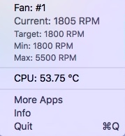

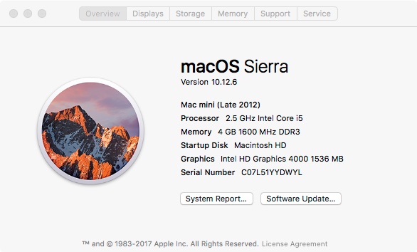

Just for reference, my system info and info from fanny.
