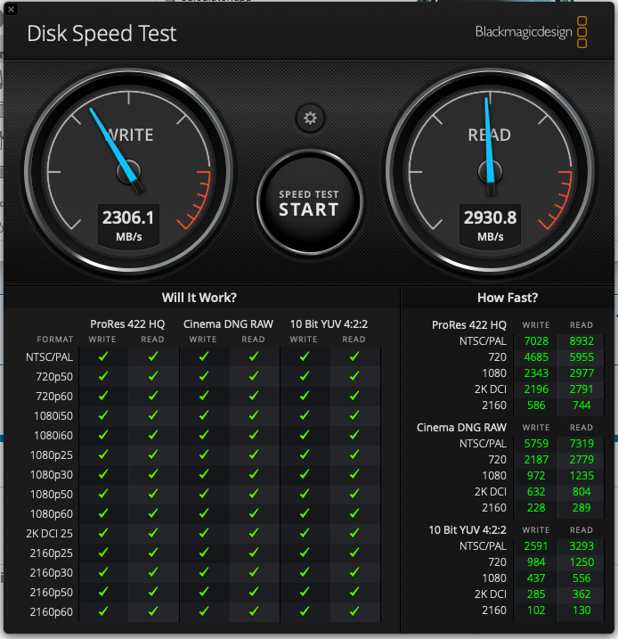

The M.2s arrived today. The 4M2 card has four, and here's a BackMagic speed test result:
I'll be using the four HP EX950 2TB modules as JBOD, so the 6K data transfer rate won't show up here. Maybe later.

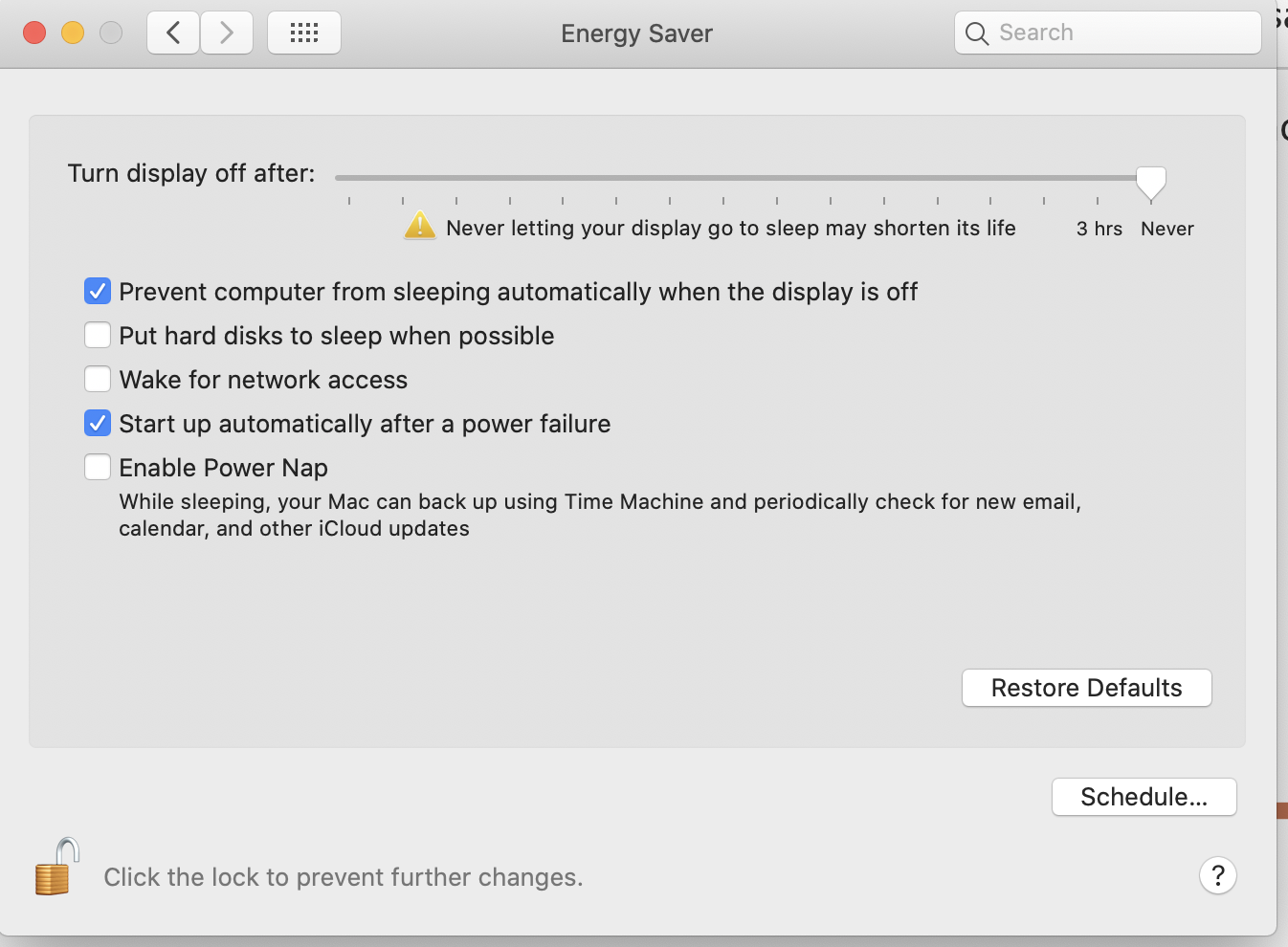

Excellent thanks. And just to be 100% - that's the check box in "system preferences -> Energy Saver -> Put hard disks to sleep when possible" is not selected
I also have "turn display off - never", and
"Prevent computer from sleeping automatically when the display is off" checked
and...
I'm guessing screensavers make no difference (?)
and...
SysPref/Energy/Computer Sleep to Never too.

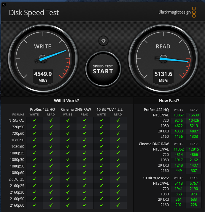

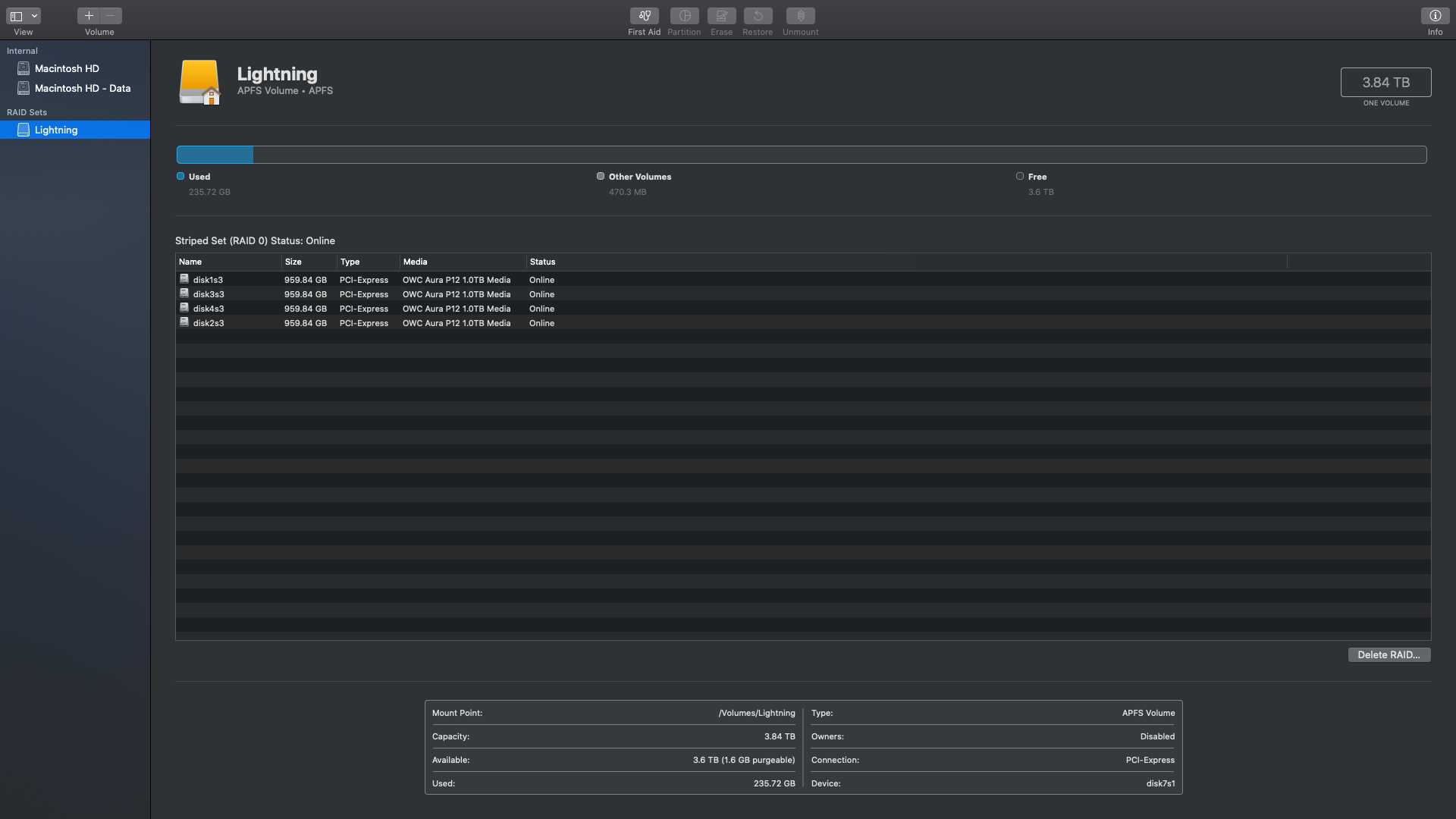

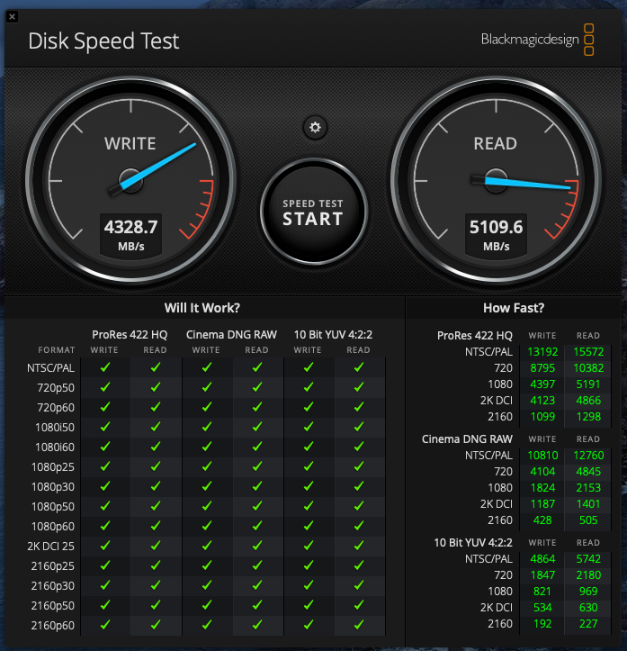

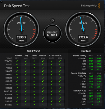

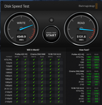

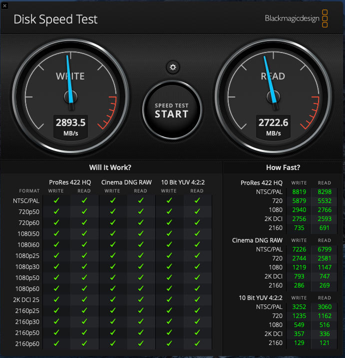

I bought the 4.0TB OWC Accelsior 4M2 PCIe Card that comes with four 1 TB OWC Aura P12 sticks. I installed the PCIe card in slot 5 (x16) and configured it as an Apple Raid 0. I moved my Home directory to that Volume and install most third party apps/games to that volume as well.
1 GB stress tests on the unencrypted Raid 0 APFS deliver 4550 MB/s write speeds and 5132 read speeds. 5 GB stress tests deliver 4329 MB/s write speeds and 5110 MB/s read speeds.

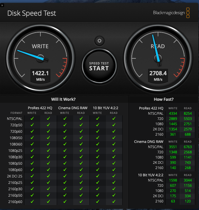

For comparison, the stock Apple T2 250GB SSD delivers a paltry 2894 MB/s writes and 2723 MB/s reads for 1 GB test and 1422 MB/s writes and 2708 MB/s reads for 5 GB test.
I'm running 8-core CPU with 240GB RAM and stock 580X graphics card (waiting for end of year refresh). I like the OWC setup... Have not had any issues thus far.
