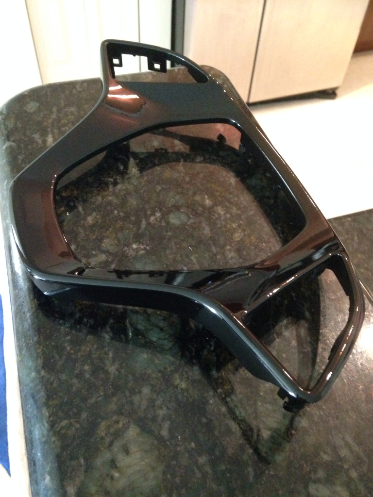

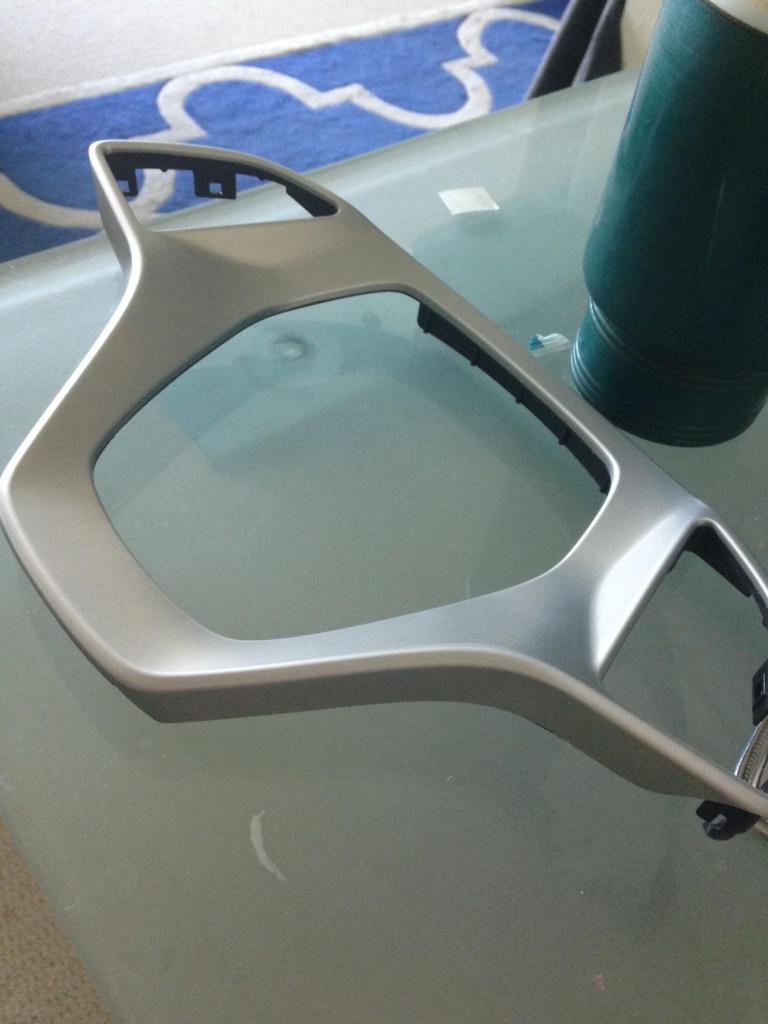

Before, a steering wheel alum bezel:
After , using the above process:
Reactions: IllusionEntity

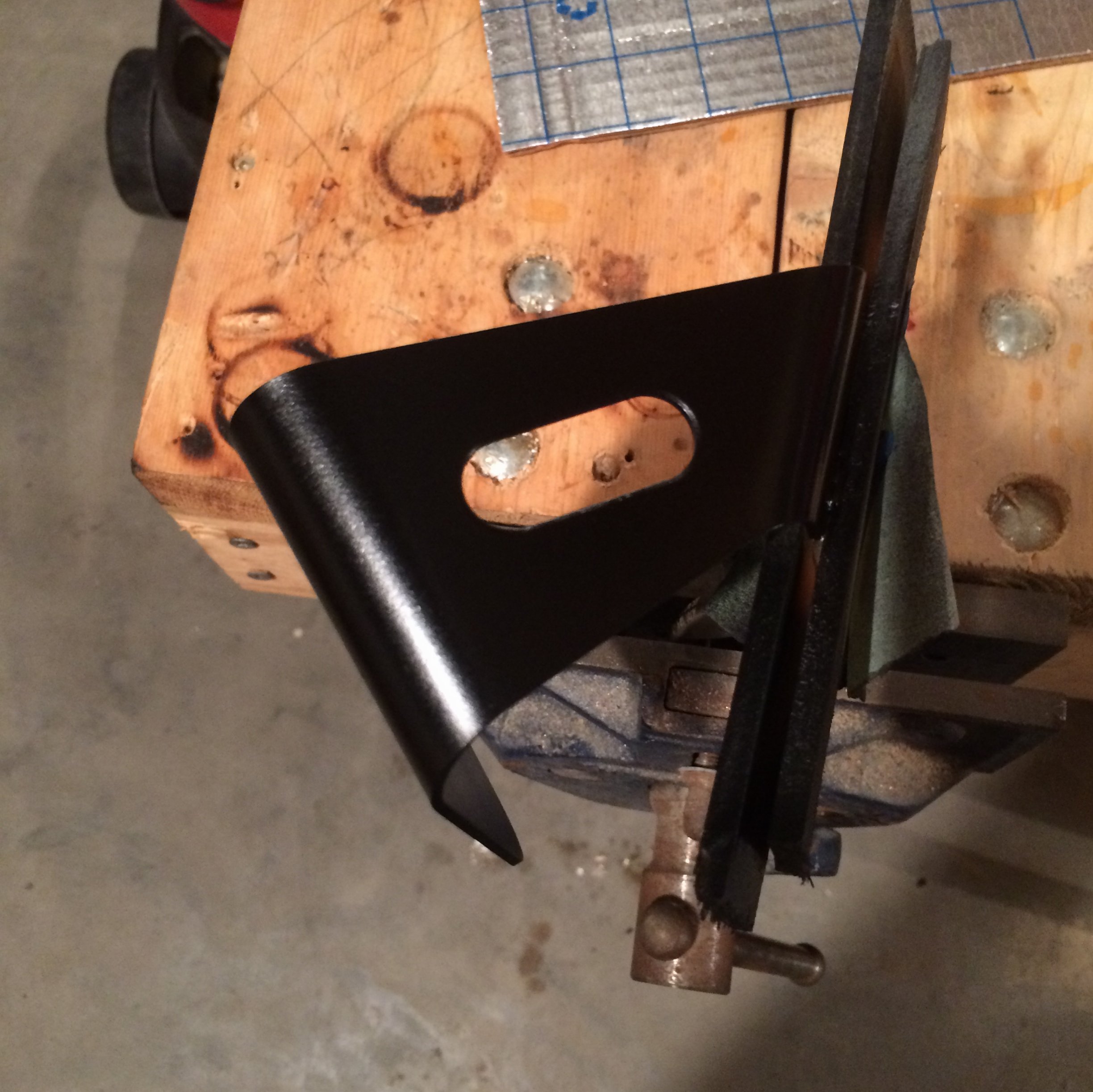

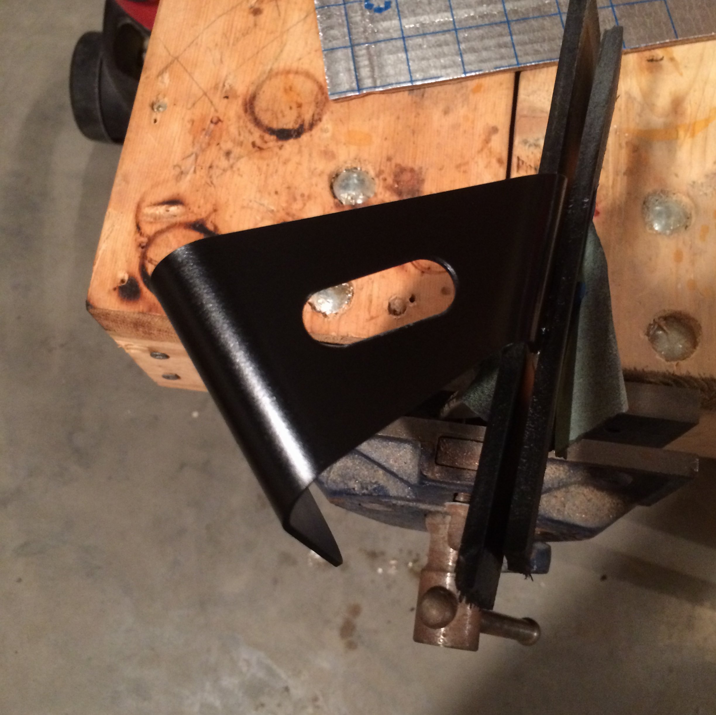

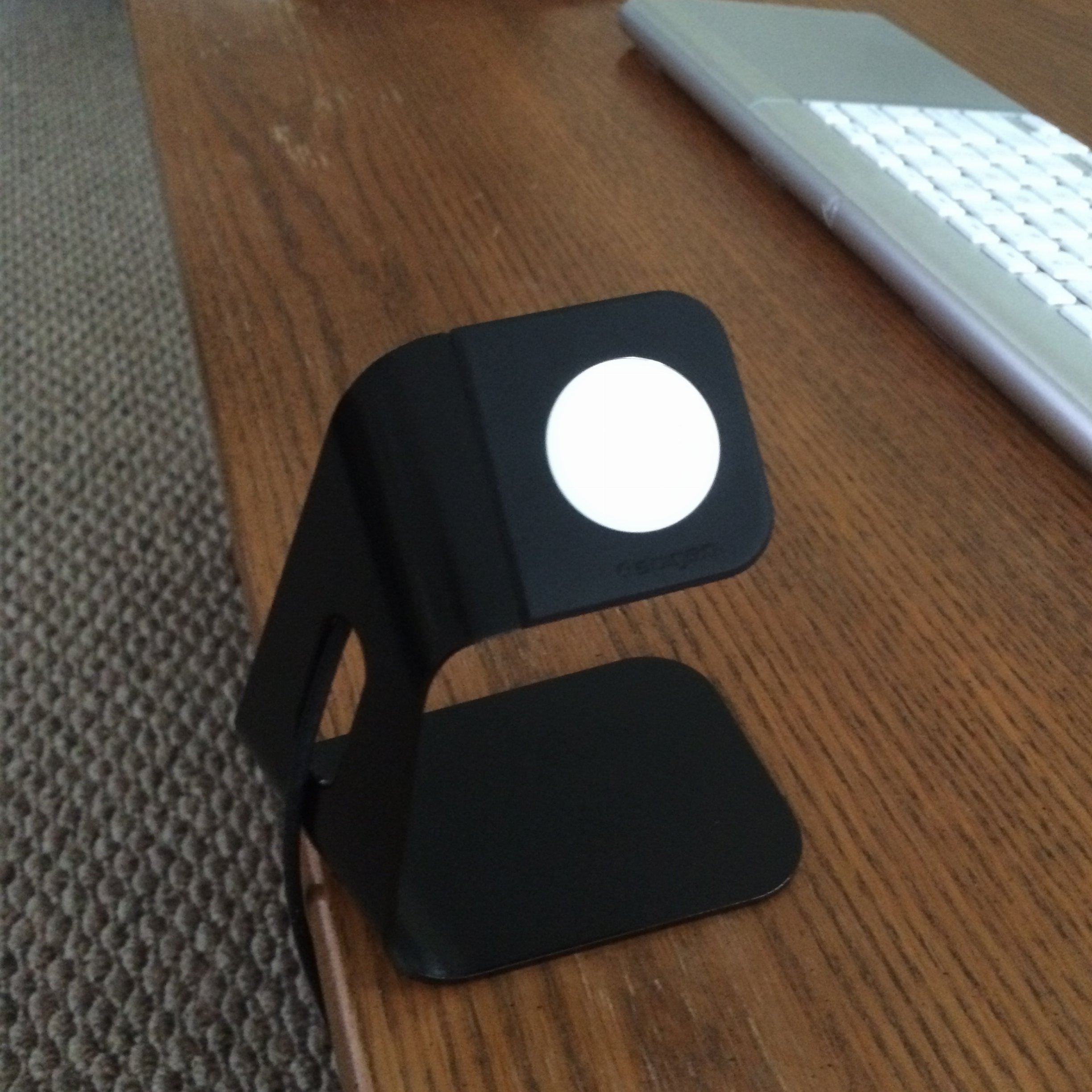

Today was stripping the stand back down to the metal, then re-priming and following the instructions Glen gave for applying the paint and clear coat. I ran into a couple of snags due to my environment (I do my painting outside), but I think the end result's very good and will be quite nice once I polish up the finish in a couple of days (min 48 hours to cure).
Here's the new paint I'm using (re-using the self-etching primer noted before):
Yes, we're using automotive paint now, for the best possible results / quality.
This is the stand with all work completed, just the first coat of clear applied. Took a few pics - didn't seem to really photograph well (maybe the camera on my 5s is simply having trouble focusing on it).
Next pics (in 2-3 days) should be of the stand after polishing, then the installation of the charging cord.

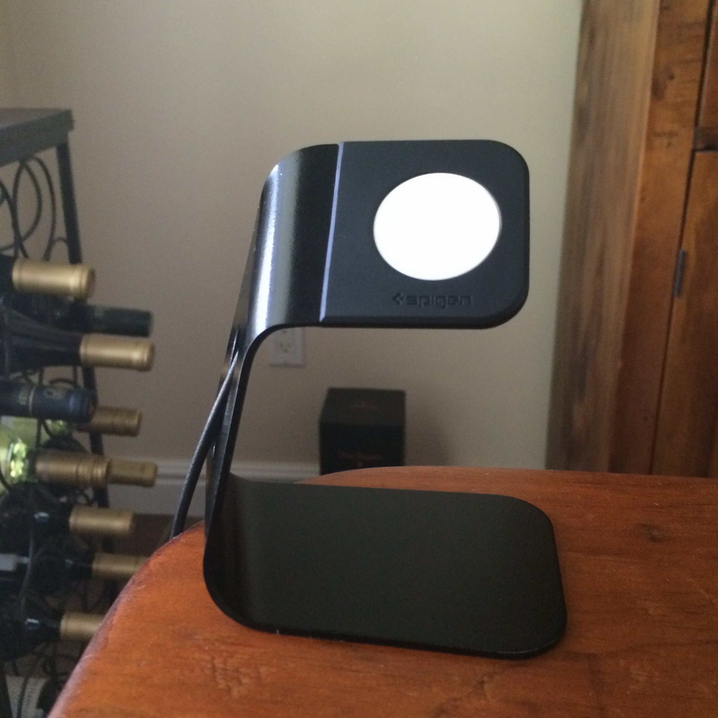

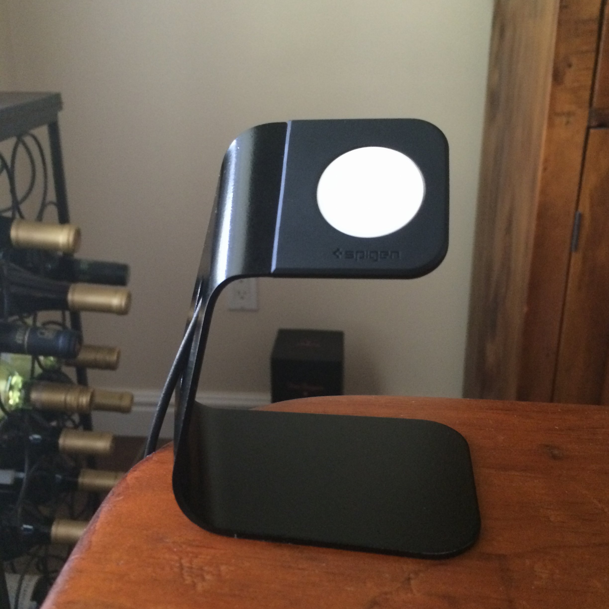

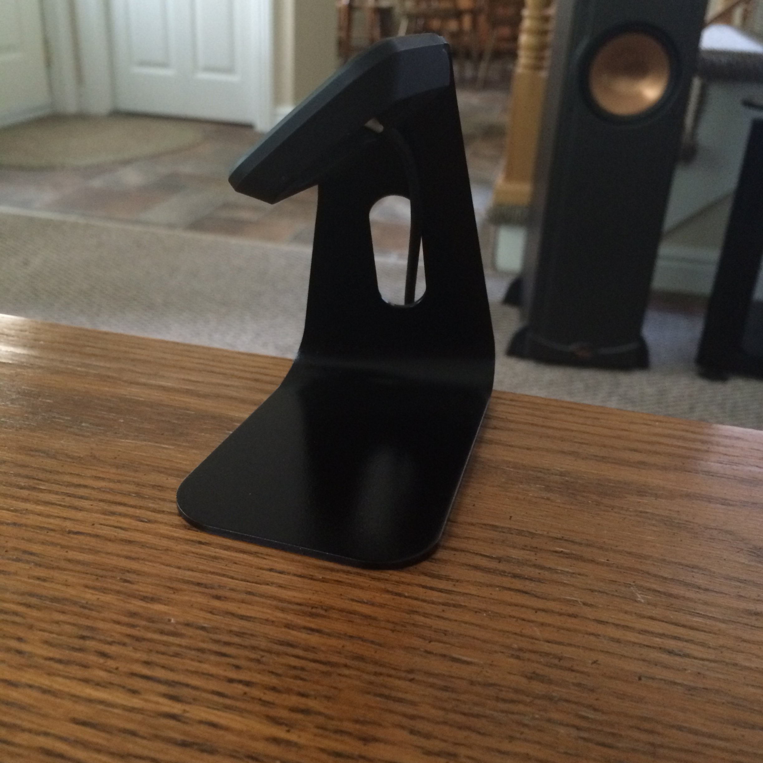

Bit of a delay in getting the polishing done - life's what happens when you're making plans. :)

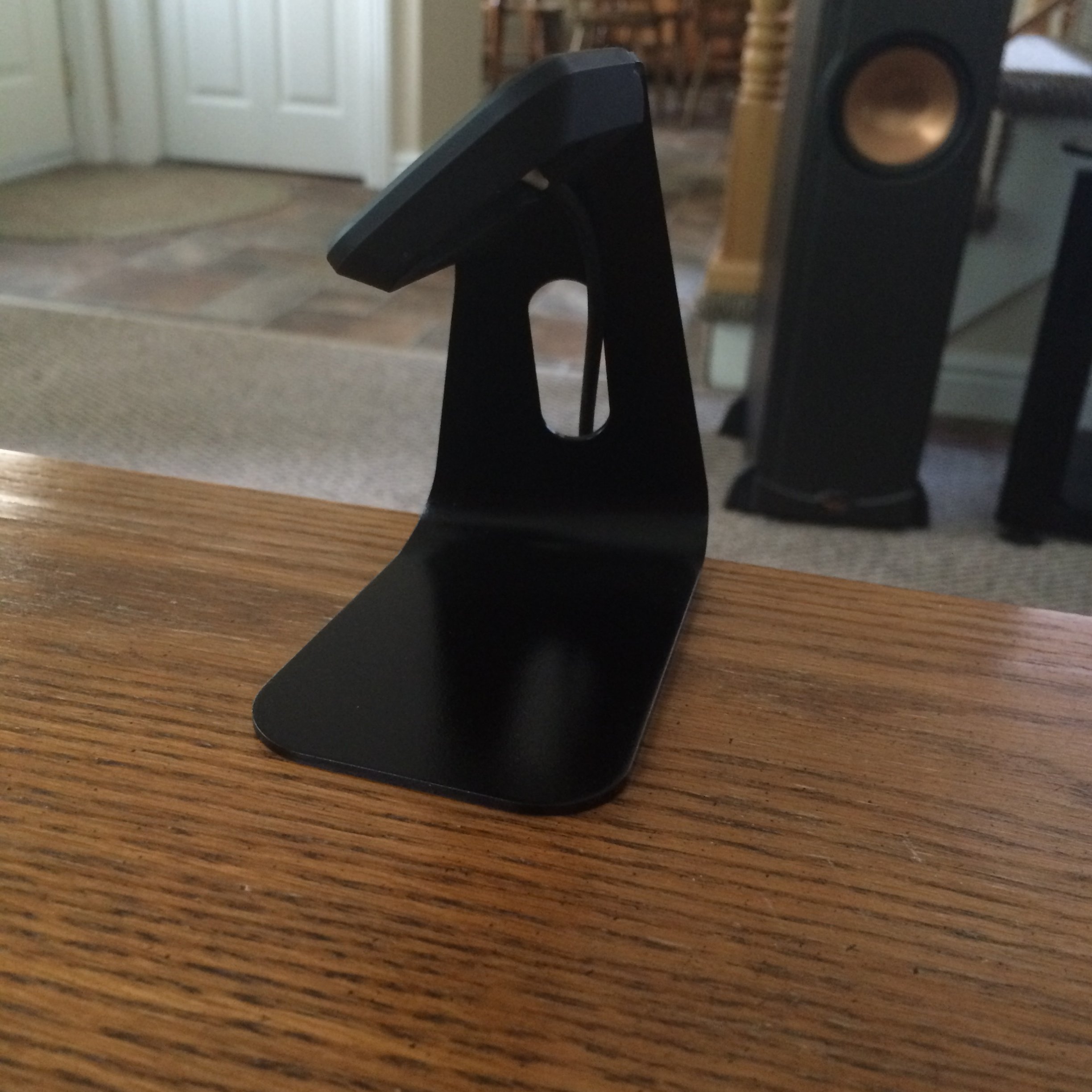

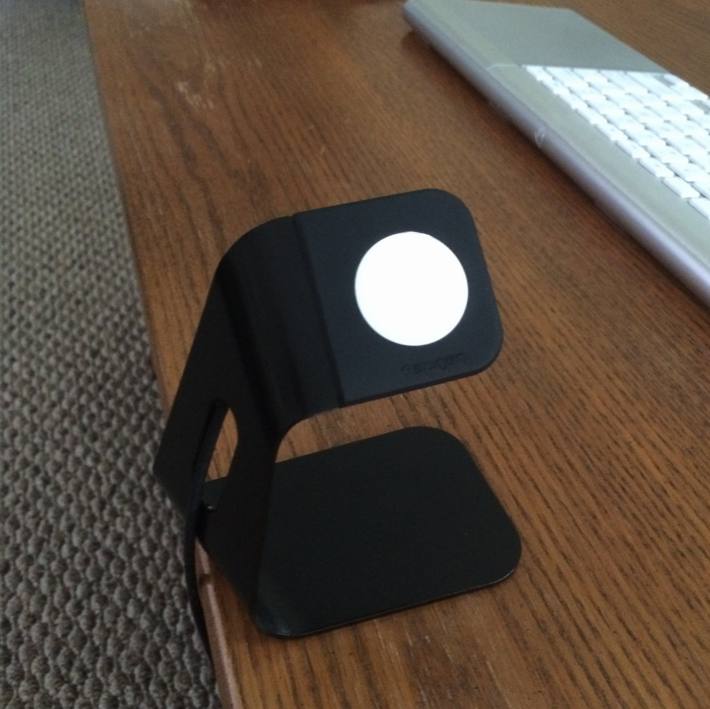

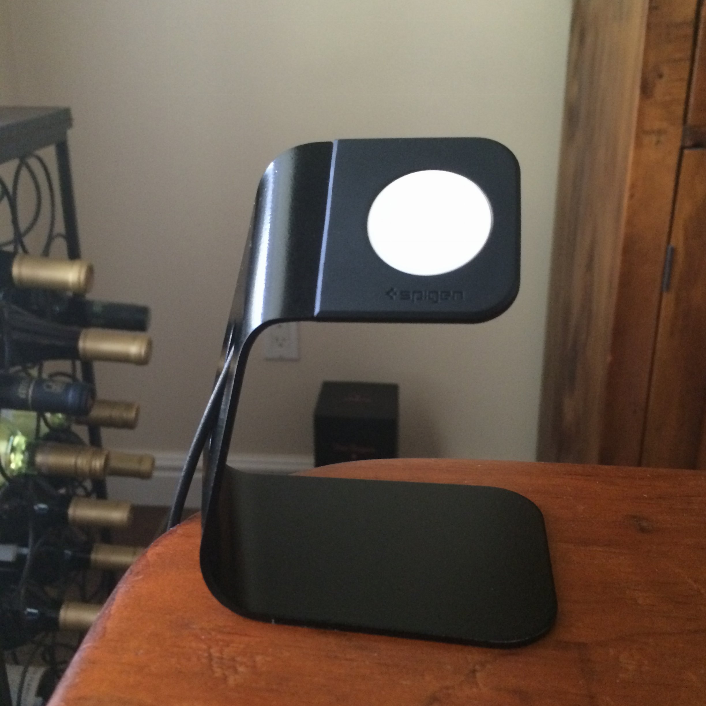

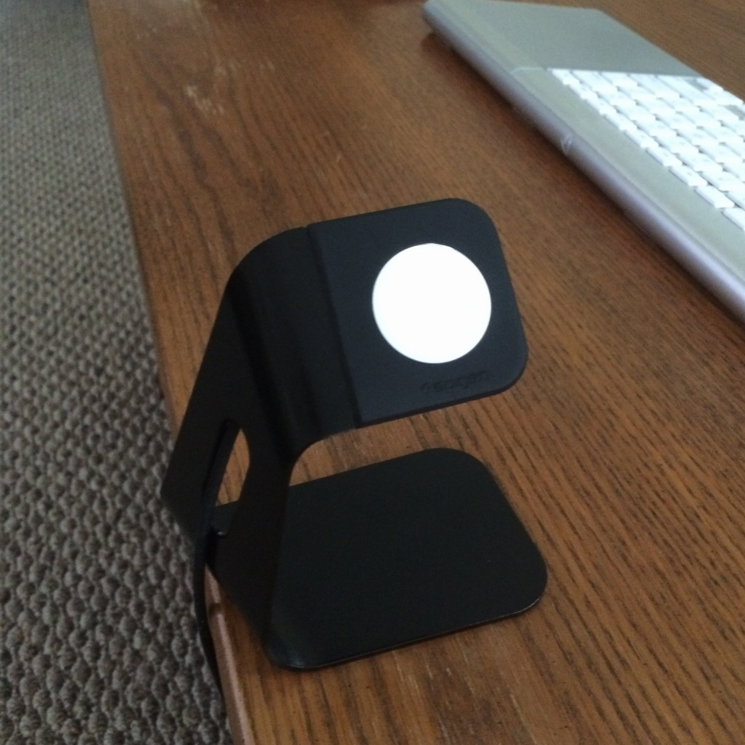

Ok, so I've polished it with Meguiar's Ultimate Polish (which is really for pre-wax prep on automotive paint) - it will remove any swirl marks and give you a nice, shiny finish.
Here's one pic with it showing how it catches the light:
And here's another one showing the stand in neutral light (living room) - note, the cable really blends in well.
In fact, the cable blends in so well, that I'm not going to bother with gluing it to the back, left edge of the stand. I think it looks fantastic just the way it is! :)
I'll reserve the "after" shot that I'm going to post on the first post for tomorrow - that's when my Space Black watch is arriving. These should complement each other very well indeed!! :)

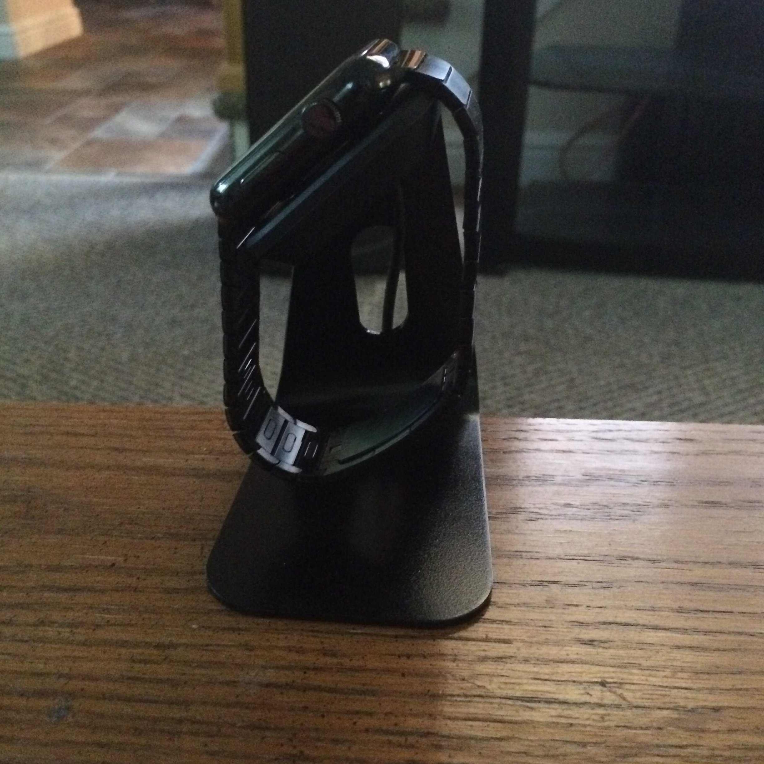

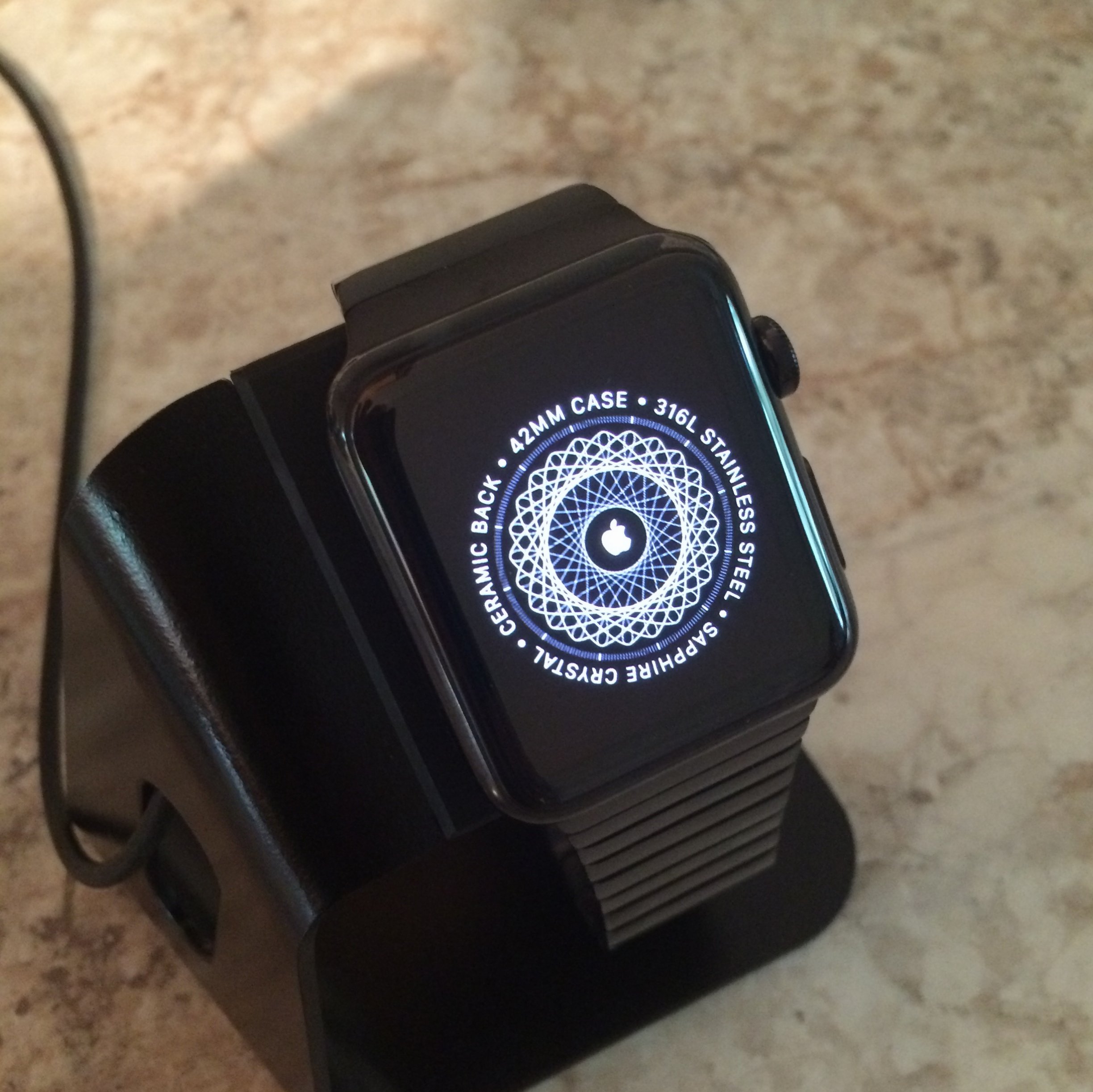

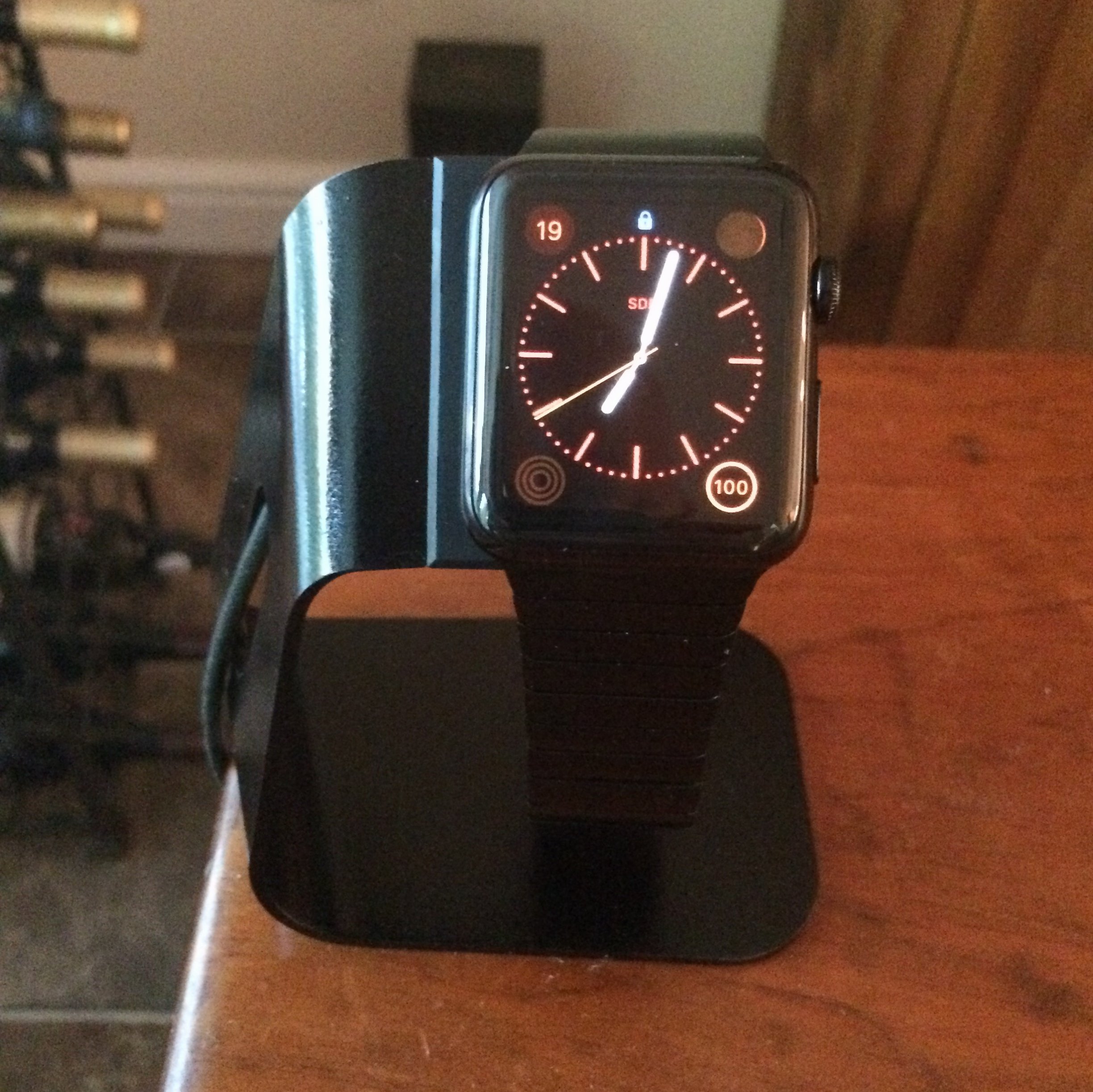

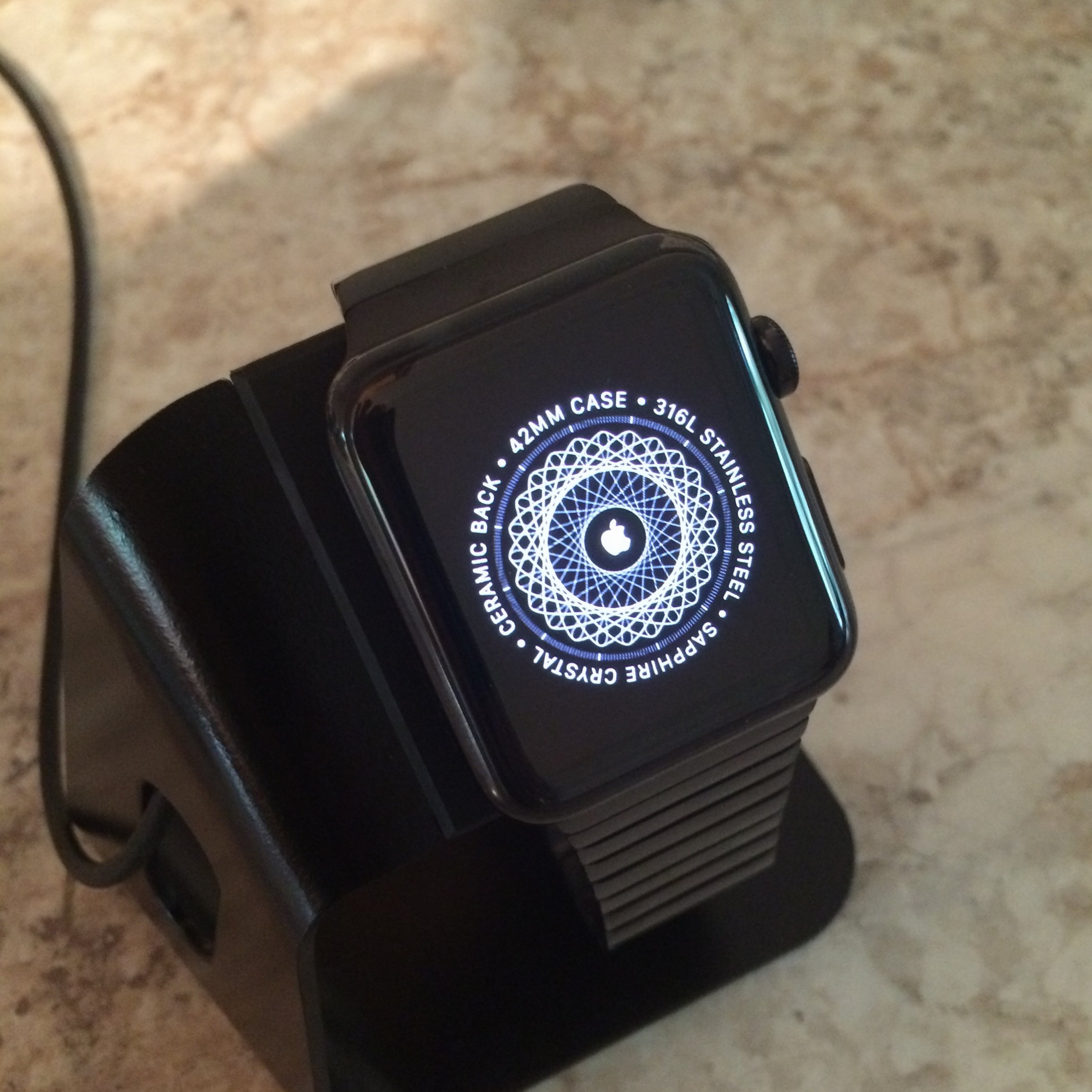

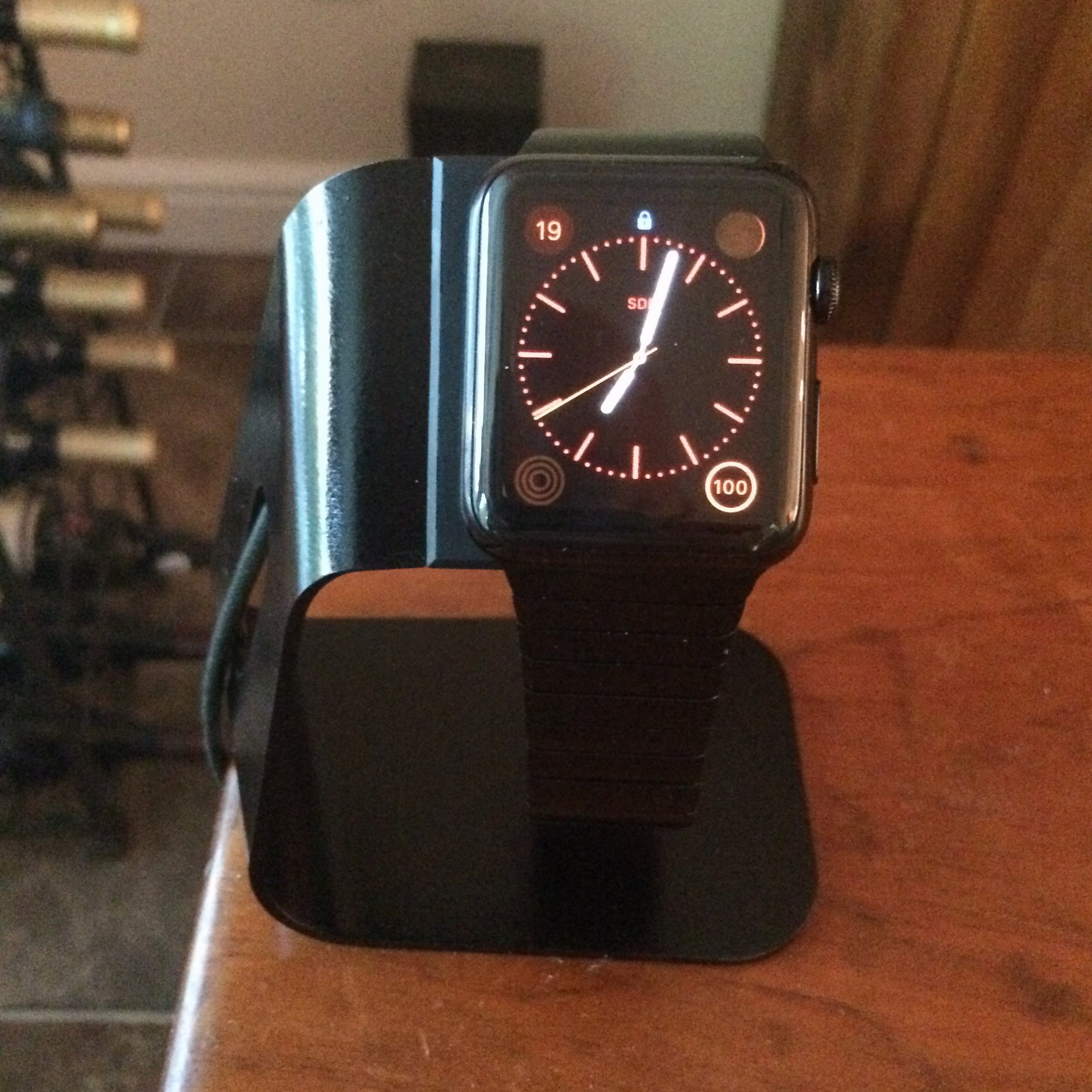

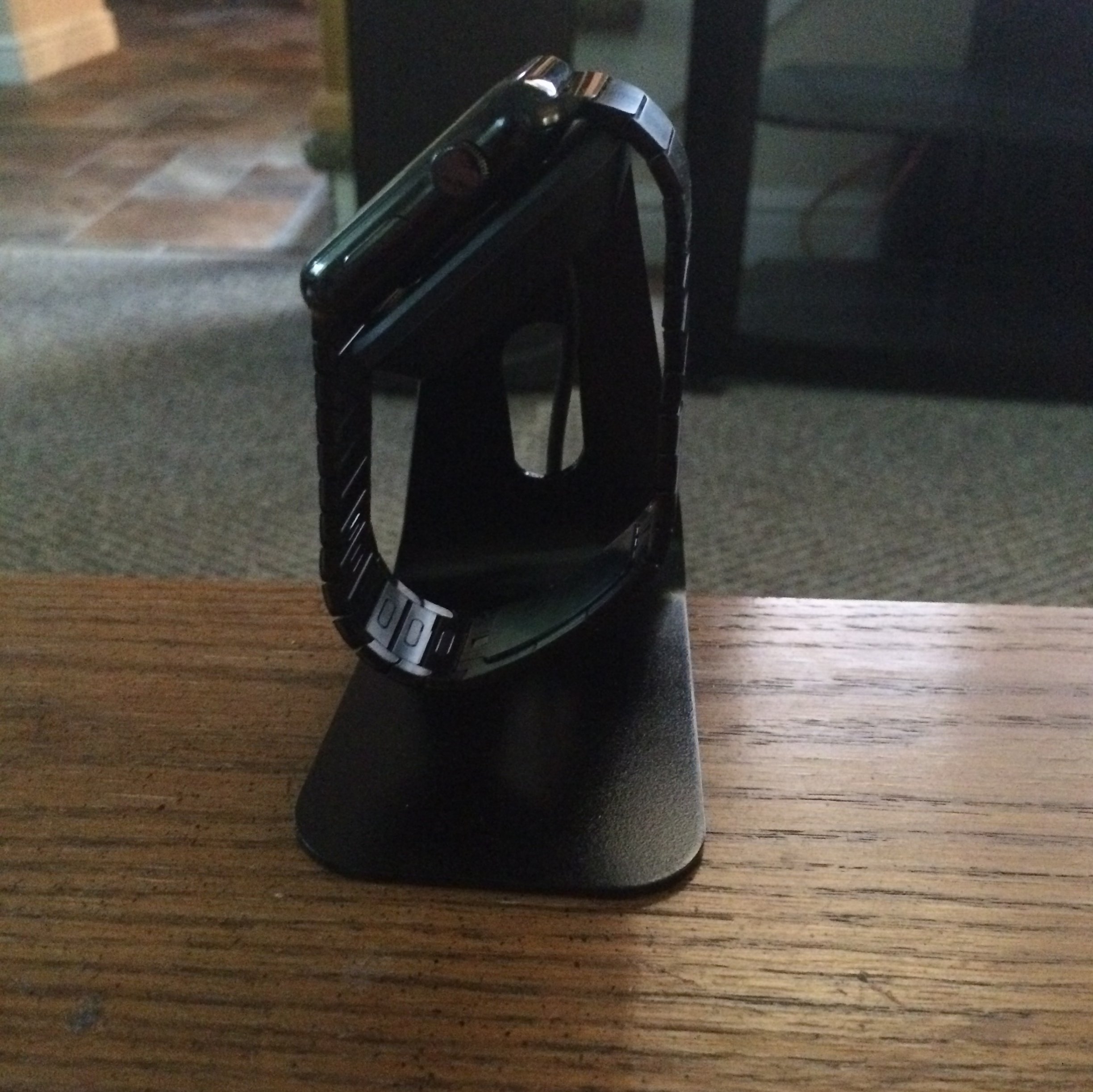

A few pics with the watch that I finally received yesterday! :)
For those that are in the "Nice, but way too much effort" camp, it really isn't. If you want to completely minimize the effort involved, you could go with the self-etching primer, then a light coat or two of a good semi-gloss paint and still get a very good result. It doesn't have to be automotive paint like this is - automotive is simply the highest quality and most durable. (maybe a little overkill for a watch stand) :)
View attachment 562390 View attachment 562391 View attachment 562392
In the last picture it looks like a pretty flat finish to me. I'm going to give this a go soon I think.
