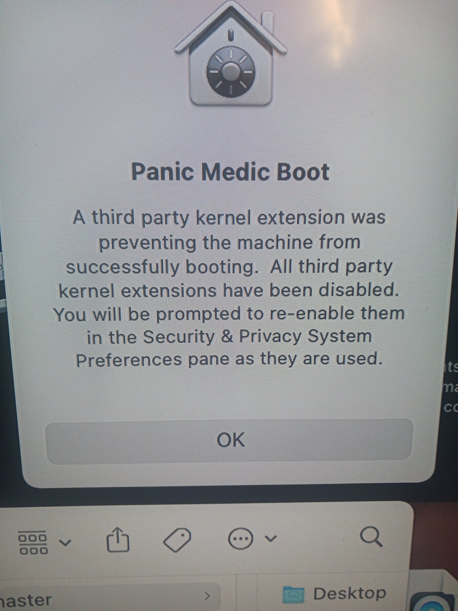

Hi there. I am a super noob so please have patience with me. I am a songwriter and have my computer for one purpose, writing music. I use a program called logic x and until today I have had no problems with my mac mini m1 2020 running big sur. For some reason my computer keeps on restarting, with "Panic Medic Boot" showing up before restarting again. Tried reinstalling big sur but it says it doesn't have enough space on Macintosh. I have precious files on this computer that are not backed up. Can somebody please help me? I would really appreciate any help. Thanks again

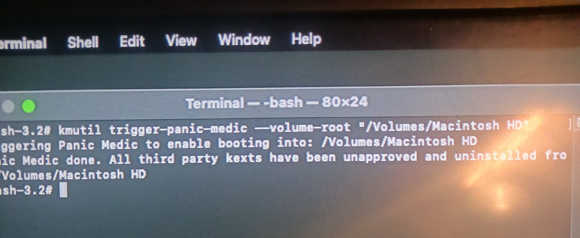

This might get your system out of the reboot loop.
From Terminal in Recovery, run the command
Code:
kmutil trigger-panic-medic --volume-root /Volumes/Macintosh\ HD
or
Code:
kmutil trigger-panic-medic --volume-root "/Volumes/Macintosh HD"
They are identical in effect, just different way of writing them.
The command will “Delete and disable loading of third party kexts in order to safely boot into a target volume. (can only be triggered in Recovery mode)”

I tried both ways and this was the response both ways attached picture but it still keeps popping up and then restarting. Please help me.

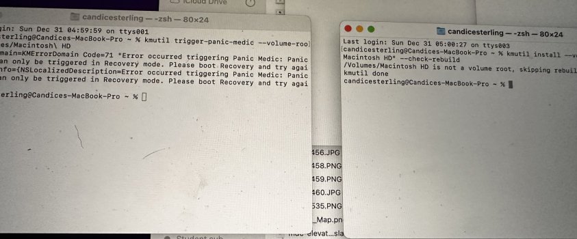

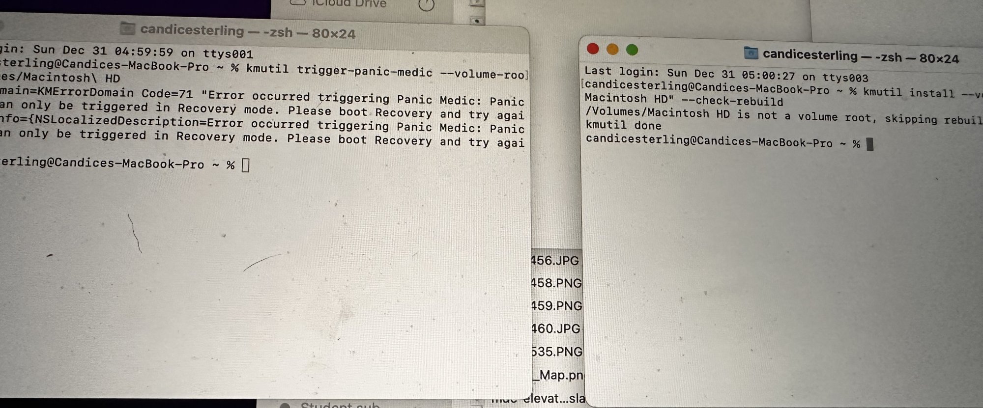

Hi there, I’m so glad I found this post I’m having the exact same problem. I’ve tried to follow the steps in which you took, but my Mac is still crashing and restarting. Could somebody help me with the steps as I too have a lot of files on this computer that I cannot transfer because of the continuous crashing. Please, and thank you in advance.
Cannn81
macrumors newbie
Dec 30, 2023
2
This is the error message I get when I enter in both scripts. Please help.
