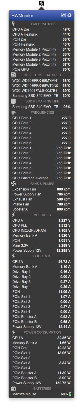

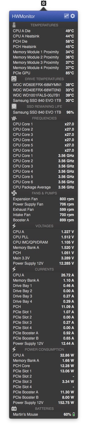

A quick test is done in 10.11.4, use Kext utility to install the FakeSMC, CPUsensors, and GPUsensors kext. No kernel panic during reboot, but GPU monitoring not working so far for my HD7950 and R9 280.
The CPU sensors actually working, so now I can monitor the CPU frequency. However, the GPU temperature always stay at 85, it's the max reading that can display, nothing related to the real temperature.
We cannot rely on EL Cap for advanced sensor reading , I guess . We then require an earlier OS X version .
Your guess is wrong. Unless you've done some under-the-hood fiddling, as I mentioned above, unsigned kexts will not load in Yosemite and El Capitan. This is a major "feature" of OS X that you should already be aware of, and I'm not sure why you're concerned with "advanced sensor reading" if you're not. I haven't looked for a while, but "kext-dev-mode=1" used to be a workaround.
