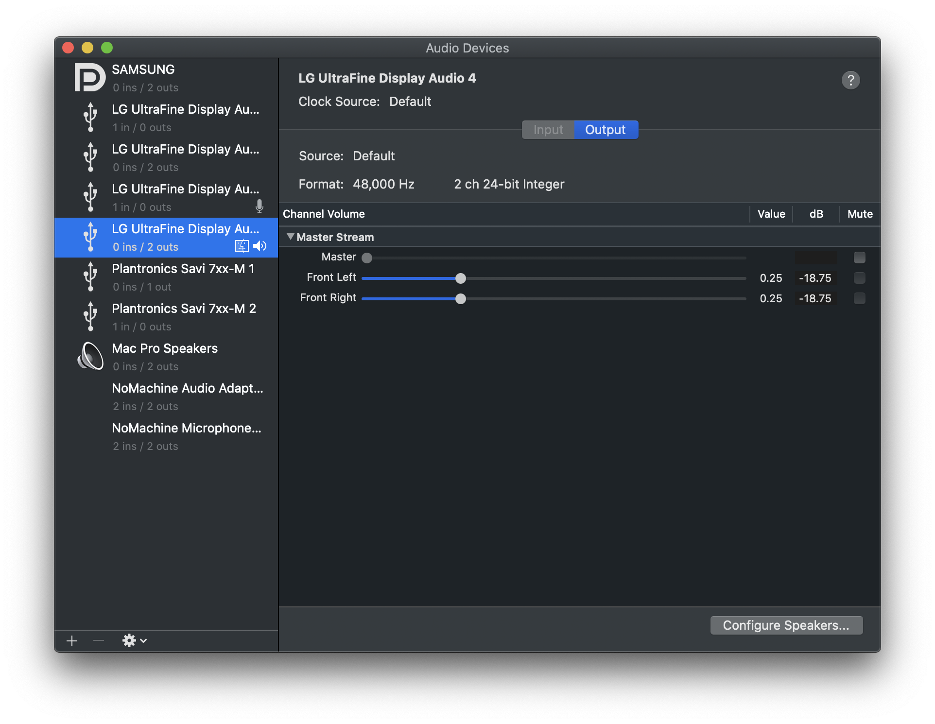

Call up the MIDI application and snag a screen shot for me?
Just my screens, headset, the internal speaker, and NoMachine's (VNC tool) virtual audio devices...

OK. Something is definitely going on with your dock and your Mac. Dumb question: do you have your dock powered?
Yeah, it was powered but the dock had some how glitched. The light was on on the dock, pass through TB3 was working, the behavior I was seeing survived a reboot of the Mac Pro, finally decided to reboot the dock (pull power and plug back in) and it came up. Something must have hung internally but it's there now.

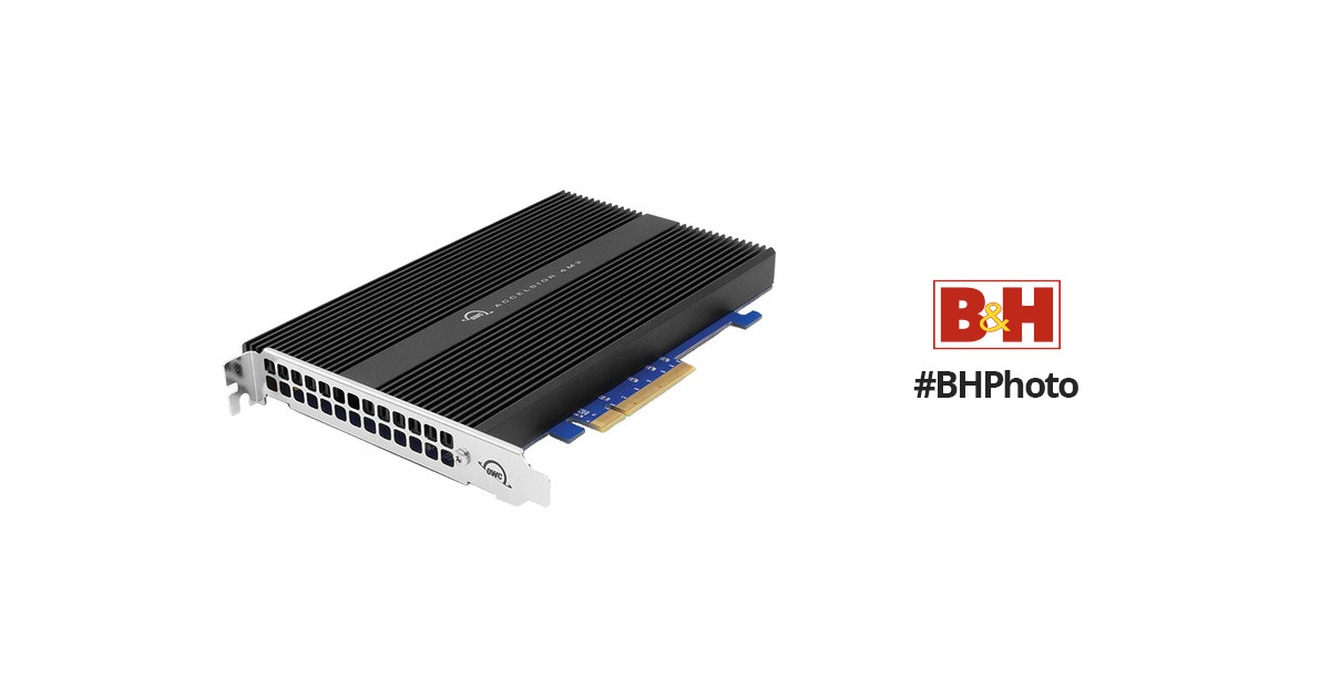

Were you able to order the OWC Accelsior without any OWC drives? I can't find a way to do so.
This is the ONLY place I’ve seen listed. No idea if it’s the MP5,1 model or MP7,1 model or what their blade compatibility chart officially states because none has been published. For those reasons AND the x8 limitation, I would not recommend the product.
Reactions: natallica
I'm thinking of getting the OWC ACCELSIOR 4M2 8TB version https://www.owcdigital.com/products/accelsior-4m2
Is this card bootable? Can I do bootcamp on it?
In its stock format from OWC this unit will not be bootable as it's a RAID-0 formatted device. The only way to make it bootable is to reformat it as JBOD (4 separate blades). Then setup one of the JBODs(blade) as APFS and install or clone your boot image to it. The other three JBODs(blades) can then be setup as a 3x Blade RAID-0.
Thus is you were to buy the 4TB OWC device you would have
1) A 1TB bootable blade formatted as APFS.
2) Three blades formatted as 3TB RAID-0.
