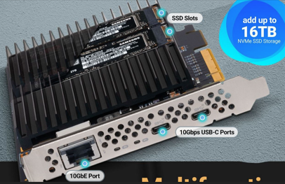

A little more I would have gone the McFiver route.
McFiver PCIe Card
Multifunction Adapter Card with Dual M.2 NVMe SSD Slots, 10Gb Ethernet, and Two 10Gbps USB-C Ports
Reactions: TheStork
