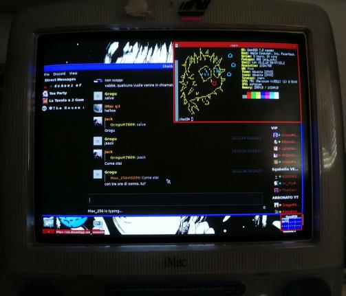

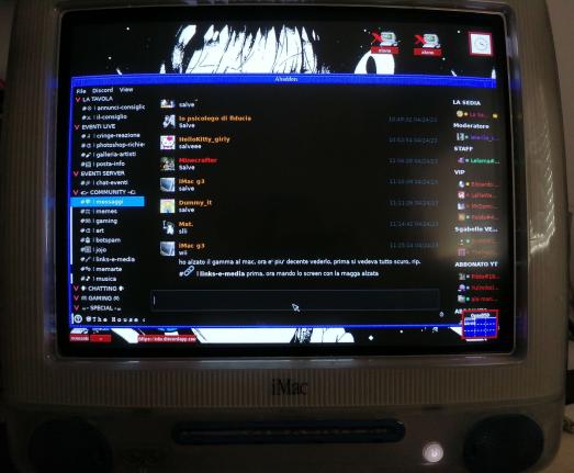

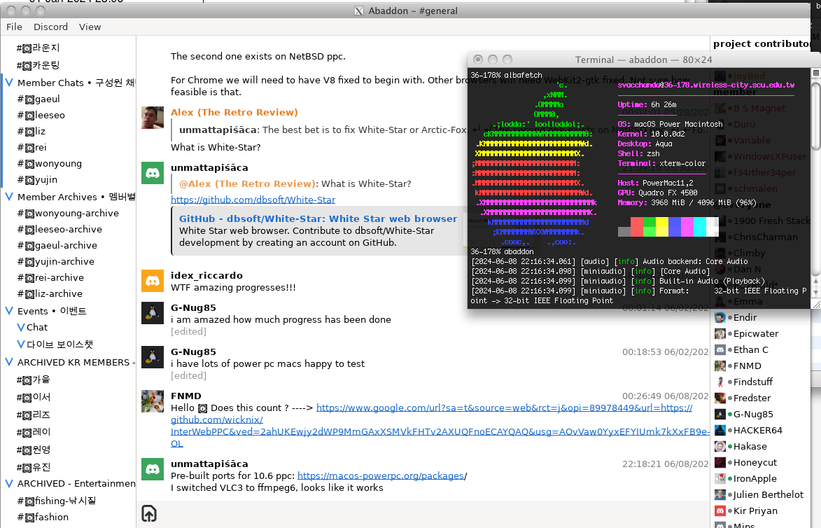

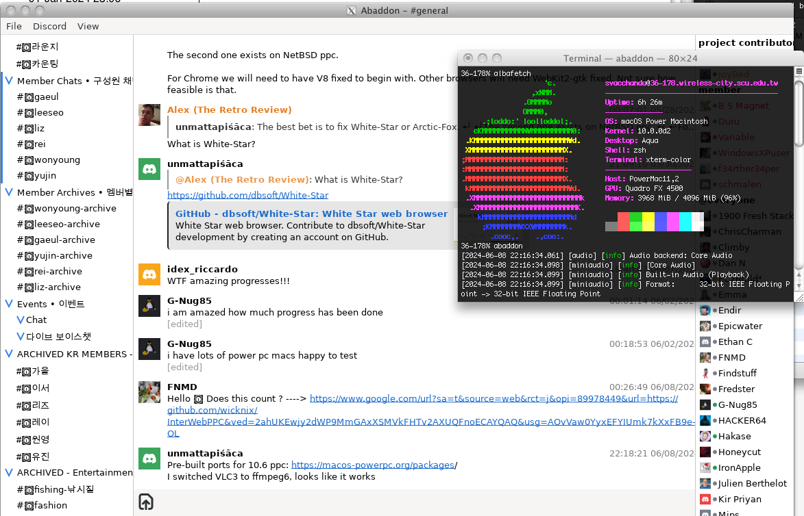

now the guide is finished, there is some photo with my imac g3 running abaddon on openbsd 7.3
1) first photo, yes i'm italian, not notice this.
2) second, with the system info
i hope you like this guide! let me know i missed something 🙂

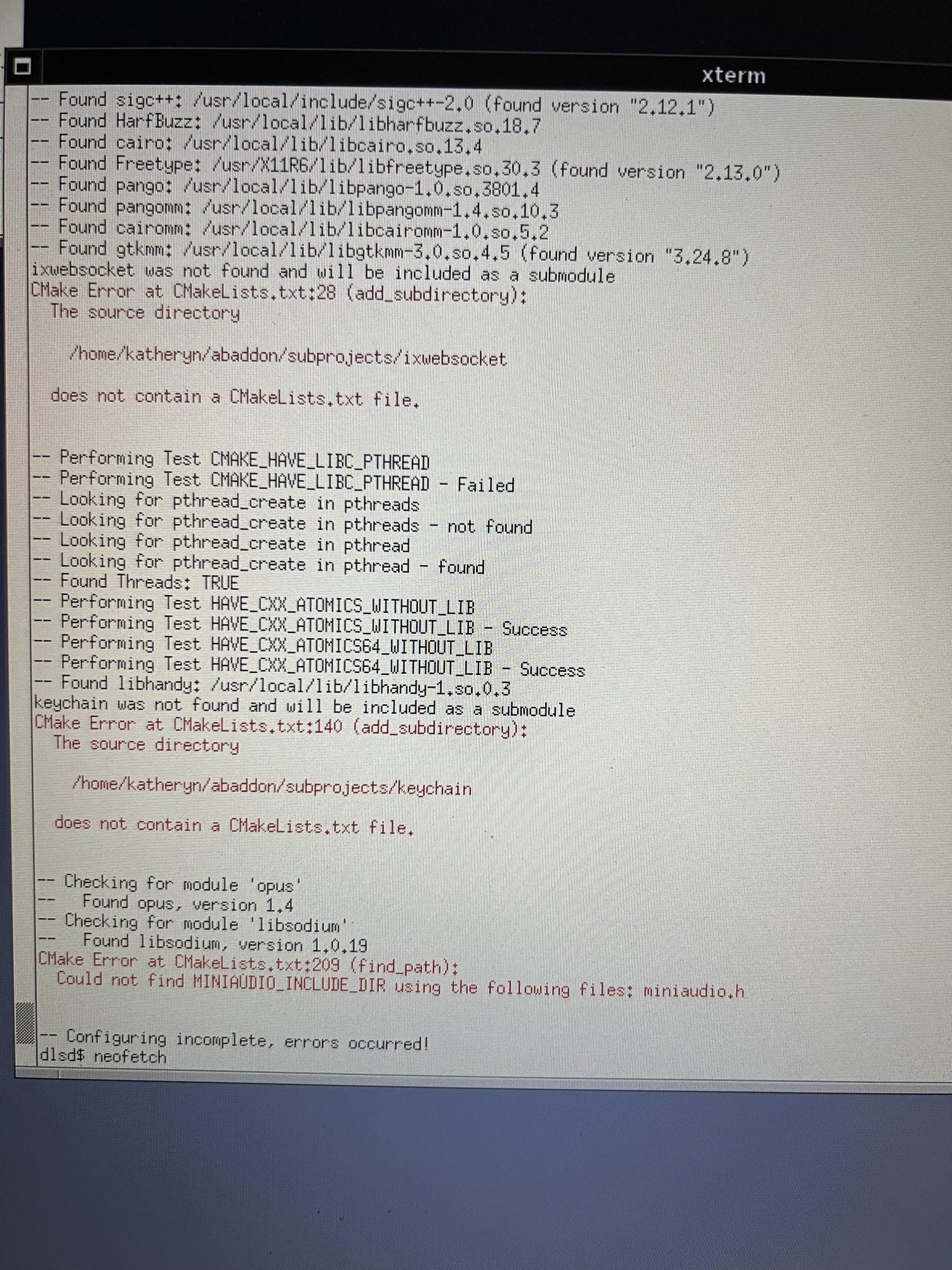

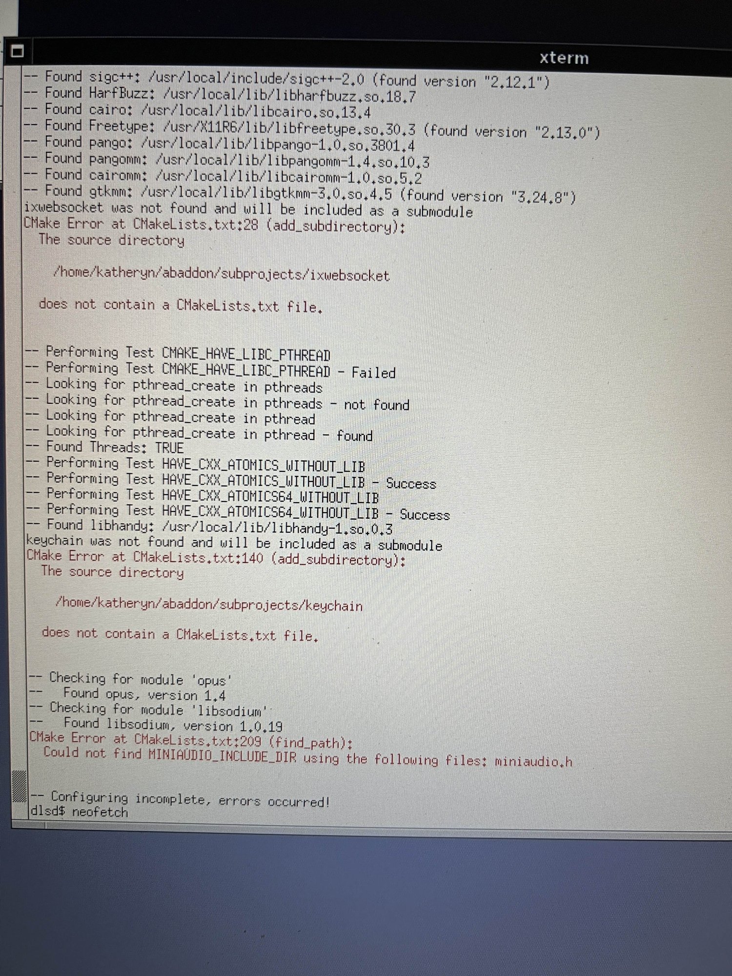

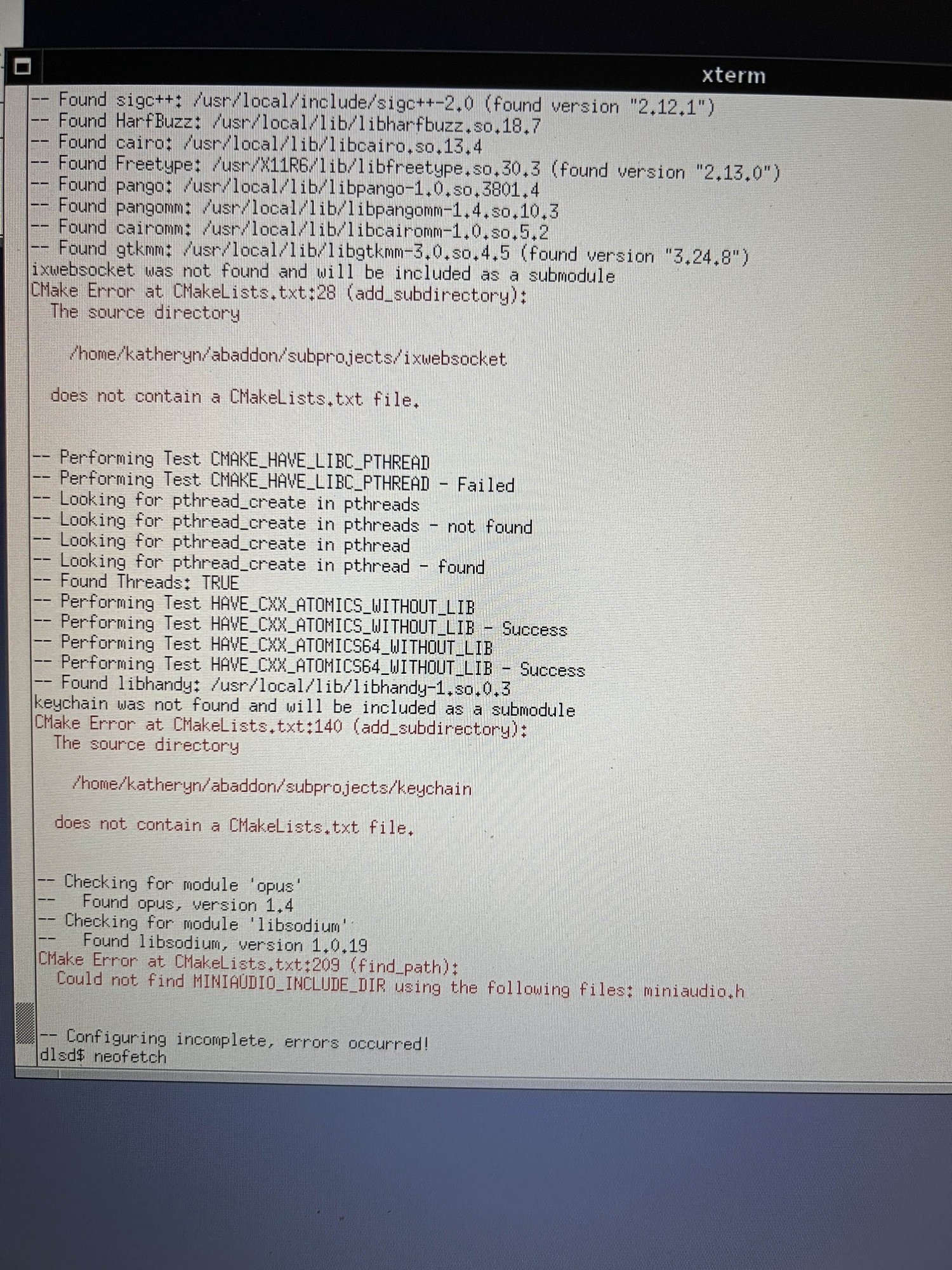

getting these errors when i try to compile it on my powerbook G4 DLSD. are there any other packages that need to be installed?
As long as you do not care about reproducible builds, perhaps you may just clone git repo with submodules. As I recall, that also worked fine in MacPorts, I just preferred instead to make separate ports for each dependency and do not fetch anything during the build.
