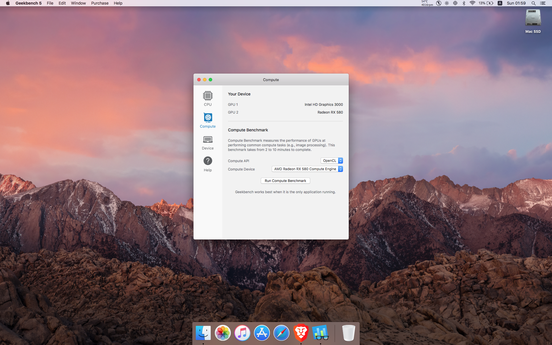

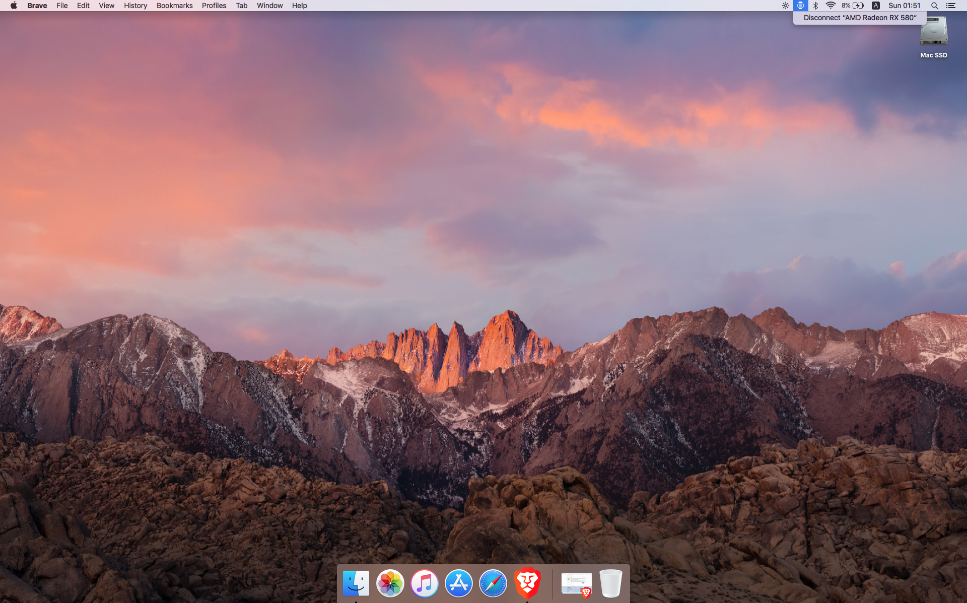

So I was able to successfully run the EGPU into this macbook pro 2011 and disable the SIP I dont really understand what was the real issue but if my macbook did something that need to restart after the restart while logging in it will always shut down itself but this was solved by waiting around 30minutes later for it to cool down or whatever and it works. But currently EGPU works on the Macos.

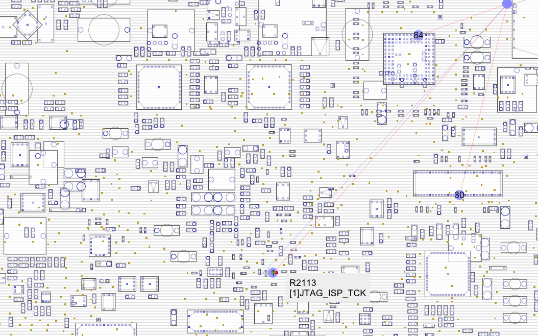

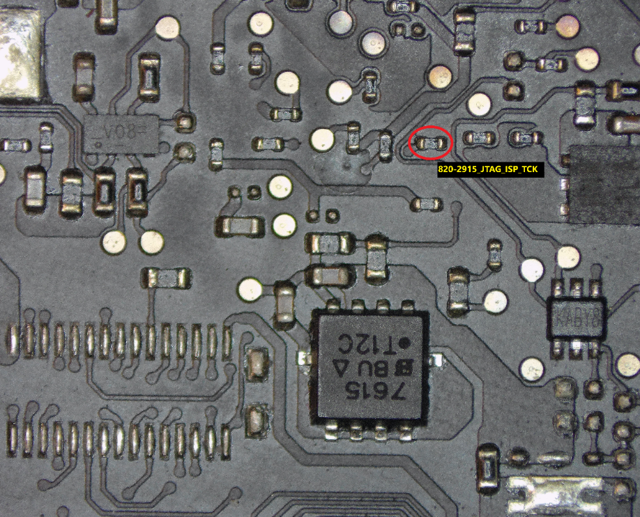

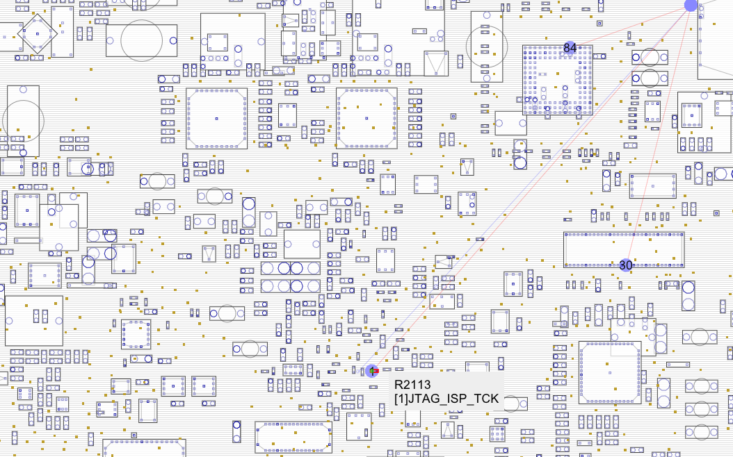

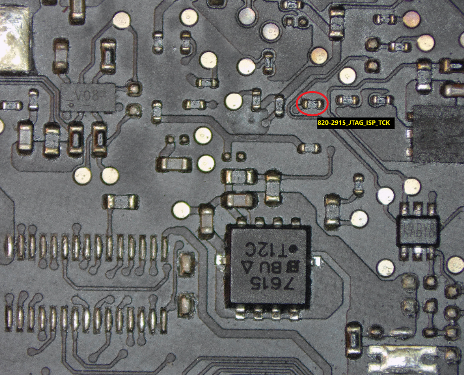

Hi can someone point me to where the L2406 is on a 820-2915B board or have a picture would be even better, The flash keeps failing even tho soldering is good I'm using windows 10 pro latest update would that be the issue or is it ok to flash with Win 10 ?
Hi I'm looking for a alternate TCK point on a 820-2915B board if anyone has a pic please I hit off the TCK wire with all the messing about trying to flash it and pulled the pad off gurrr :mad:
I can get it for you later today when I get home from work, if somebody doesn't get in first that is. Or you can just google for the board view file.
Reactions: J2G
Its ok Analias I found the board view file for my board and located the JTAG_ISP_TCK on it I also located on my board under the scope so ill give it a go I have attached two pics with the location marked on both for anyone else that might need it.

So did you get a successful flash?
I soldered to that point all good there but still wouldn't flash tried everything just one of those stubborn boards, I ended up banging it on the ACHI IR and brought it back to life temp fix I know but it will pull the guy out of a hole for a bit.
I was talking to dosdude an he was kind enough to refund nice guy 👍 if I get another for repairs I'll try again I'd like to see this up and running.
