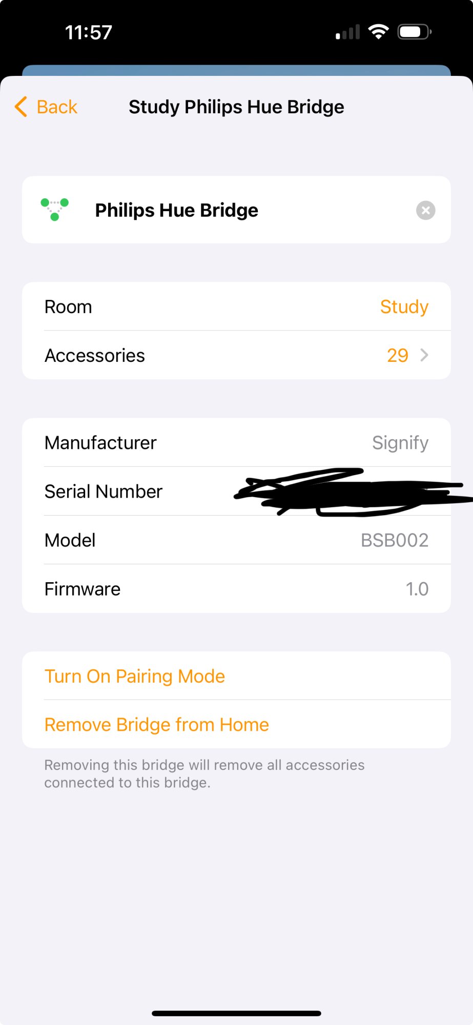

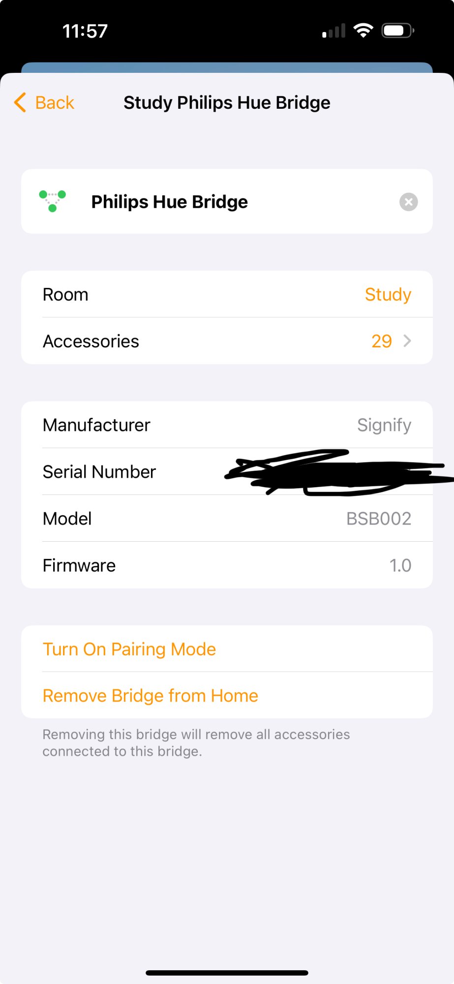

If when you look at the bridge properties it shows the icon and a link to the Hue app then that is HomeKit. If that is missing as in the image below then it is Matter.
But agreed, it should be more clear! This is seemingly on Apple to fix though.
Ah I see thanks! Make sense but yeah should be clearer to tell difference.

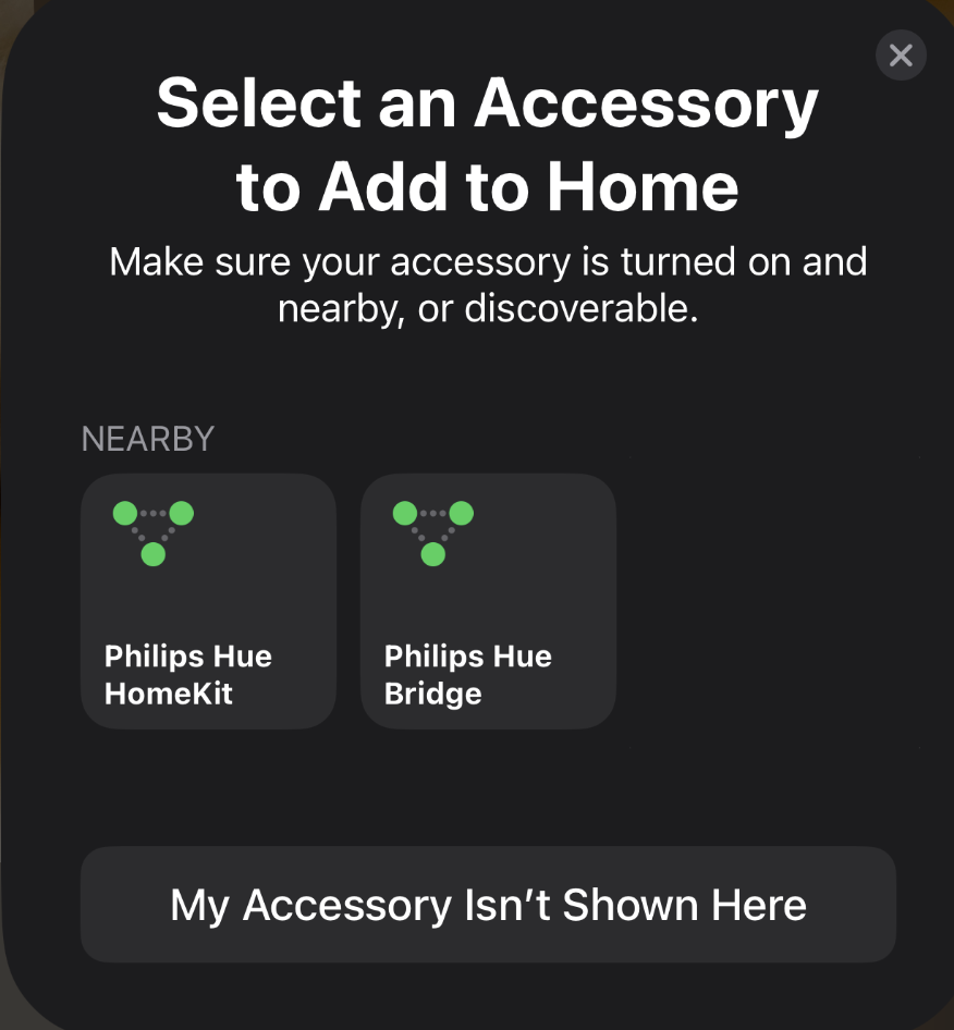

I just tried to redo mine and I got the same message. I even power cycled the bridge to no avail. What I did do was go into the Home app and try to add an accessory. Once I saw that Home found the Philips bridge I canceled and went back into the Hue app and only then was I able to complete the process. Once I readded my lights to the rooms I saw there was an update to my bridge.

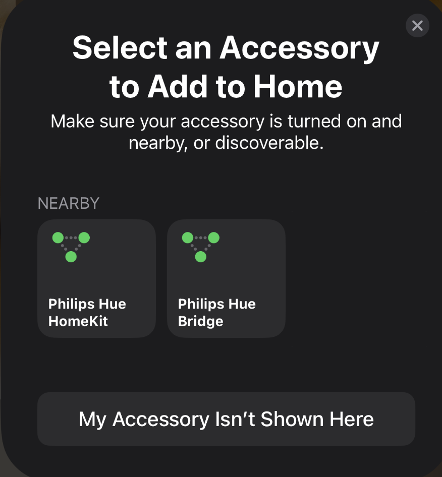

How did you do that? I have tried scanning the code on back of hub as well as look for nearby accessories and it still added it as "matter".
You have to go to hue app and add but then not select siri/apple home, select other, which leads to putting the device to pairing mode and copying a pairing code. Then you can use Apple Home to add it via camera. There you can select to add the Homekit version.
