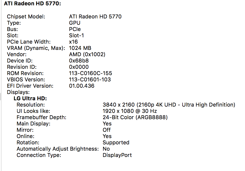

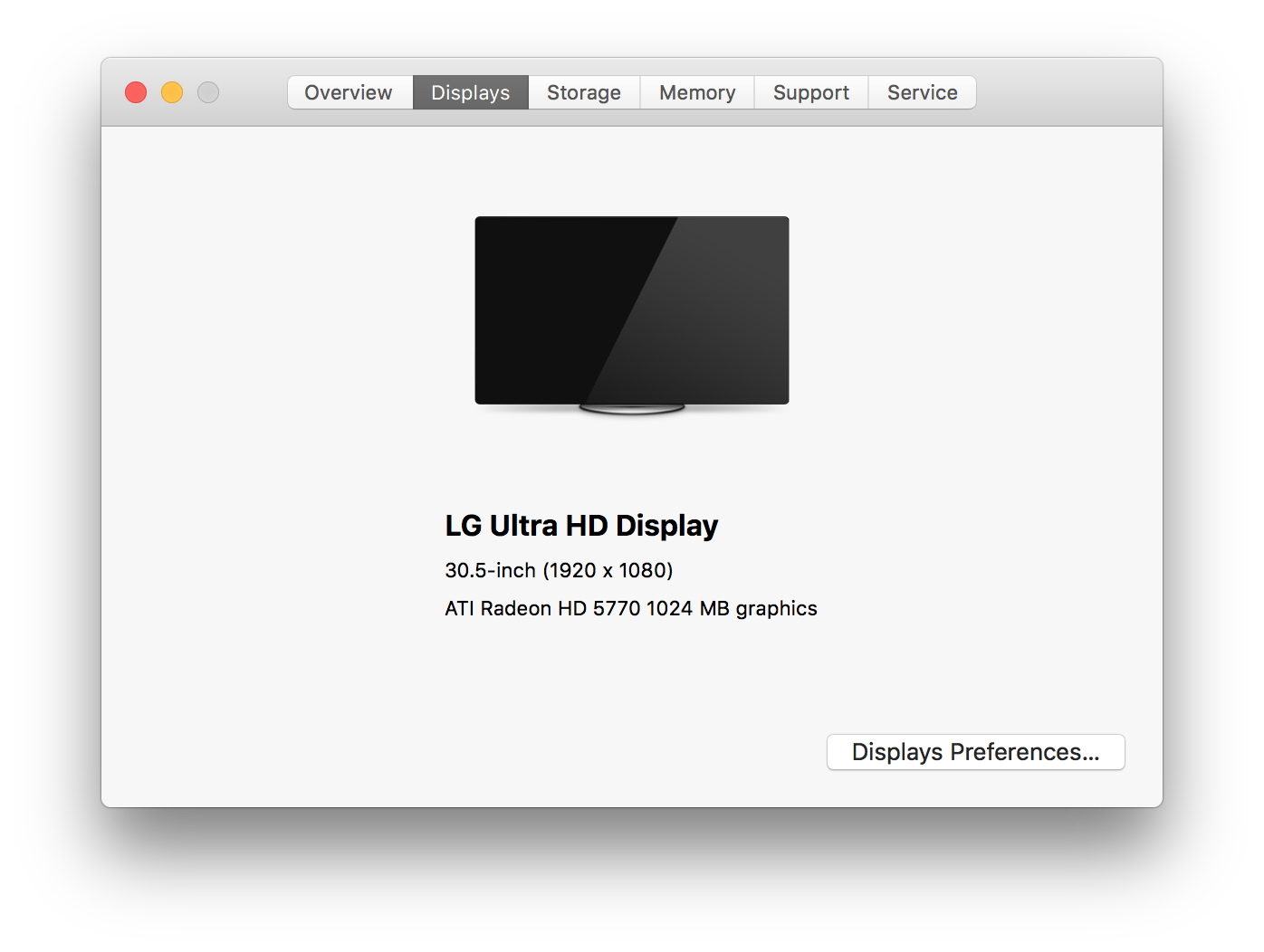

I also have an old ATI Radeon HD 5770 1024 MB which has no issues in getting detected.

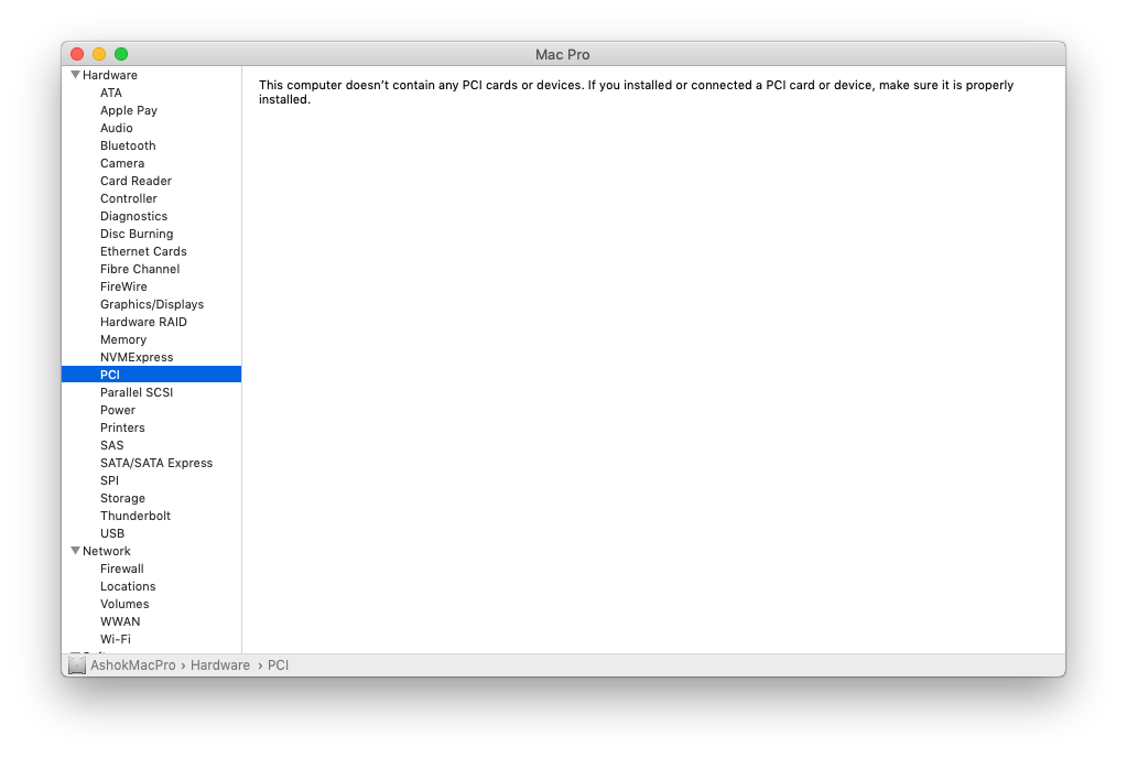

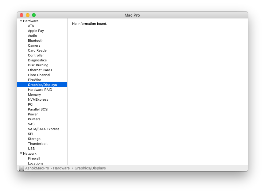

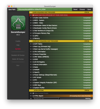

Tried this tip. Still no-go.

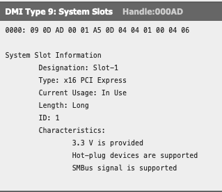

The PCIe slot-1 is currently in use:

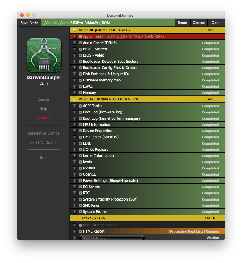

Delete the DarwinDumper file you uploaded, your real BootROM is there. Your BootROM image is trash, multiple PanicLogs.
From the biosbackup.rom I can see that you did not flashed the MP51.fd, or flashed back your backup.
Run DarwinDumper again with the MP51.fd flashed to your Mac Pro.
I reverted back, noticing that flashing had not made any difference. Will flash and do a Darwin dump and report back. Thanks for your patience, appreciate you taking the time to address this.
