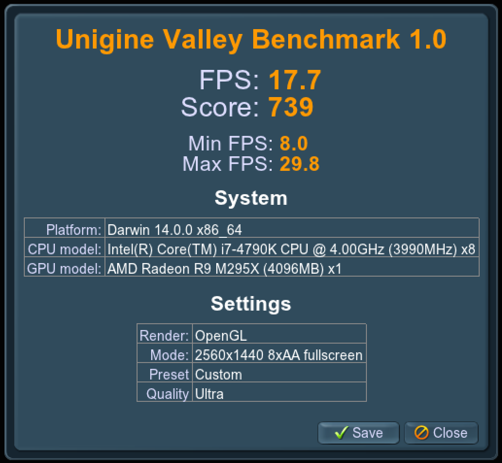

I ran it at the default resolution first and it didn't get above 100 and voted in the poll based on that. I then noticed you asked for the higher res, so I re-ran the benchmark. It got to 101.
I have the 1TB SSD if it makes any difference and 32GB of RAM.
i let it run 20 min the max temp i got was 100 degrees. fps 17.9 score 745
i7 r9 m295x 32gb ram.
So far no one reached the 107 degrees Celcius mark that is considered the throttling part. I wonder if the benchmark is hitting the GPU high enough? I would imaging it is...

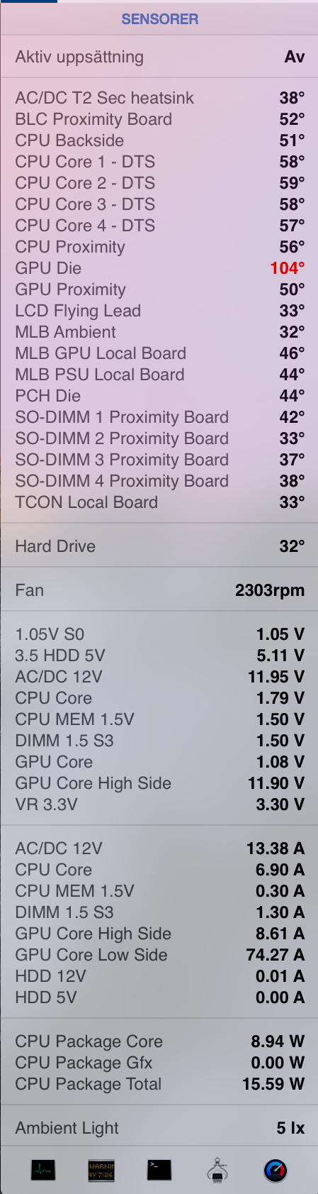

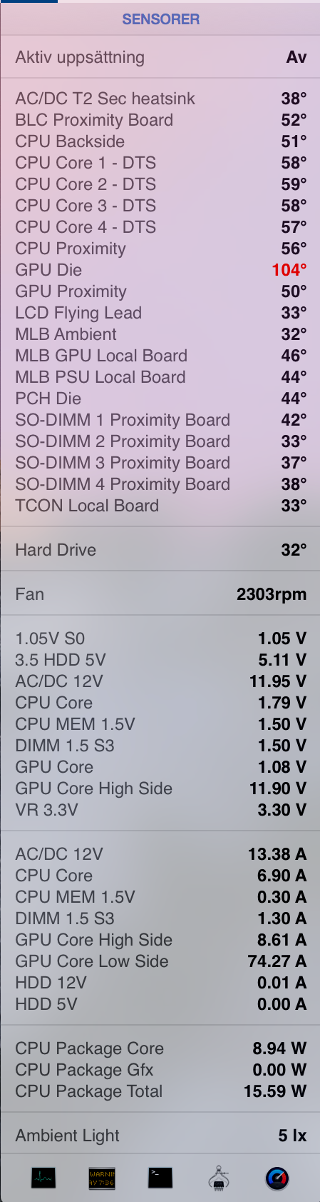

Consistently 105-106, occasionally 107 degrees celsius.
22 degrees ambient. 2303 RPM.
i7, M295X, 32 GB, 1 TB SSD.
Edit: Sorry, that was with 2560x1600 resolution. With 2560x1440 it is 104-105 degrees consistently.

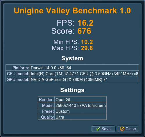

Just out of curiosity I decided to run this benchmark on my 2013 iMac i5 3.4 nVidia 775M with all the same settings you guys suggested.
GPU temp according to the program hovered around 80c (82c max) so the fan never increased from 1200rpm.
That I don't find surprising. What I do find surprising is the results of FPS and score. Shouldn't you guys be in an entirely different ballpark? Did I test something incorrectly?

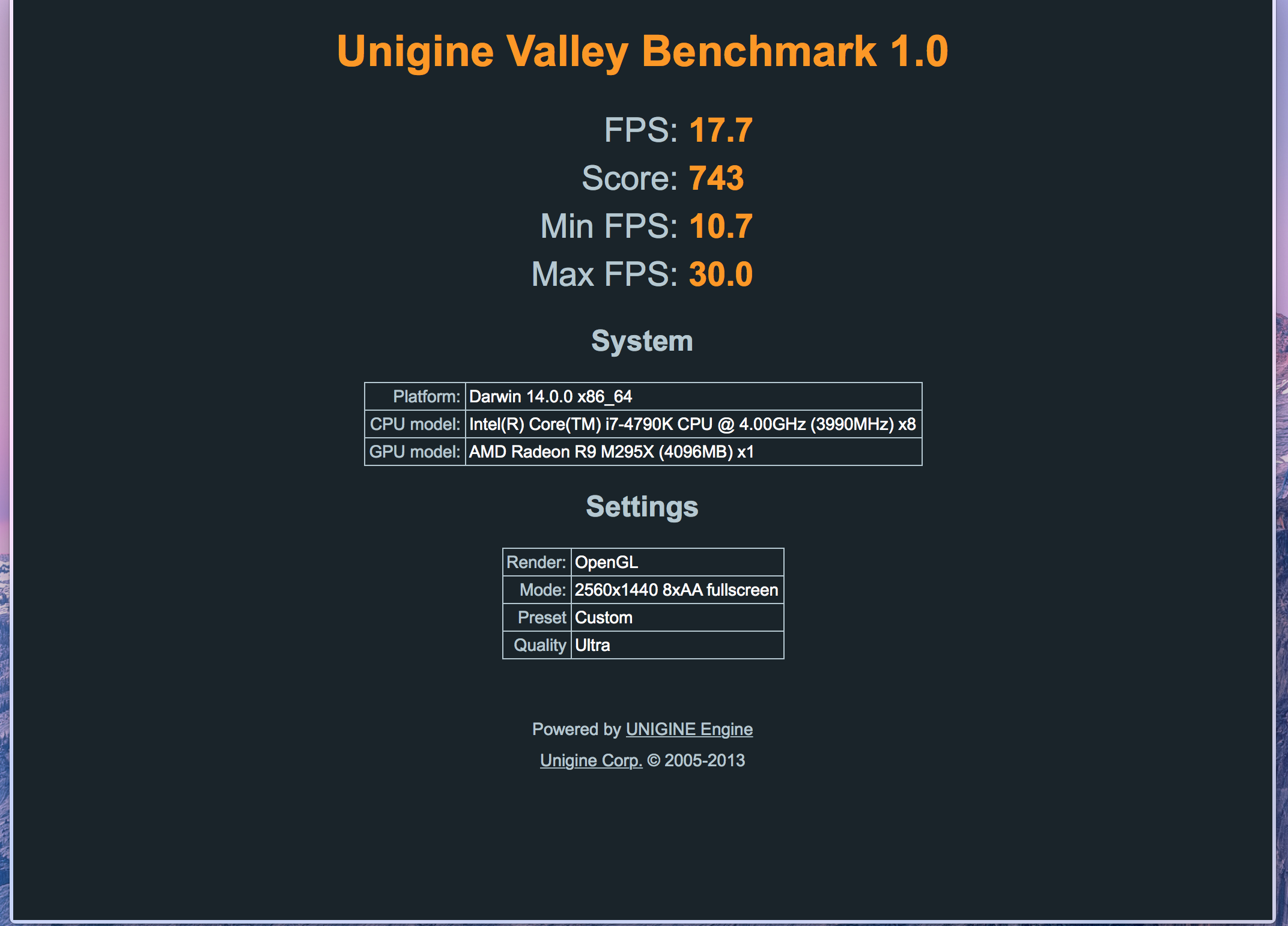

rImac, R295X 4GB, 32GB RAM, i7, 3TB Fusion Drive here.
The temperatures never exceeded 103C. Actually it was changing between 102-103 degrees most of the time.
I ran the test two times in a row for about 7 minutes.
Here's the screenshot of a second test.

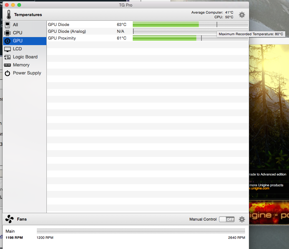

To note I use TG Pro for temps and the 82c I saw in the benchmark program was also reflected in TG Pro at 82c.
Its curious iStat would display differently unless it using a proximity sensor or an average?
EDIT: Took some screen shots.
Waited for the benchmark program to get to 80c.
I couldn't get out of the benchmark program fast enough to get a live temp so I reset TG Pro maximum recorded temps before running the benchmark. So you can see it reports the max it got to was 80c.
And of course the fan still putting along at <1200rpm.
