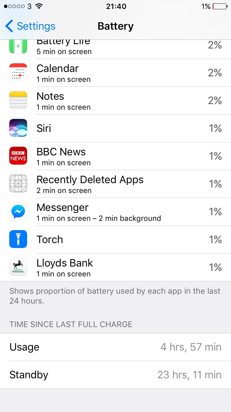

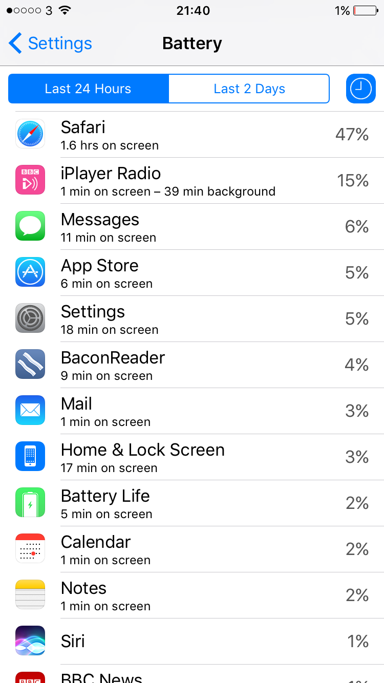

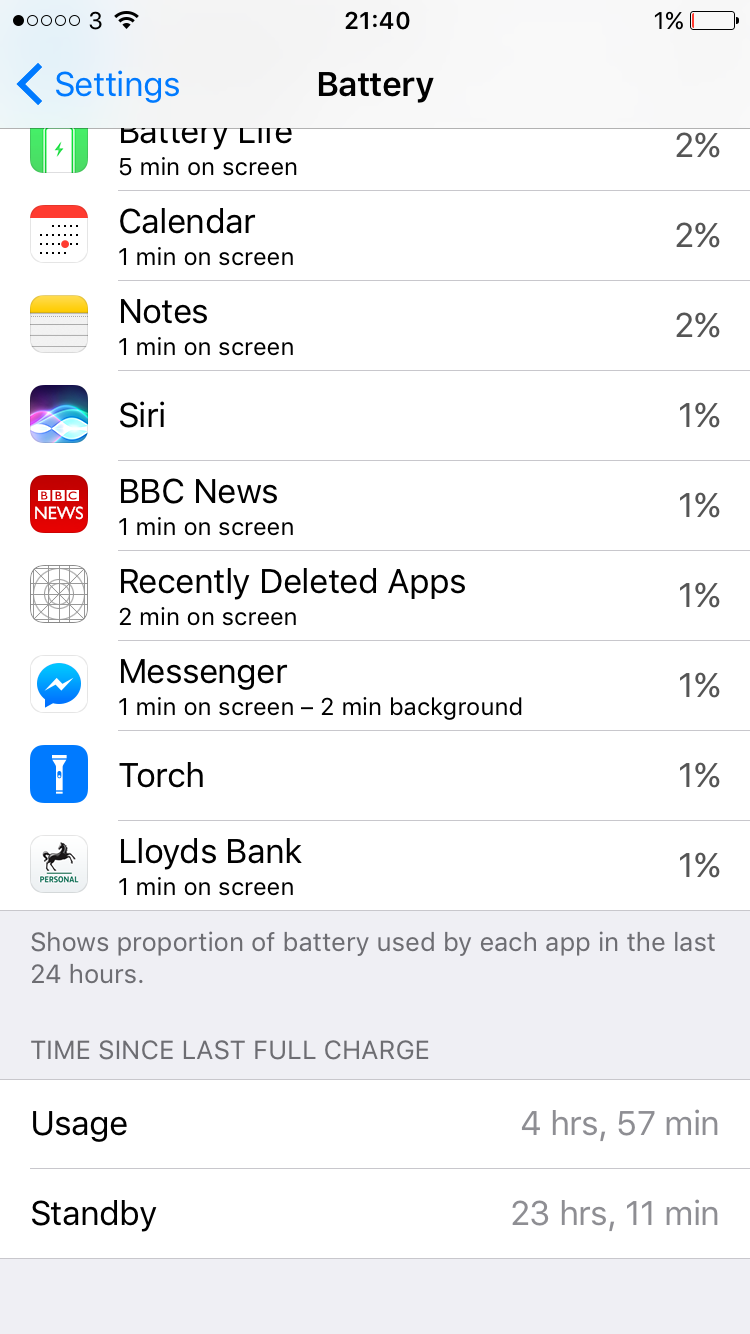

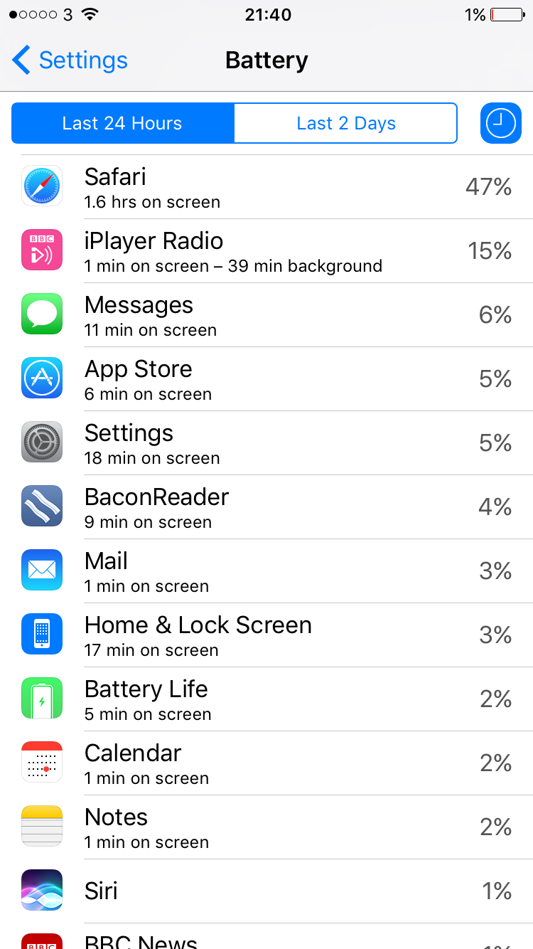

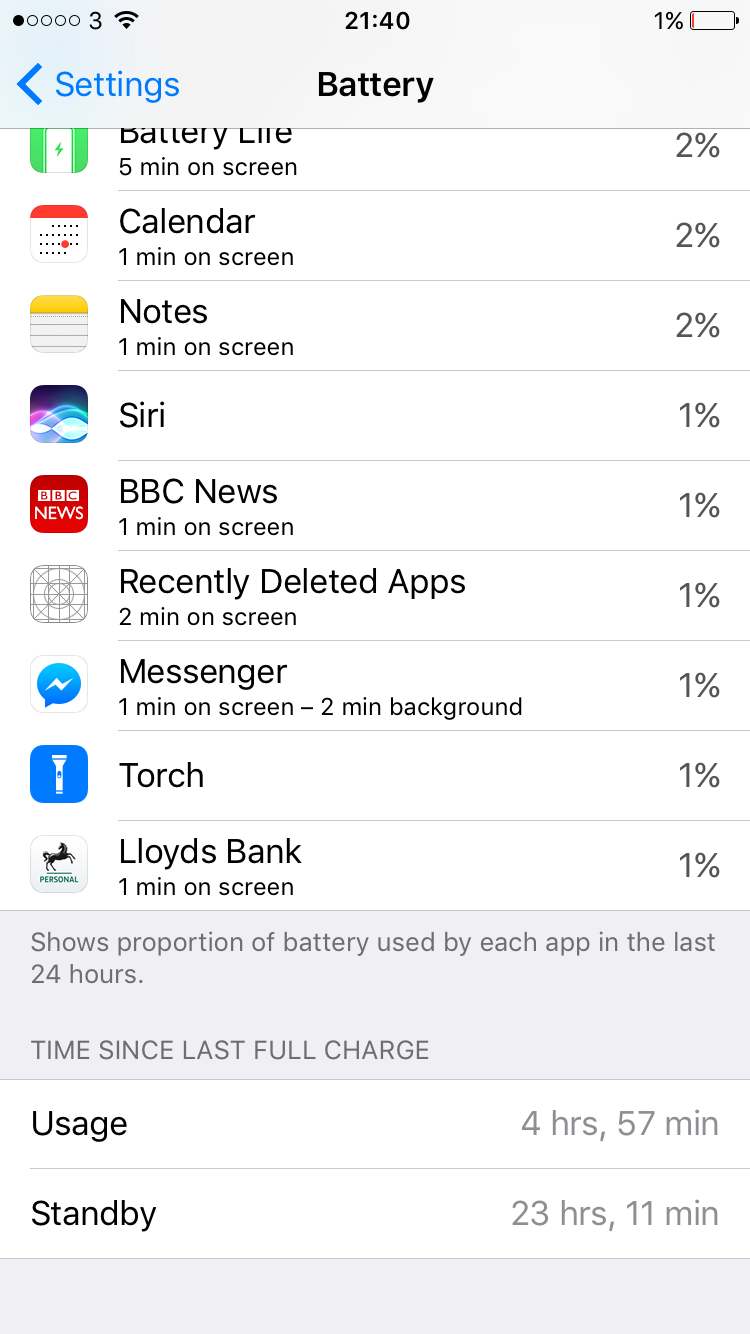

This is IDENTICAL to my iPhone which was bought on almost the same day and has all the same stats that you posted!! My current usage you can find below. I'm struggling to believe that our phones battery life is normal as loads of other people have posted amazing battery usage stats! Hoping someone else can shed some more light on this!
