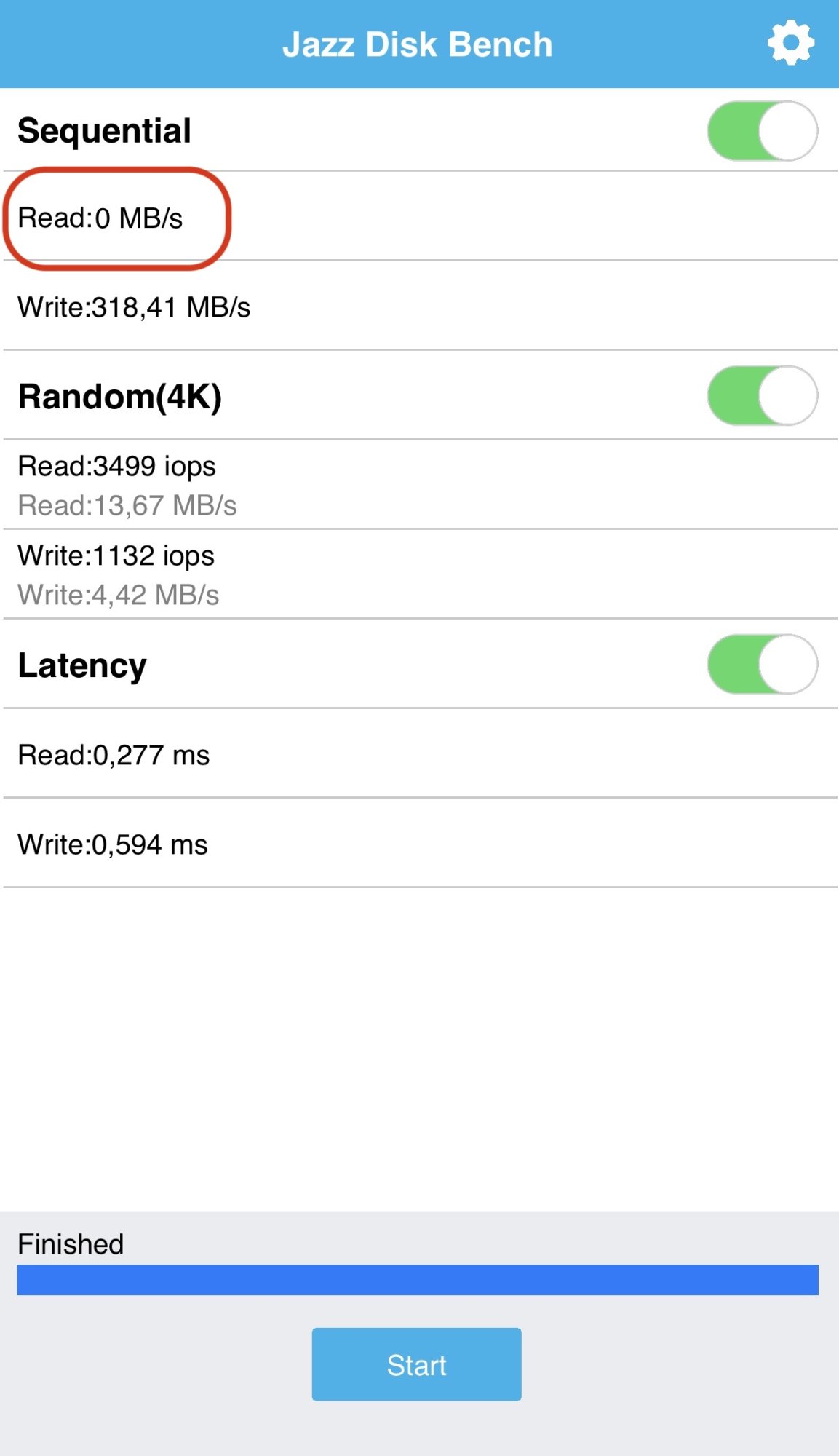

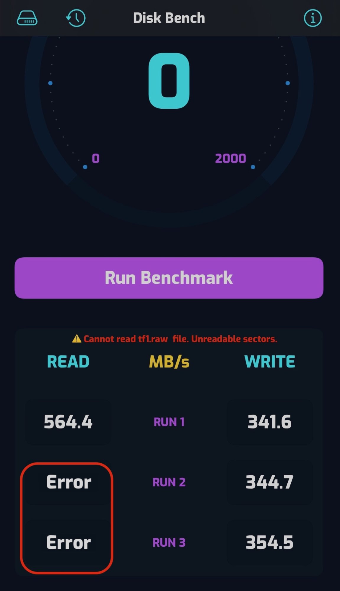

My iPhone 7 Plus has a strange behaviour.
Sometimes apps failed to open.
If they do, the UI is very laggy.
I am not a tech guy, but I tried to investigate a bit.
I found on the Internet that when something like that happens on PC, possible cause could be the hard disk.
I did some testing on my device disk and this is what I got:

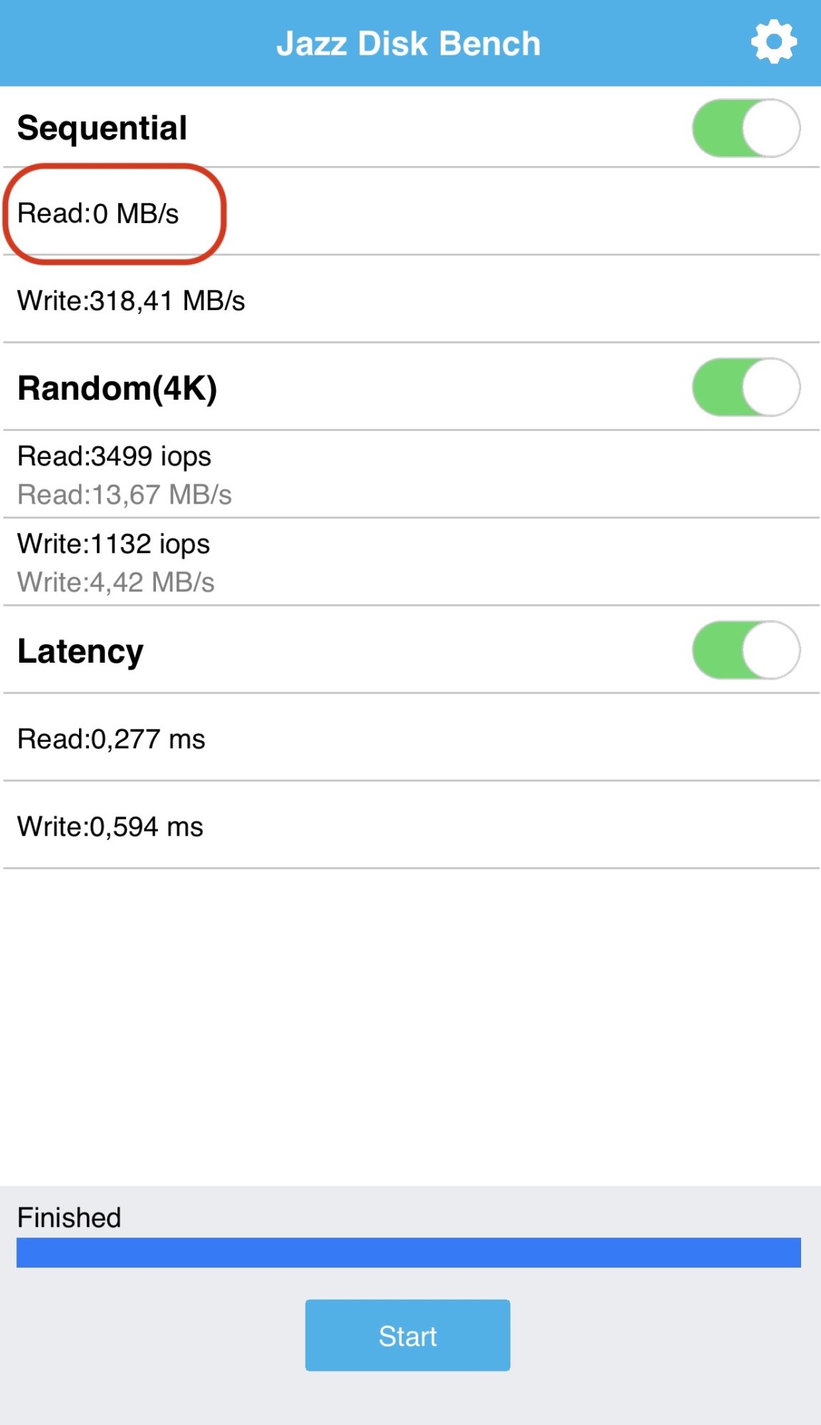

JazzDiskBench

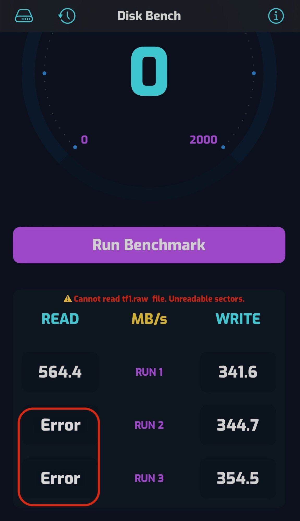

Disk Bench Pro
The problem is that 230 pictures which are visible in Photos cannot be backed up neither by iCloud or via iTunes backup.
Do you think if I go to a service shop somewhere they will be able to save my data?
Thanks a lot
Couple possibilities:
- how healthy is the battery? If it's 80% or lower, that can cause the major throttling.
- how full is the storage? SSD can have a severely degraded performance if it's near full. Try to have at least 20% of free space.
Best bet is to have Apple diagnose it.
All iPhones only use 1 NAND chip for storage. So, if it has indeed failed, hope you had a back-up.
Great suggestions! Battery has been replaced at a non-Apple service so I guess it's a chinese replica but still 100% after 5 months. Storage is 256GB of which 55GB are used. Plenty of free GBs.
Could be the battery though.
