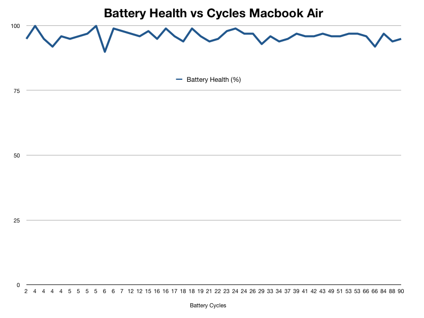

Results So Far
Big up to everyone that has submitted so far.
Have taken all the data and made a really simple graph Cycles vs Battery Health. Will try and update it if I get a chance if you post in some more data. So here it is (gonna have to click on it for a larger has come out too small on here!!):
So what do you all make of that??
