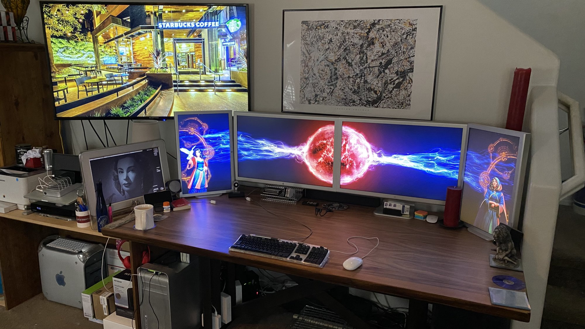

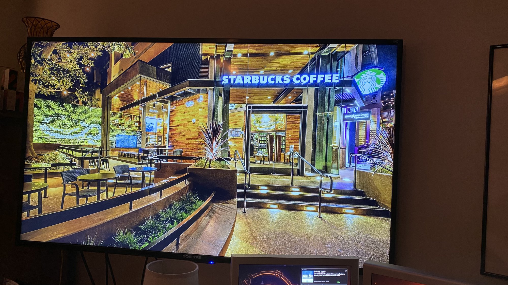

Still have not settled on a background for the HDTV. But this will do for now.
Note that this image was part of a Photoshop montage I made back when six displays were connected to either my G4 or my G5 (can't recall which). It would have been cut up for that, whereas this is the image without editing.

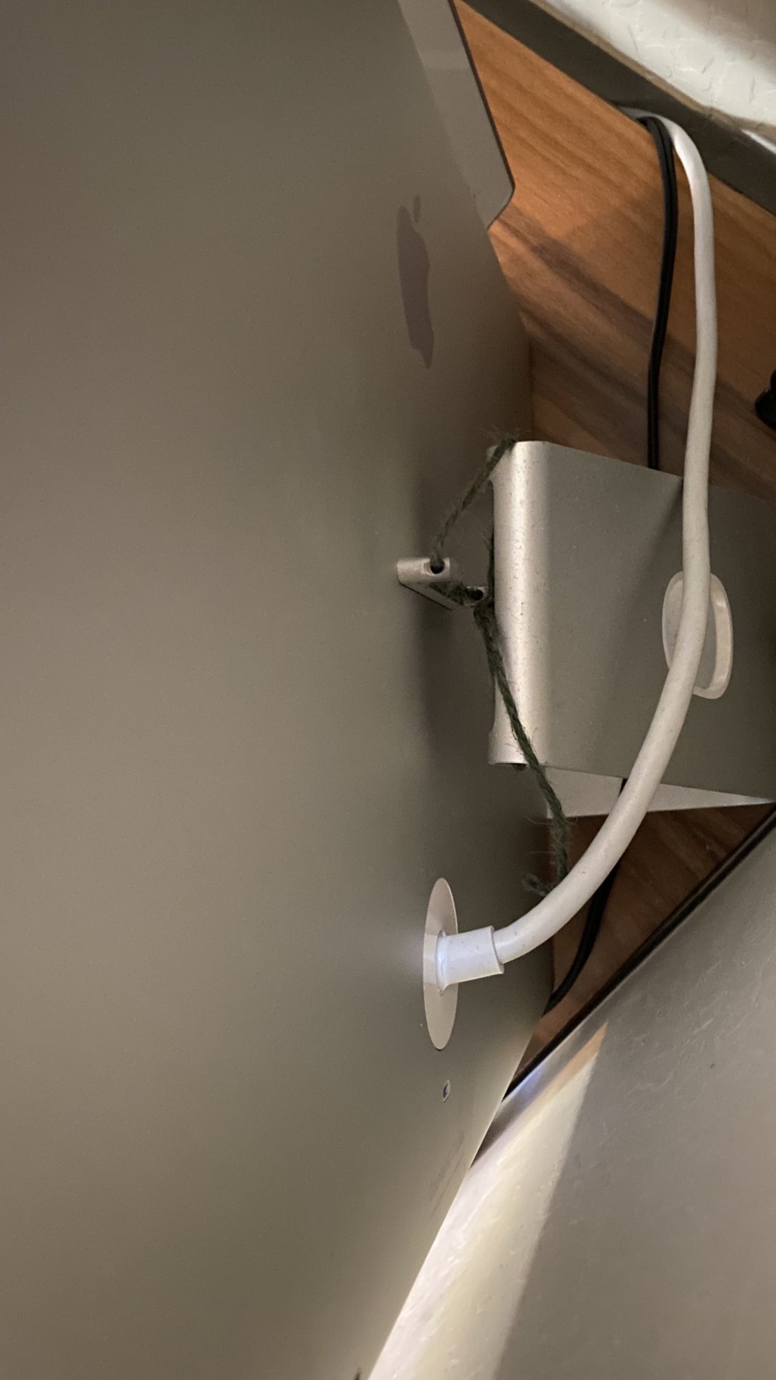

Incidentally, what stands are you using to turn your two Apple Cinema Displays vertical like that? I just got two of those older displays for free and was trying to figure out how you did that...
Thanks!

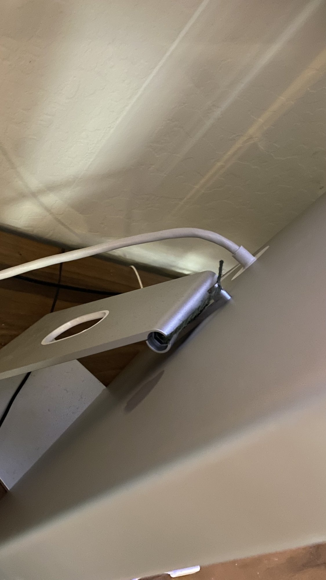

I am using the original stands. What I did was simply remove them from the hinge, turn them and then ran some thick string through the hinge and the hole on the back of the display. Then I just tightened it down and made a few knots. I was going to use wire, but I discovered that the wire I got was too thick to fit through the holes on the back of the display.
The string is simply there to prevent the monitor from falling forward. It isn't strictly necessary as the displays are leaned back at an angle. But if you have small kids or a high traffic environment (or bump the desk/table a lot) having something that keeps the actual display connected to the hinge (and thus the stand) is peace of mind.
Here's a thread I made on it: https://forums.macrumors.com/threads/vertical-cinema-displays.2290718/ Note that I borrowed this from another forum member here, who has since disappeared.

I did come up with the string though. I just don't like the idea of the display not being connected to the stand somehow. When these get moved (and they will at some point) I'll probably redo it with picture hanger wire. That should be small enough to fit through the holes. And I'll fix something that bugs me.
If you notice, both displays have the Apple logo pointed to the right. I need to flip the left display so the logo faces out like it does on the right. As I discovered, the slightly thinner bezel of the Aluminum Cinema Displays is on top, so flipping the left display has the logo pointing out and the thinner part of the bezel next to the 30" - just like on the right with the right 24" CD.

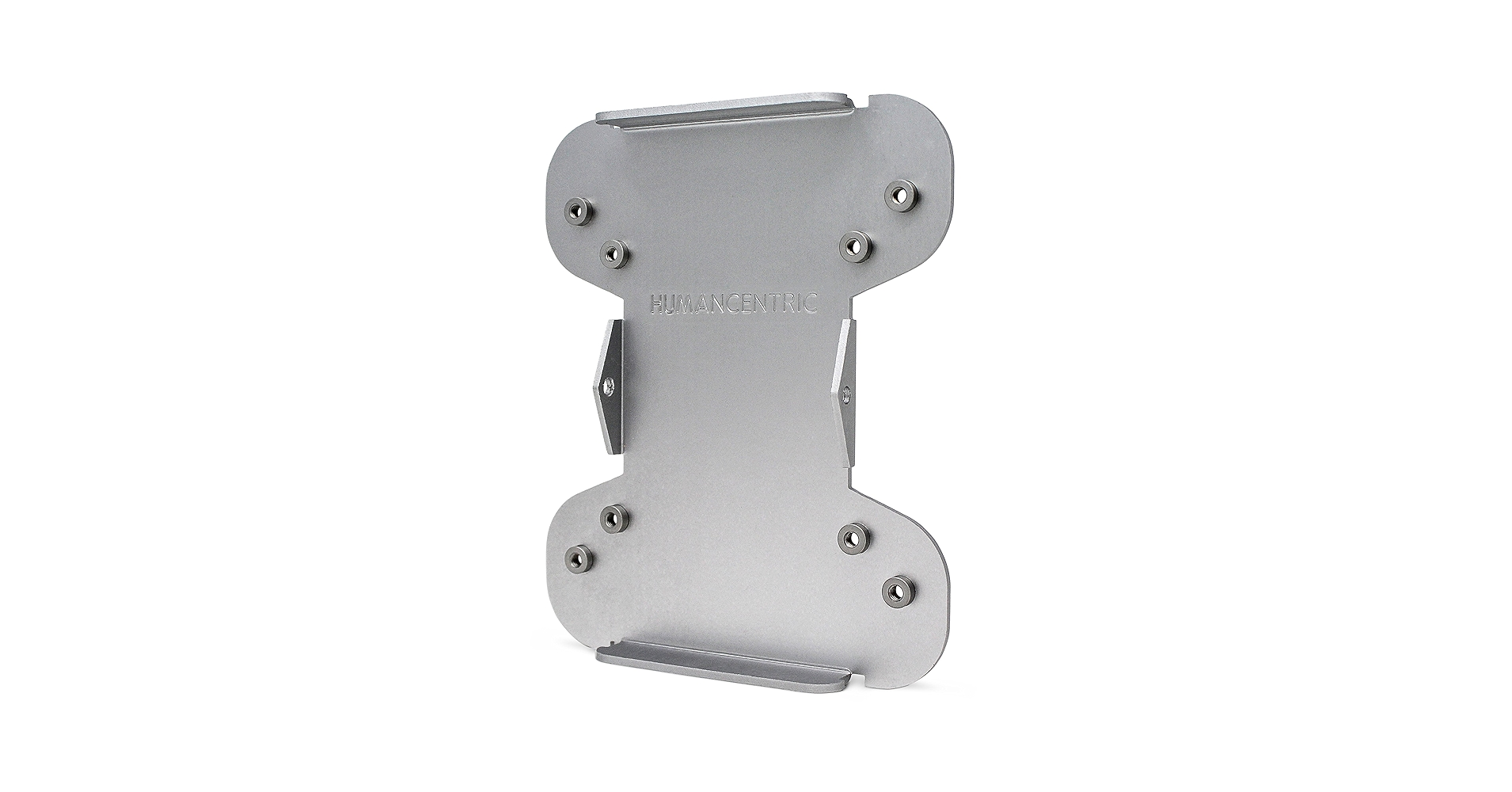

EDIT - Oh Wow, I guess someone did make an adaptor that would let you mount these things however you want...
Yeah, that's the VESA adapter I mention. I could have gone that route but it would have meant very expensive display mounts and VESA adapters for the two 30" CDs in order to make it all work with the one display mount I already had. Because if I was going to mount the two 24" displays I would have had to mount the two 30" displays to make it all uniform. None of the displays would have been as low as the are now and as far back. Half the table would have been taken and the TV would have been blocked.

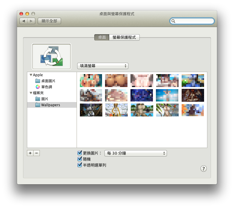

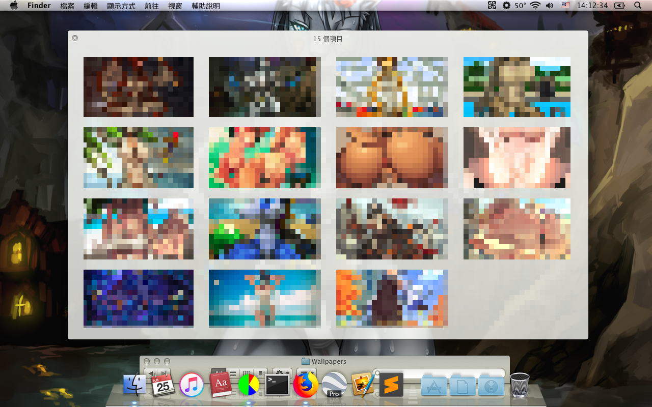

After re-installation, I use my own collection. Wallpapers not commissioned by myself are fully pixelated in the following screenshot.
I’m sorry. Even pixellated, my back now aches at the very thought of anywhere near that much impossibly cartoonish weight on my chest. Owww.
That’s what I meant. Negative joy, so to speak.
