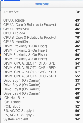

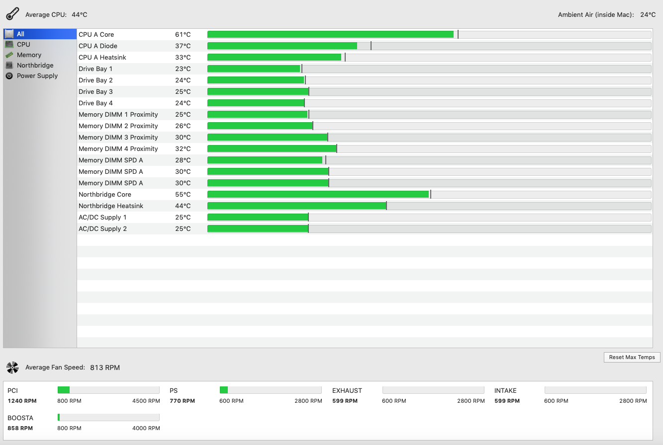

I have a pair of de-lidded x5677 CPUs in my 4.1 and CPU A runs at 49C and B at 38C idle.
Is that big a gap normal? I am thinking if I should redo the thermal paste.
Ran a CPU stress test to see what temps it goes up to. Maxes out at 70C for CPU A and 54C for CPU B.

CPU A is in the downstream of the airflow, 10C difference is normal.
What looks strange to me is the PSU temperature. Do you have something installed in the optical bay? The PSU 1 temperature is exceptionally high. For iStat, the PSU 1 temperature usually few degrees lower than PSU 2 temperature. From other software, which define PSU 1 as the PSU ambient temperature, and PSU 2 as the PSU component temperature. And in my experience, a dusty PSU (or something in the optical bay block the airflow) may cause the PSU 1 temperature very close or equals to PSU 2 temperature, but I never see anything like yours. For me, it looks like you have something in the optical bay which will general heat as well (another PSU?).
Of course, it can just be a faulty sensor, or the calibration is wrong. Or another version of iStat which read the sensor in different order.
I have 2 super drives and the PSU is the only part I haven't removed, opened and dusted.
If it looks really high then I will get to it ASAP.
IMO, it's hard to tell. They all have different meaning and may indicate different problem.
e.g.
1) Diode hot but heatsink cold -> may be poor thermal paste application.
2) Both Diode and heatsink hot -> may be a dusty heatsink / poor ventilation.
3) CPU diode cool, but northbridge core hot -> may be the rivet broken.
Also, you can't just focus on one temperature and decide if the machine is good or not. And in different condition, the focus will be on different variable.
e.g.
a) In a hot day, under light loading -> may play more focus on the northbridge temperature
b) In a hot day, heavy loading -> may play more attention on the CPU temperature
Anyway, that "CPU A Core" is NOT the actual core temperature, but "how many more degrees to core can go", which means the higher the better, and zero is the worse.

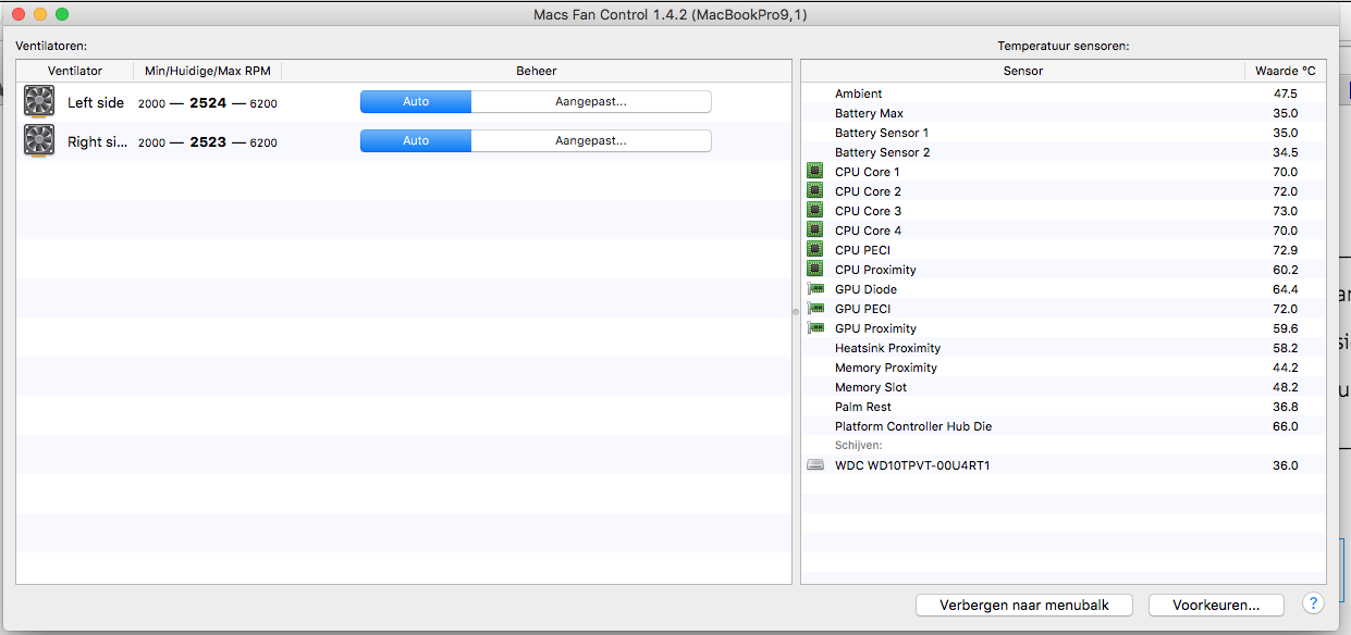

Hi @h9826790,
Could you please advise me for making the settings for a Mac Book Pro 9.1 (mid 2012) for the Mac Fans Control app? As I don't own a MBP I can't tweak the app myself, but I'm trying to help a fellow member on a Dutch forum. When he's making a back-up his temps rise to ~95*C, what is the best tweak to keep his MBP cooler. Which settings in the custom section would you advise for both the right and left side fans.
Your input would be much appreciated!
Cheers

Hi @h9826790,
Cheers
Sorry for the late reply. I don't have this Mac either. So I can't test the setting and give you any safe suggestion.
However, I will suggest those owners did some test before they make the custom fan profile.
Firstly, they need to find out which fan regulate which parts' temperature.
e.g. if left fan regulate the CPU, and right fan regulate the GPU, then it's not too hard to customise a fan profile base on the CPU / GPU temperature.
On the other hand, if one fan regulate both CPU and GPU, then it will be very hard to customise an automatic fan profile that safe for both CPU and GPU

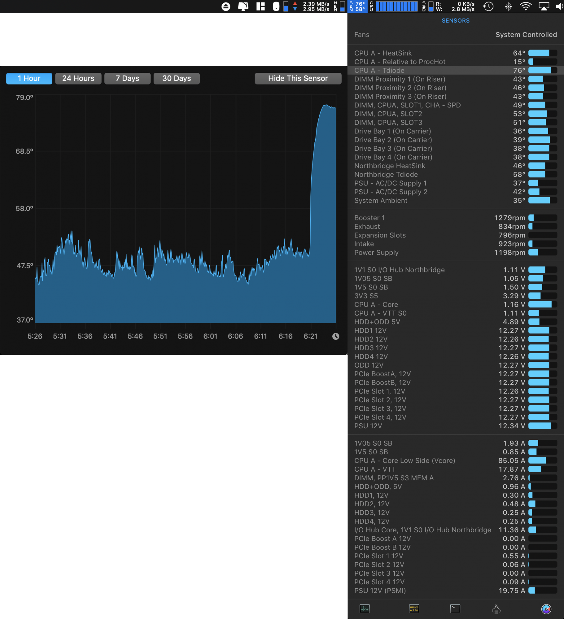

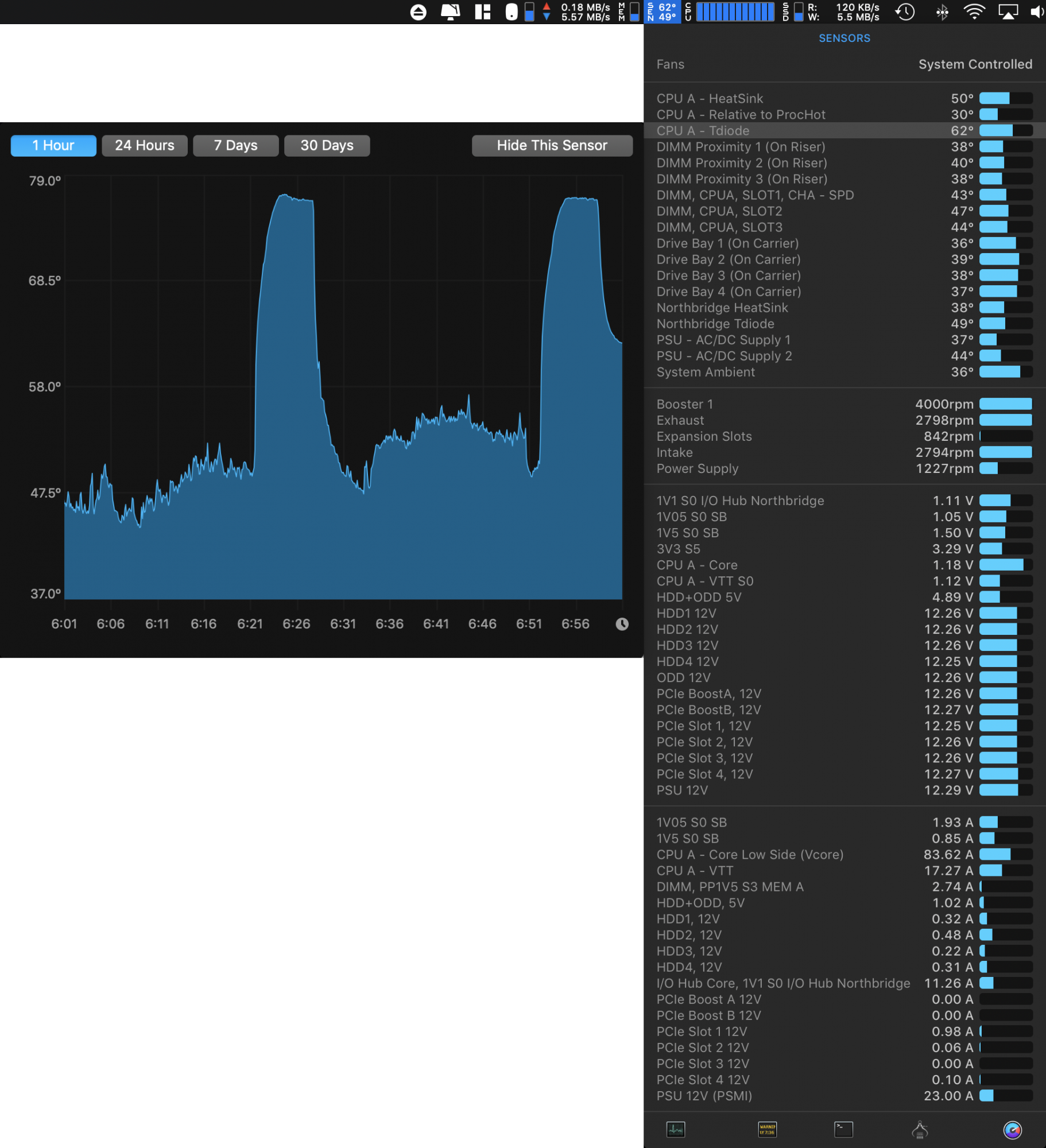

MP 5,1 still running good; OSX 10.14.6 / Boot ROM 144.0.0.0.0
Curious to see if I upgraded to OSX Catalina if it would have any impact on MP temps. Thoughts?

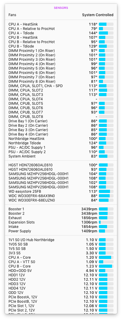

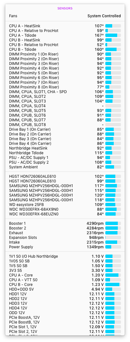

De-lidded dual X5680's busily working away on a 4,1:
All temps are Fahrenheit.
TBH, looks quite bad to me, not because the temperatures are dangerously high, but the fans’ speed are to high. And the delta temperature between heatsink and diode are too large.
If the cooling system is working properly, the delta T between CPU diode and heatsink should be well within 20°C.
If you spin up the fans to max, the CPU should be way cooler than that.
If you delidded the CPU by yourself, and didn’t clean those silicon seal completely. You better not to install that black plastic spacer. Which will increase the gap between the die and the heatsink, causing poor cooling.
For info, these are some references for you.
Using Prime95 to stress the CPU for few minutes. Even my system ambient is 35°C, my CPU still able to stabilise at ~75°C with just a bit above 1000RPM (booster, Intake and Exhaust still below 1000RPM). If the system ambient is 28°C, that will be even lower.
For max fan speed, the CPU diode should be much cooler. And as you can see, the delta temperature between CPU diode and heatsink should be way below 20°C.
Reactions: flyproductions

TBH, looks quite bad to me, not because the temperatures are dangerously high, but the fans’ speed are to high. And the delta temperature between heatsink and diode are too large. If the cooling system is working properly, the delta T between CPU diode and heatsink should be well within 20°C.
I agree with you that my temps were looking pretty bad. I took the black spacers out and scraped some more solder off the cpu dies to make sure I was getting nice contact and reapplied thermal paste. After doing this my temps have changed to the following:
I am a little concerned about the CPU A is at 144°F and CPU B is 129°F but I'm hoping that is explained by the fact that hot air is coming out of B and going into A. I tried swapping the processors and the results were approximately the same. Overall I'm a lot happier with these temperatures and I'm able to encode 3 h.265 videos simultaneous instead of 2 before so thanks for pointing out that my temps looked bad.
The temperature looks much better now.
