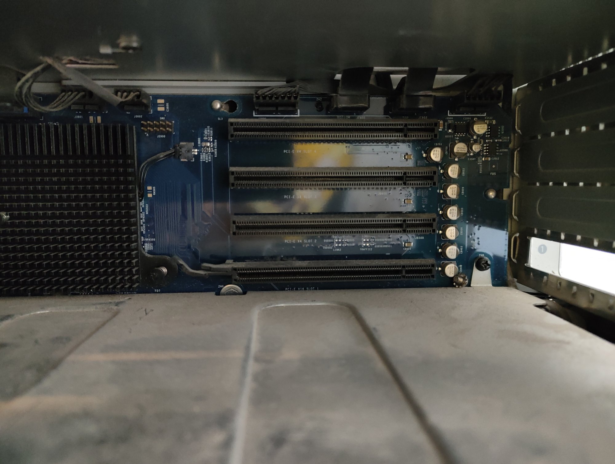

Someone has some wires crossed here.
If it is a 11.2 it is PCIe so you won‘t be using that AGP card.
If you plan to go MorphOS only get a RadeonHD card. There is separate thread dealing with that.

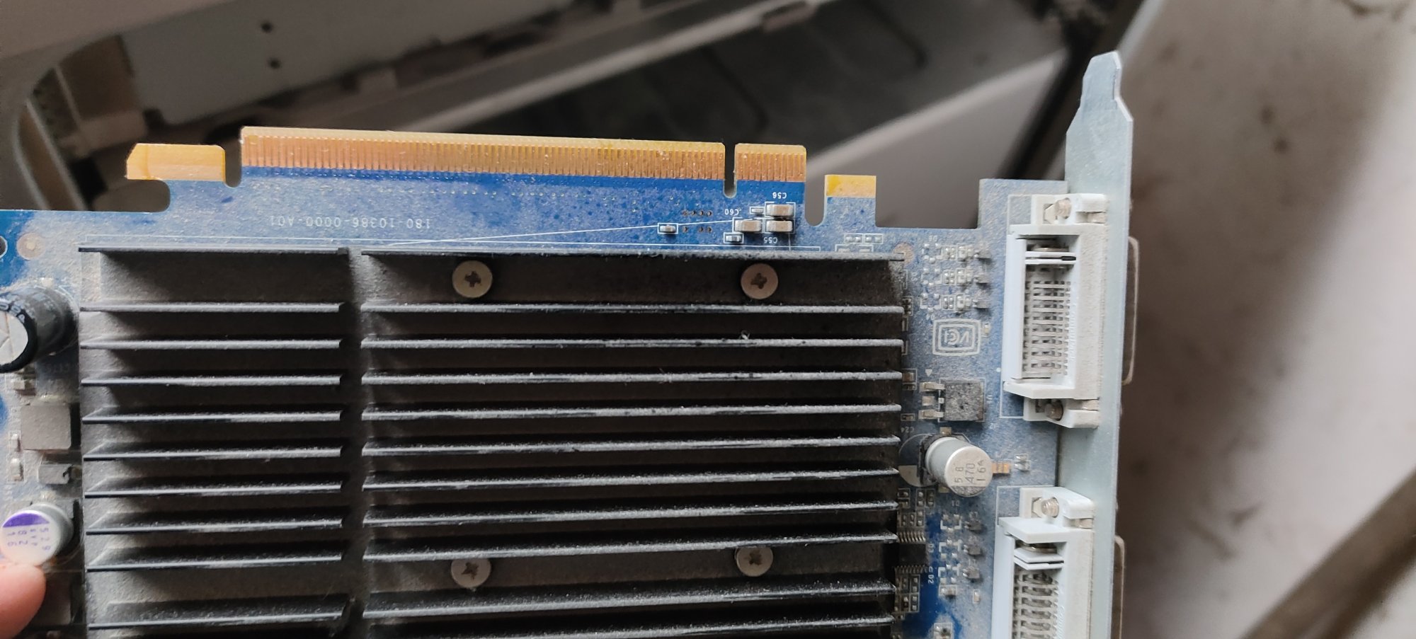

I went out and took a picture of the video card and motherboard sockets in the g5
Yeah, 11,2 is not an agp machine just like B-C wrote. Make sure you are looking at agp cards for that G4.

Unfortunately, as I look at it, it's even harder to find a video card for the g5 :(
