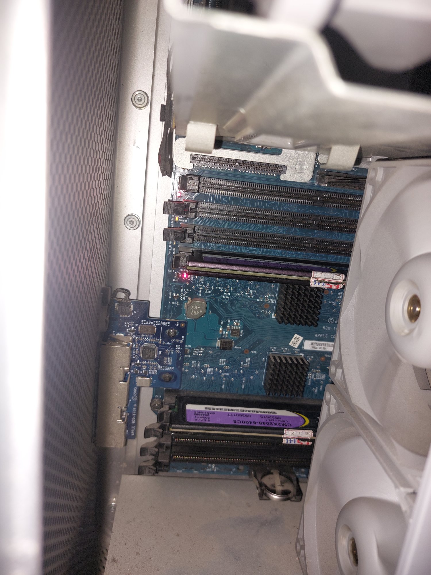

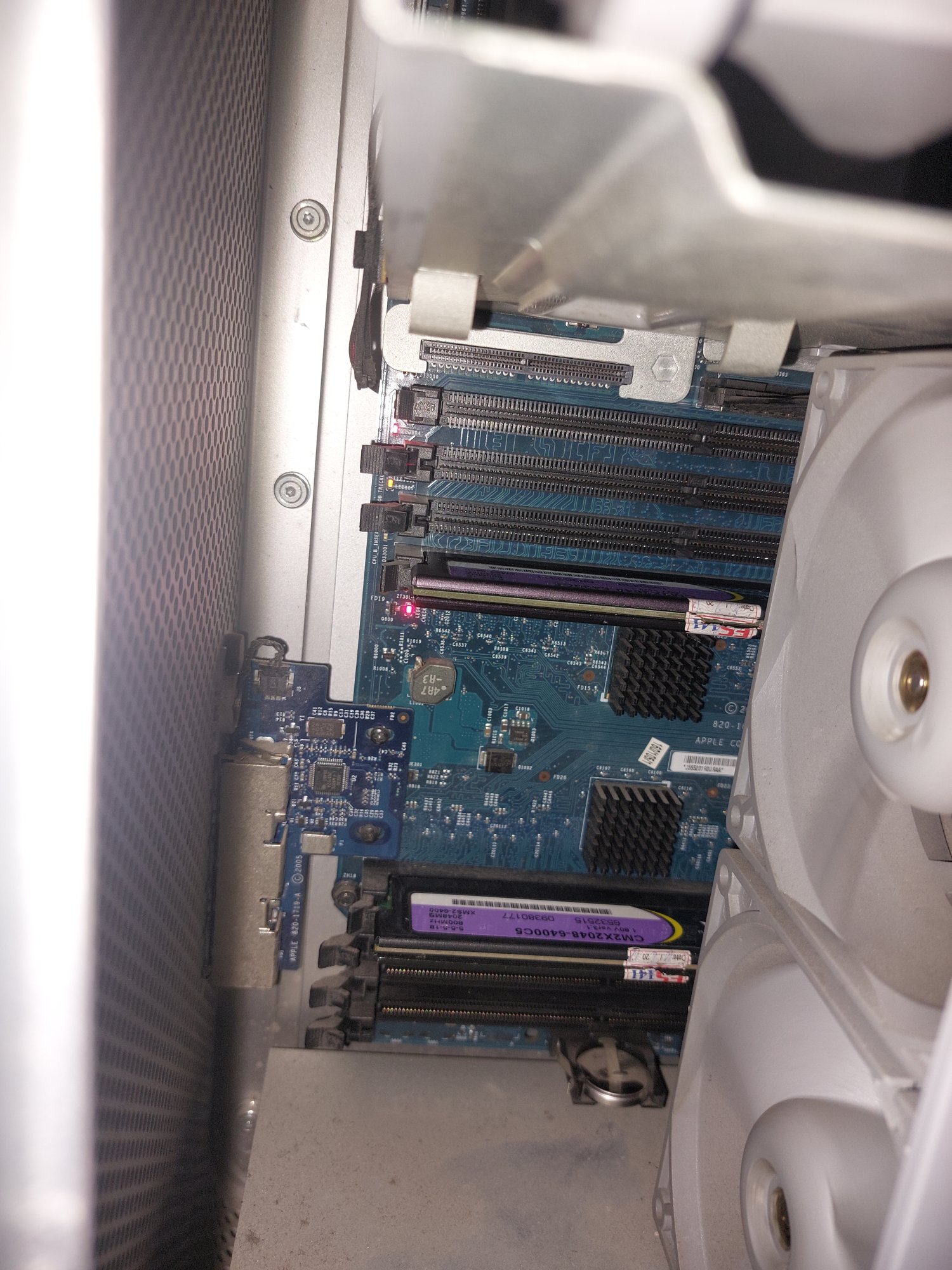

giathyex
macrumors newbie

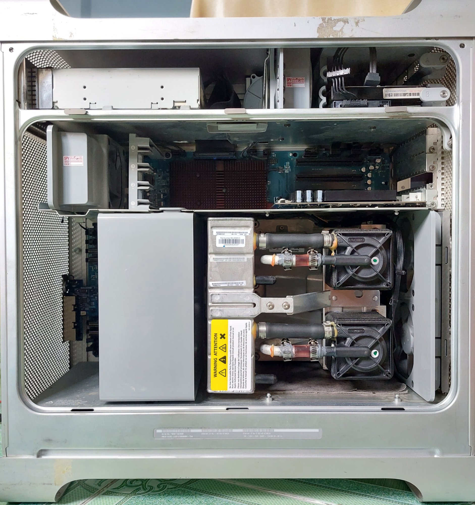

I have a PowerMac G5 Quad
I install a pair of 2GB DDR2-800 Corsair XMS2 Ram in the right slot (mirrored centermost)
At first, I got 3 beep and the fan start to spin fast
After some re-seat and change ram module, I got the boot chime
But a few second after the chime, overtemp led bright up, and led806 checkstop bright up too. It stucks at it and the fan start to ramp up faster and faster. No display
So my G5 should be still alive and that is just some problem with the liquid cooling unit? Should I spend time to clean and rebuild the cooling unit?
Thank you for help

Yeah, I have cleaned carefully almost entire my G5 (except the PSU bay). Have not put it back together yet
I will try to repaste it and see what will happen. I will post my result here
However, I notice that if I leave my G5 for a while to let it "cool down", I will got the boot chime, and after that the overtemp light kick on. But if I just turn it of and turn back on immediately, the overtemp light kick on right away
This make me believe my G5 just got an temperature issue and not too serious logic board problem. I will try to perform the "new blood" mod on my LCS

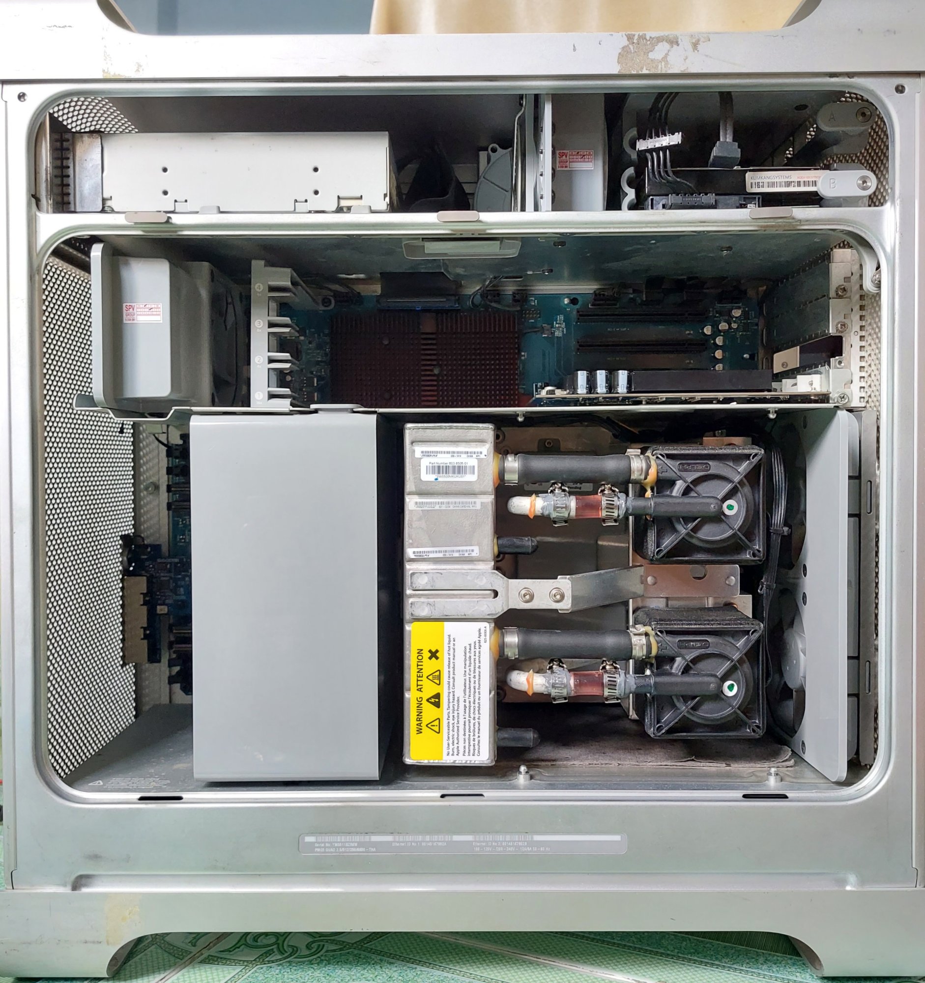

I have completely flushed the LCS. Now things get weird
After flushed and cleaned, the LCS works really well. Before I cleaned it, only the input port of the pump gets hot, the output port of the pump and the radiator doesn't get hot at all. Now the whole radiator gets hot nicely after my G5 turned on for a while
The overtemp light does not turn on any more. I got boot chime everytime I turn it on. Really make some progress here
But still get no display, nothing happen after the chime
Maybe I will try to find another graphics card. If the problem still not solved, next thing I may have to do is run it with only one CPU

Yeah, I have tried different PCIE Slot. I even end up buy two another 6600LE (fair price) and still got the same problem. Boot up, got chimes, no display
For the LCS, I cut and remove these two hoses (with scissor, razor, cutting pliers), drain out old water, put vinegar + water 20/80 mixture in it, sealed and put the LCS in the sun for an hour
Then I run the LCS with the vinegar mixture using a DYI cable to get 12V power from standard ATX PSU
And then, I drain out the vinegar mixture, flush and run the pump again with clean water and distiled water. Finally, I put standard modern PC watercooler liquid in it and sealed back with two new hoses. You will want soft tubing (can buy from standard modern PC shop that sell custom watercooler) with inner diameter of 3/8" or 9.5-10mm
The hardest part in my opinion is to put new liquid in the LCS without letting air get inside it. I'm still kinda failed at that
And yes, I think the part of putting back the LCS same fairly straightforward as you mentioned. But you should be careful as I heard a guy on FB mentioned that he break something when he put them back (and I start to wonder if I have done something wrong and I dont even realize it, thats why my G5 is acting weird now and I kinda give up, looking for another working G5 🙂)

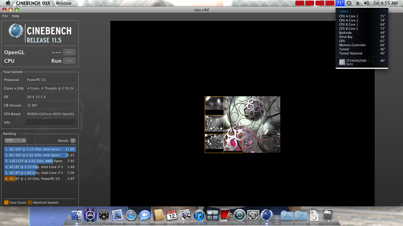

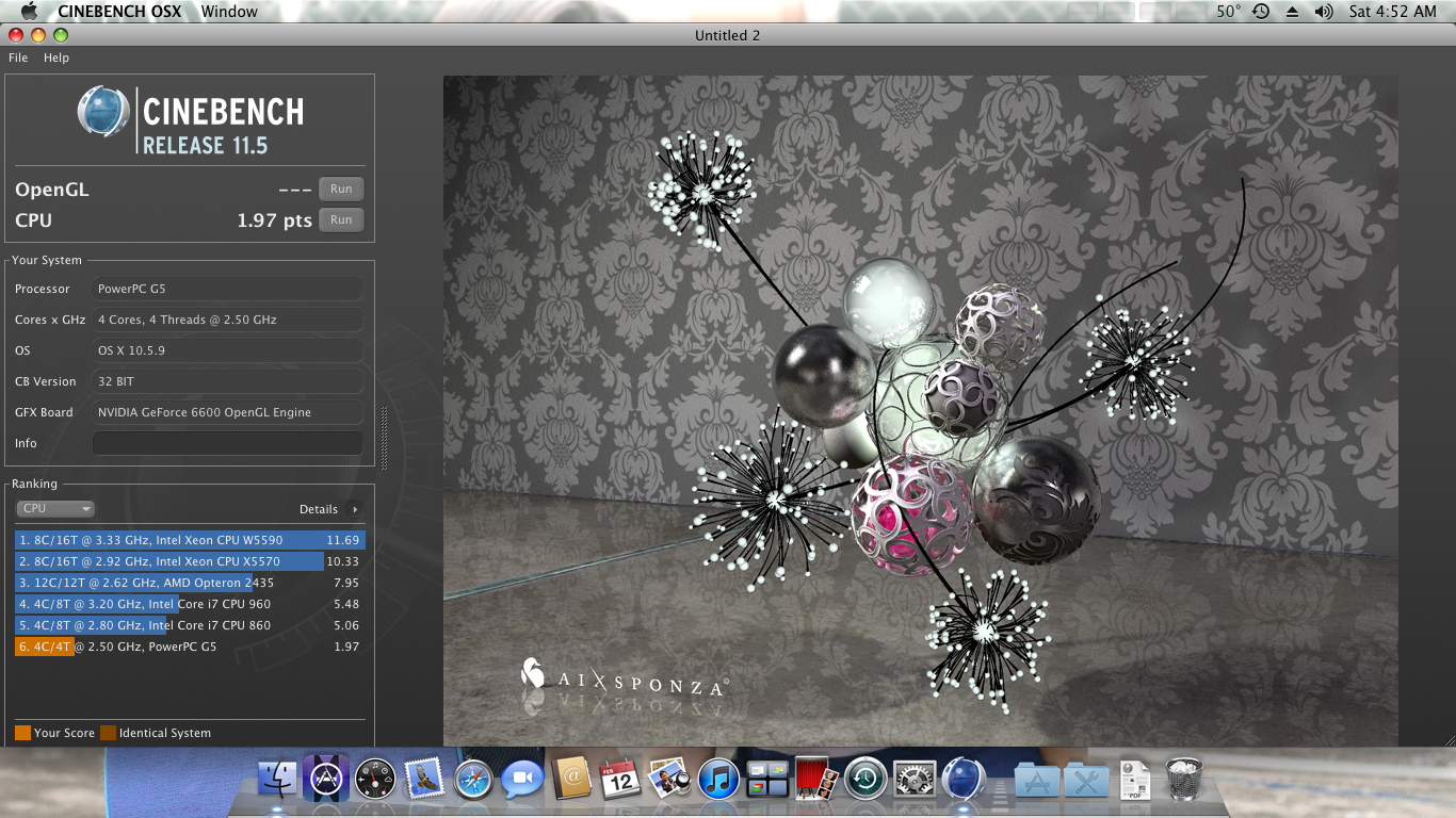

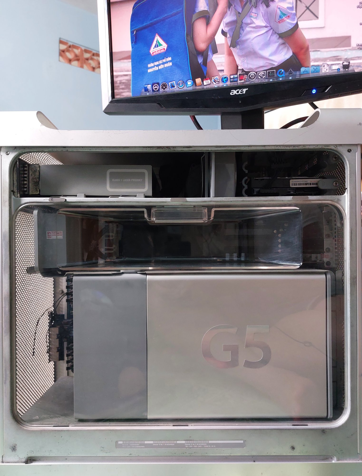

I'm back, I find another G5 Quad in my country that looks like having a PSU problem (when I press the power button, the red light bright up then turn off immediately).
I take it home, swap the PSU from my G5 at home into it. After spending a few hours messing with all GPU I got, finally I found one GPU that work. I got it boot up and run perfectly fine.
Temperature fine (my room is at 35°C), run smoothly without any interuption.
Now I have a working Q5 Quad and a whole G5 Quad with a bad PSU laying around for parts.
