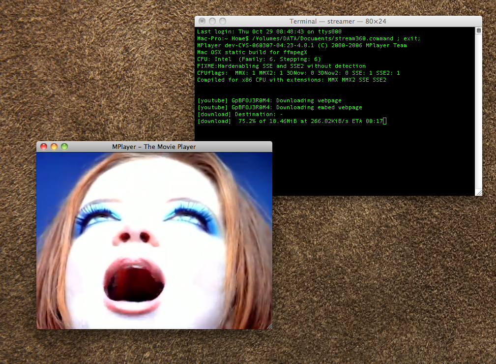

When I tried piping youtube streams into it the stream never started (same thing now happening with VLC 0.9.1). QuickTime remains working however.
It was working when testing PPCMC the other week - maybe a recent youtube change? Will test again later if I get time - either way, the time taken for parsing the URL on a slow G3 is pretty intolerable and more a POC at this stage.
EDIT: Old version still working with youtube-dl for streaming in Snow Leopard...
