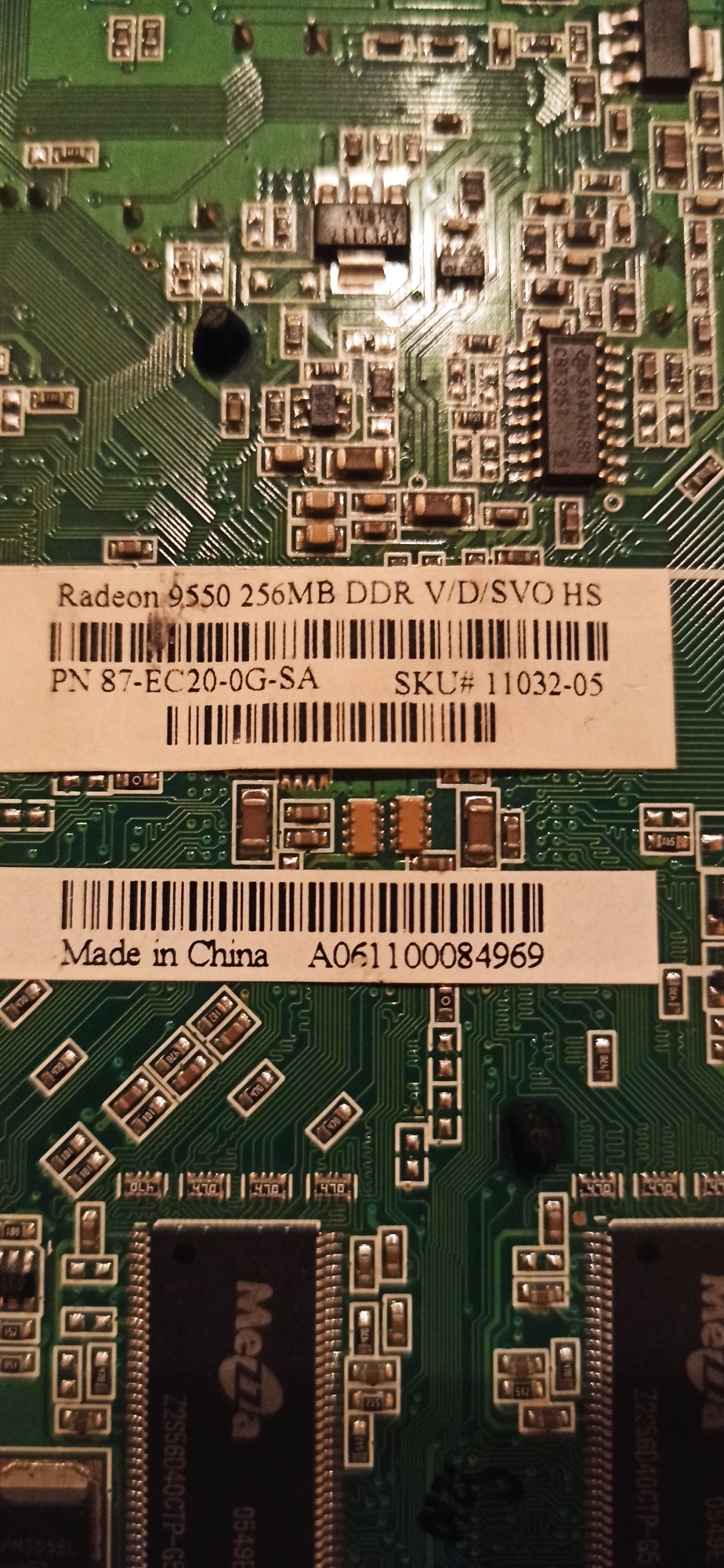

Thank you for your response. This is what I have:
The HD 2x00 and HD 3xx0 are out for OS X anyway as there are no drivers on PPC.
Thanks... That's what I thought too since they are newer models comparing to the G4, but it's nice to definitely scratch them off.
It is posible to get the GF5900 to work in a PPC Mac, but it's rather involved and takes a lot of FCode skills.
It seemed to be an under performer back in the day and a 6600GT AGP or 6800 AGP would be a far better fit. Tho some of these cards may have issues in a MDD for reasons we've never been sure that stem from the FCode used and the implementation of Open Firmware for the MDD.
I think the 6800's should work fine for the MDD, also maybe flashable without replacing the EEROM with a larger one.
Just about all cards from the PC side that can be flashed are going to require disabling pins 3 and 11 if you are looking at 8x AGP compatible cards.
I'd sell the 5900 and buy a card that is a good fit for your Mac. The Radeon 9600 Mac/PC can still be had reasonable if you look around. I have one I got NiB for not too much more than a used GF5900 sells for.
If you don't want to deal with pin taping and flashing it's not a bad card. There was also a Radeon 9800 256MB Mac card retail from ATI that is ready out of the box for the MDD, but they are rare in any shape.
Reactions: Amethyst1
