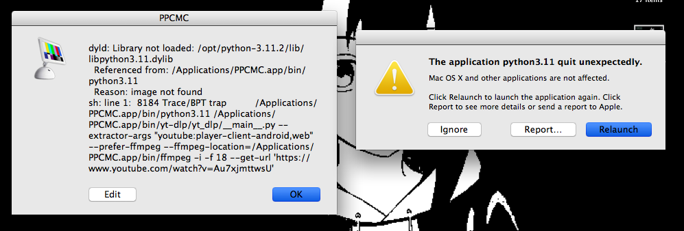

Should probably point out that the leopard.sh Python 3.11 is required, else it dies-- this hotfix is not self-contained, but it does work.

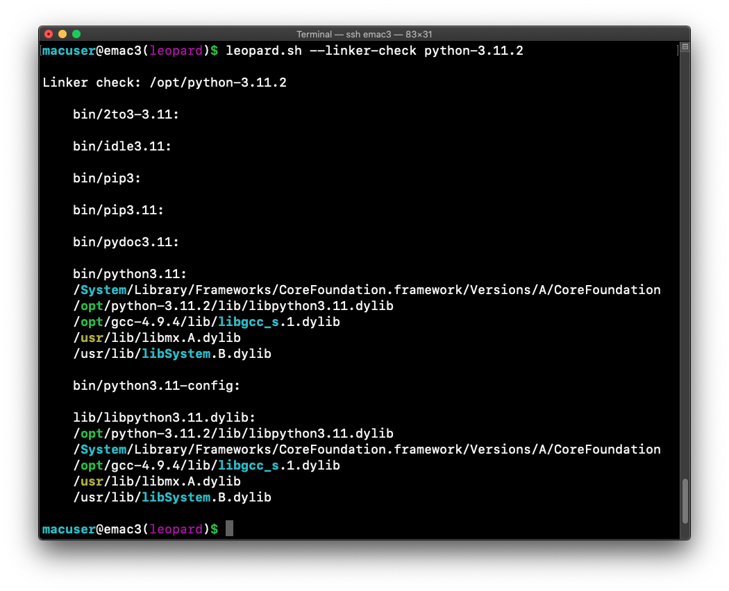

ehhhh yeah unfortunately the python-3.11.2 package requires a lot of dependencies, partly because it required gcc-4.9.4 to build.
If I wipe out /opt and then install python-3.11.2, here's what I end up with:
Code:
$ ls /opt/
ca-certificates-20230110 leopard.sh               openssl-1.1.1t
cloog-0.18.1             libffi-3.4.2             python-3.11.2
expat-2.5.0              libiconv-1.16            readline-8.2
gcc-4.9.4                libiconv-bootstrap-1.16  sqlite3-3.40.1
gdbm-1.23                libunistring-1.0         tcl-8.6.12
gettext-0.21             mpc-1.0.3                tigersh-deps-0.1
gmp-4.3.2                mpfr-3.1.6               tk-8.6.12
isl-0.12.2               ncurses-6.3              xz-5.2.5
However, you don't actually need leopard.sh to install any of this, you could write a targeted script which just grabs those packages.
That´s right. I didn´t notice because leopard.sh was already installed on my machines. It seems that the Python 3.11 executable points to some libraries at /opt. The original Python 3.6 exec in PPCMC points to /Applications/PPMC instead. So you need leopard.sh for this hack to work.

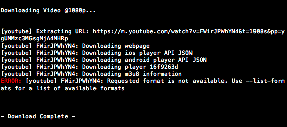

There appear to be more and more videos now which yield the following error when attempting to download with the 1080p preset in PPCMC:
The reason for this is because on some videos, there is no 1080p30 quality option available as you can see:
Can someone please walk me through how to go about modifying the PPCMC script to add a 1080p60 download option? I am not certain on this, but I believe the 1080p60 videos are still using H.264 as the codec, so ideally I would like the resulting file to be H.264 codec saved within an MP4 container if possible. The G5 Quad can surprisingly handle 1080p60 video using some of the more efficient video players such as VLC 2.0.10 and CorePlayer.

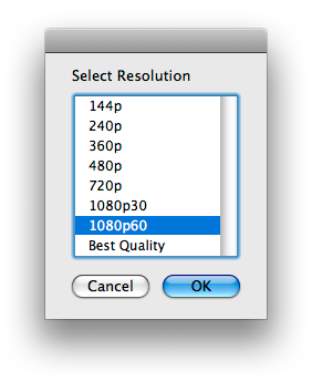

Thanks @Dronecatcher! The 312+140 format code you posted was the key to figuring this out as I was not too familiar with how to configure youtube-dl.
So I wanted to try and add this functionality while maintaining as much of the original script as possible in its stock configuration. What I did was modify 'main.scpt' which is the AppleScript file that runs the PPCMC GUI. First I revised the GUI to have two distinct 1080p options based on desired framerate:
Next, I copied the existing code used for the other quality settings and adapted it with your 60FPS youtube-dl format string. I really wasn't sure whether the resulting video downloaded from YouTube's servers would be encoded in H.264 format, but yes it certainly is!! This is so excellent!
I even modified the terminal outputs accordingly for the cleanest look:
If anyone wants this, I am posting my modified 'main.scpt' file. It should work as a drag-and-drop solution if you installed Python 3.11 using the method posted above by @cellularmitosis.
  • main.scpt.zip

PPCMC would pass on an error message from yt-dlp saying: "ERROR: Requested format is not available". I figured it was something after the -f argument that yt-dlp didn't like.
This was part of the reason why I edited the script to include a 60 fps option. I noticed that some videos are not available in 1080p30 but are available in 720p or 1080p60. I will have a look at your script later, I’m very curious if there is a “fix” for this. I always thought the content simply wasn’t available in certain formats.

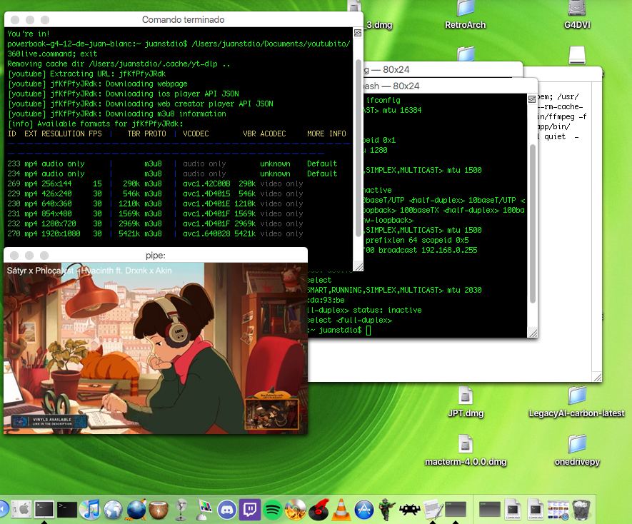

Last update! Here is a version to watch youtube live under 360p (recommend to use a LAN Connection, the poor airport will have a bad time to get on time with the frames):
export SSL_CERT_FILE=/Applications/PPCMC.app/certs/cacert.pem export REQUESTS_CA_BUNDLE=/Applications/PPCMC.app/certs/cacert.pem; /usr/local/bin/python3.11 /Applications/PPCMC.app/bin/yt-dlp/yt-dlp --rm-cache-dir --prefer-ffmpeg --ffmpeg-location=/Applications/PPCMC.app/bin/ffmpeg -f 93 "$(pbpaste | sed 's/.*v=//')" -o -|/Applications/PPCMC.app/bin/ffplay -vf scale=in_color_matrix=yuva420p,format=rgb32 -loglevel quiet -
I'm running all of this under a G4 DVI with 768 MB of RAM
During recent times, our friend YT has changed some rules to visualize Livestreams. Don't worry I got cover for this!
After Reading some issues on YT-DLP github https://github.com/yt-dlp/yt-dlp/issues/10206 I got a way to yet still get livestreams via ffplay.. trick is to combinate the proper values for each format.. for example
229+234
229 = 426x240
234 = mp4 audio only
Bash:
export REQUESTS_CA_BUNDLE=/Applications/PPCMC.app/certs/cacert.pem; /usr/local/bin/python3.11 /Applications/PPCMC.app/bin/yt-dlp/yt-dlp --rm-cache-dir --prefer-ffmpeg --ffmpeg-location=/Applications/PPCMC.app/bin/ffmpeg -f 229+234 "$(pbpaste | sed 's/.*v=//')" -o -|/Applications/PPCMC.app/bin/ffplay -vf scale=in_color_matrix=yuva420p,format=rgb32 -loglevel quiet  -
Tested with LoFi Girl YT Livestream:
