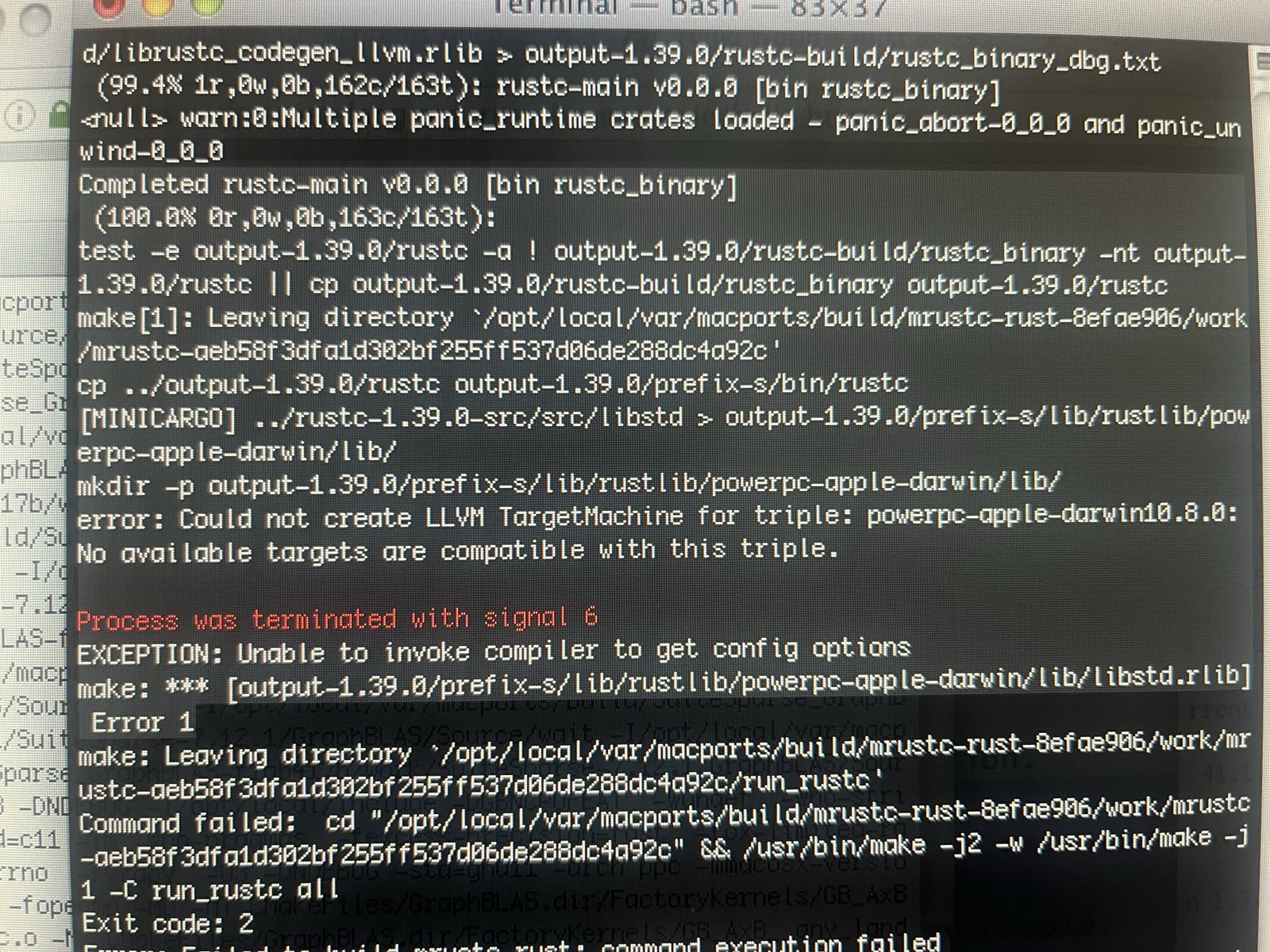

A few updates: I switched to rustc 1.39.0, since 1.29.x has a stupid bug with creating directories, and I do not know how to fix it (and upstream commit claiming to fix it did not). 1.39.0 requires LLVM-9, however incompatibilities with LLVM-7 are minimal and trivial, and should be fixed in this patch.
This is a more recent version of portfile – however I did not commit the latest changes which I had locally, and won’t be able to until end of month.
The current status is that everything builds up to the end of bootstrap stage (so rustc is built), however something does not work with creating LLVM target, so it is not usable at the moment.
Possibly, target specs has to be modified, but I am not yet sure. It takes a lot of time to rebuild (and it does not allow to recompile a single file).
mrustc itself appears functional (since it compiles rust in bootstrap stage), but I have no idea what it can build aside of rustc bootstrap.

Thank you for your work on mrustc again - it looks like I should prioritize checking that llvm 7.1 for powerpc works on Tiger before trying to catch up with you on mrustc.
If your aim is rustc, then LLVM is a must at the moment. (gcc codegen is not yet ready, AFAIK, and not implemented via mrustc at all.)
mrustc on its own does not use LLVM.

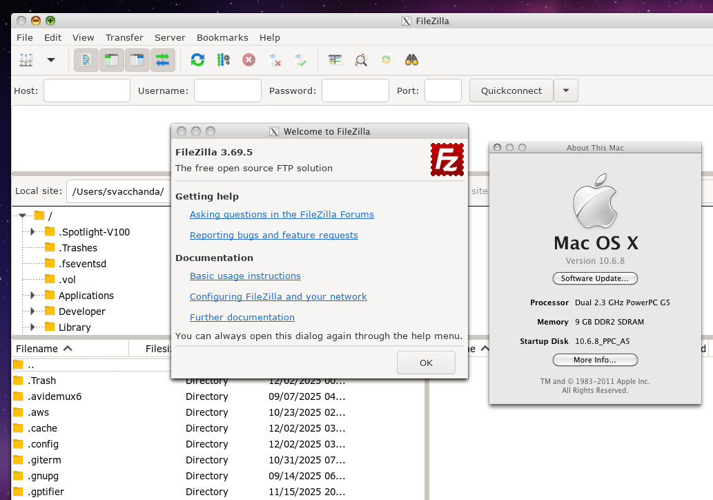

FileZilla updated to the latest version:
P. S. @Forest Expertise Tiger will probably work with wxgtk-3.0, if you restore hacks for it (they became unneeded with the move to 3.2, so were dropped earlier).

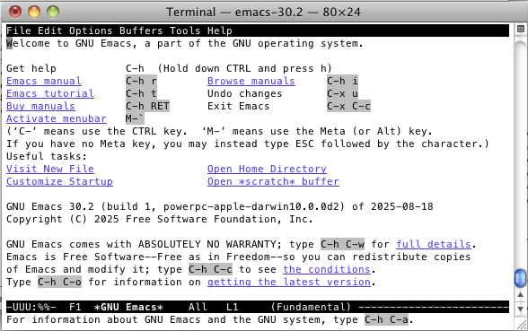

Has anyone tried compiling emacs? It seems to fail either with the emacs or emacs-devel port :(
EDIT: Forgot to mention - on 10.5.8 or 10.4.11 as sleep is apparently broken on 10.6.8 :/
EDIT: Forgot to mention - on 10.5.8 or 10.4.11 as sleep is apparently on 10.6.8 :/
It is probably the only port which builds on 10a190 but fails on 10.6.8. I don’t remember if I tried on 10.5.8.
The thing looks like an obscure upstream bug and should be reported in fact.
I have no explanation at the moment why the build works on 10a190 though.
P. S. You can still use ports from 10a190 on 10.6.8, and my pre-built packages have emacs.
I will check what happens in Rosetta. This should be fixed properly, we cannot rely on building a single port on a different OS version – moreover, I dropped support for 10a190, so my installation is not updated anymore.
UPD. The build in Rosetta also fails LOL
But the existing pre-built package runs:
