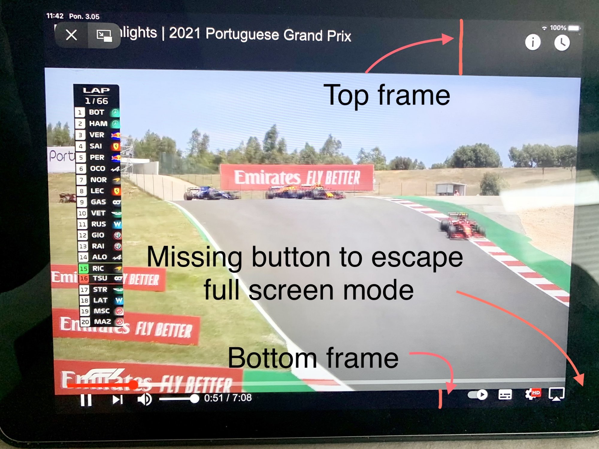

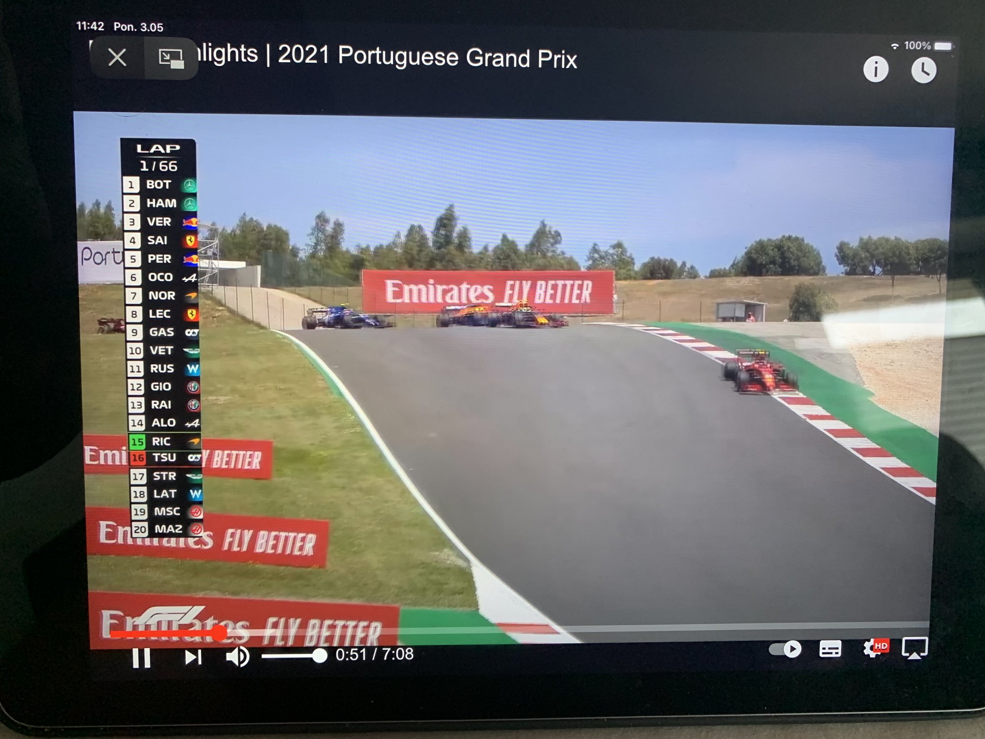

I have iPadOS 14 for quite some time and I noticed, that this version struggle so much during YouTube watching, it is almost unsuable. I contacted with Apple and they checked device, cause I thought it was damaged… Hardware is ok. Software - it was restored few times, even installed as brand new, without iCloud backup. So:
- response time after i click enlarge the video in Safari is terrible, it tooks sometimes 2-3 seconds to react and during that time video freezing
- very, very often after enlarging video, it is bad scaled. Black bard on top and bottom are not the same size, few buttons are cut out
Apple service said no one else contacted with such problem. I bought this iPad after event in 2018 and in 2020 I installed iPadOS 14. I remember how long iPad Air 2 last without problems. 6th gen iPad took only 2 years to be unusable 🙁 anyone of you have similar problem?
I know it has A10 chip, but in my mom’s iPhone 7 Plus Safari works superb. I wish I could go back to iOS 12 or 13 officialy 🙁

right now I edited old picture, now you can see missing buttons and unmatched bars. I just don’t know what to do… Apple seems have no problem with that…

Interesting, I experience the same issues on my 6th gen iPad. I just kind of figured ‘they’ want you to use the YouTube app so playback in Safari is a little more buggy.
For clarification the two things I experience are:
1. Going full screen often cuts off part of the image. To fix this I rotate the device to portrait mode (you then see the image ‘snap’ to the center of the screen), then back to landscape all whilst playing in full screen mode. It is then properly aligned.
2. Going full screen with a video is indeed quite laggy.
Once playback is underway it all works fine and smooth, so I have taken the above for granted. You get used to having to rotate the device at the start of playback…
Is this behavior not normal for other models?

I have also iPad Air 4 gen. Enlarging it is smooth like my face after shave… No problem with scale, missing buttons etc. So IMO this is problem with 6gen and either A10 missing power or maybe because of 2 GB of RAM? The 7 gen I had for few weeks (same chip, more RAM and 10,2” screen) seems flawless

I have had this behaviour (part of the screen hidden) occasionally but I can't reproduce it systematically on any of my (many) iPads...
The lag is due to a combination of CPU and (lack of) RAM.
It's not Safari, it's youtube. The youtube app is much more optimized, but, if like me, you don't want ads, you use Safari.
Youtube on a browser is pretty demanding when it comes to maximizing, minimizing etc. Even the A10X has some stutters at times, only the the A12 an up is completely lag free.
As for RAM, I have the 9,7 pro with 2GB and the same A9X pro on the 12.9 with 4GB RAM
The 9.7 is more laggy and it can freeze, the 12.9 is laggy too but it does not freeze thanks to RAM
People tend to underestimate how much power and RAM the youtube apps needs on a browser.
It's the same in the top of the line Android Tab s7, the youtube app is lag free, while on a browsers it's a bit laggy.
The Tab S7 is similar in power to the A10X...

Report it to Apple. It seems like it isn't getting sized properly when going to fullscreen so some of the elements are offscreen. I checked on the Air 2, 5th gen and 6th gen with A8X, A9, A10 + 2GB RAM respectively. It was the same deal on all of them but rotating does fix the rendering so this can be fixed via software. On the 7th gen (A10/3GB), switching to fullscreen was fine but there were some minor stutters.
