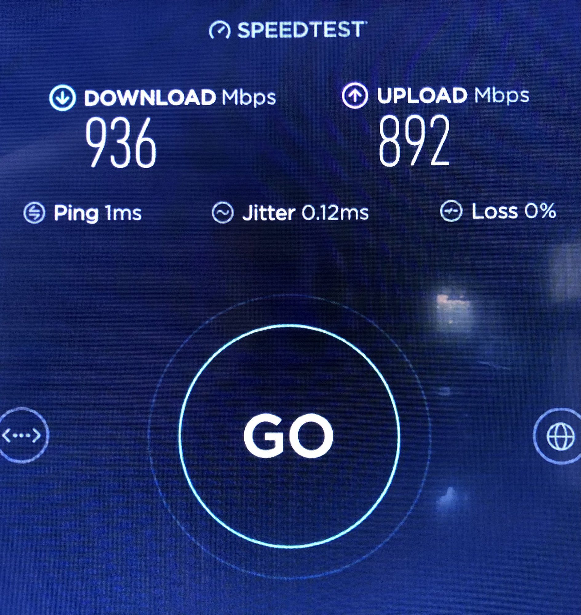

My hardwired ATV was the original hub until it got turned off. Funny thing is, hub duties still haven’t returned to it even with a gigabit connection!
