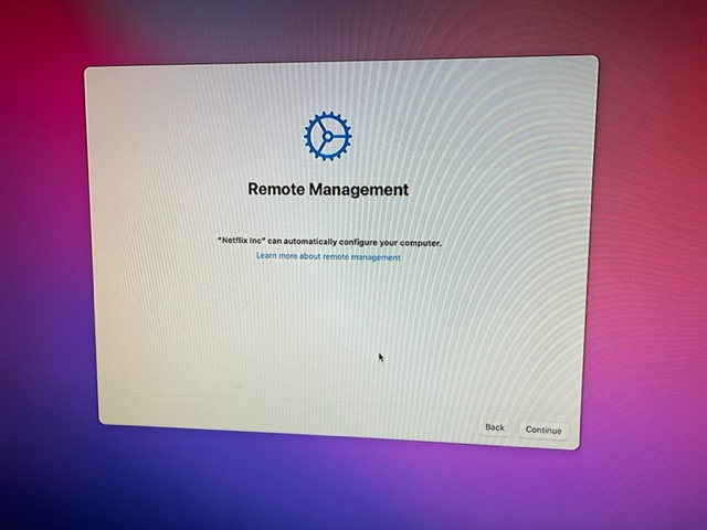

I am installing monterey using oclp on my new old macpro 5,1 that i bought from fb marketplace. I'm stuck on "Remote Management". I can't go forward. Im stuck. Any help would be much appreciate it.

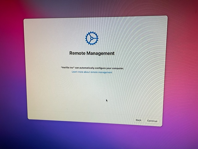

There is a configuration profile in system preferences that needs to be deleted. You should be able to do that with admin privaleges

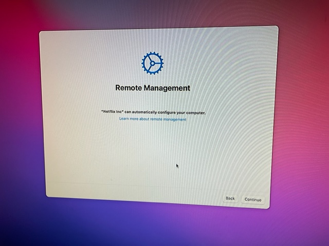

Well, you might have bought a mac that belong to Netflix and they manage it. A. they forgot removed it from their management platform or B. it was stolen and resold and you're stuck as it will not do anything until they get it removed.
You could start over but not let it connect to the internet and they try what @sfalatko stated
okey, here what I did..... I took out the original hard drive ( Nov 2006) and installed a blanked 255 gb ssd and loaded with high sierra then I insalled montrey via OCLP and followed the processes. It workes fine now. No n Netflix BS. Thank you for your help. I hope this helps someone with same situation like me. O, I have re install EFI file and other motions. If anyone needs help, shoot me a message, I will try my best to help.
It's a Vinatage experience! It took me 2 days to figure this out out, My wife thought I was cheating. Almost costs me a marrage. JK
