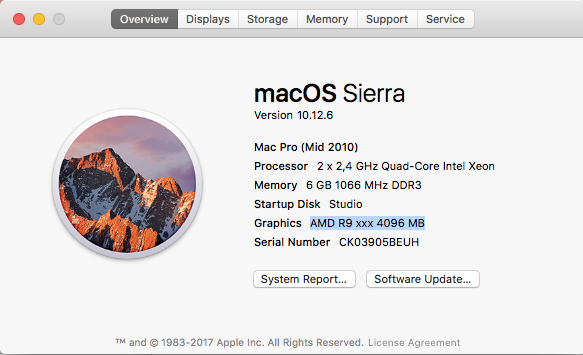

I have a mac pro 5.1 (mid 2010) with Sierra 10.12.6. I've tried to change the graphic card to AMD Radeon RX 570. First it seems like it works immediately (oob) after installing the physical hardware. It boots with no problem, I can watch movies, browse the internet, starting up all programs etc..
The first problem is that in the About This Mac it says I have a AMD R9 xxx 4096 MB instead of the RX 570.

Unable to show the correct name is normal in MacOS, unless you are running a flashed card (which is not available for 570), or the Sapphire PLUSE RX580 8GB card (Part#s: 113-4E3531U or 113-4E353BU).
Also, the PCI section in system report (or system info) shows error is also normal (fixed it 10.13 beta).
