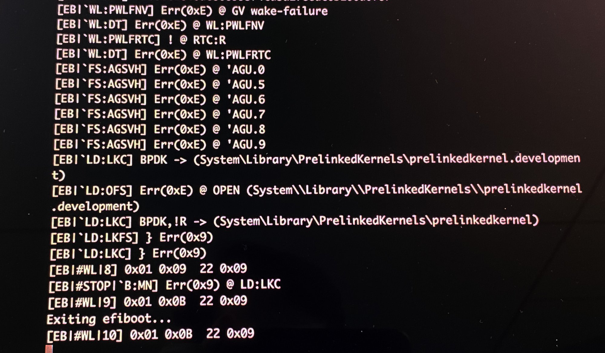

Hi,
I'm running Catalina 10.15.7 on a Mac Pro 7.1 , and I recently I installed the security update 2021-002. Since then I'm having trouble booting, getting the prohibitory sign every 2-3 attempts in a row, then being able to boot and log in. I can then boot successfully one or two times until it starts all over again with the prohibitory symbol.
Attached is a screenshot of the log I'm getting in verbose mode. Can anybody tell me what the error codes mean and what could be the cause of the issue?
I have already tried:
  • resetting NVRAM,
  • repairing disk in recovery mode (no errors were found)
  • rebuilding kernel cache through terminal
  • reinstalling Catalina 10.15.7 freshly from a USB stick
None of these measures helped. Even after a fresh install of Catalina, I still got the same exact behaviour.
Any help is much appreciated, thank you.

I'm still getting the same error messages in verbose mode as shown in my screenshot in my original post. Does anybody here understand what the error codes mean?
