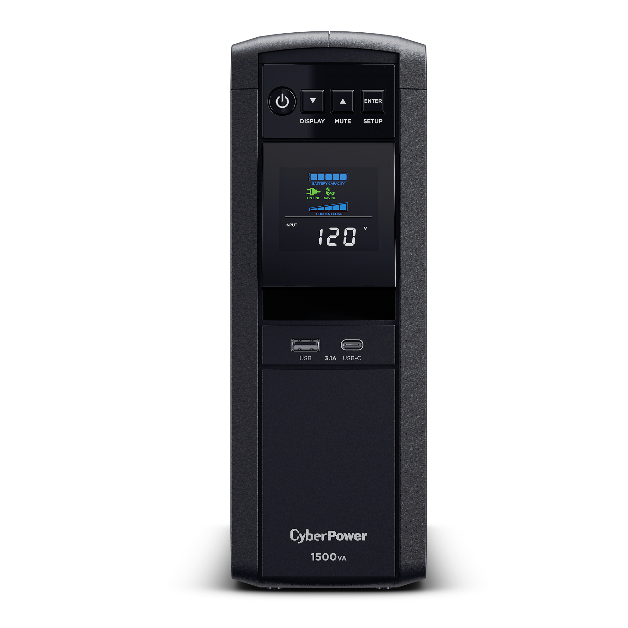

CP1500PFCLCD
A mini-tower UPS with line interactive topology, the CyberPower PFC Sinewave CP1500PFCLCD provides battery backup (using sine wave output) and surge protection for desktop computers, workstations, networking devices, and home entertainment systems requiring active PFC power source compatibility...www.cyberpowersystems.com
The Cyberpower CP1500PFCLCD is a good unit and has lasted a long time without nagging me with annoying beeps like the APC's used to, I do notice it boosting whenever there is a low voltage event. Also runs well when there is a power loss. I have some 10+ year old Mac Pros running on these and no power supply damage.

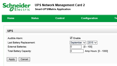

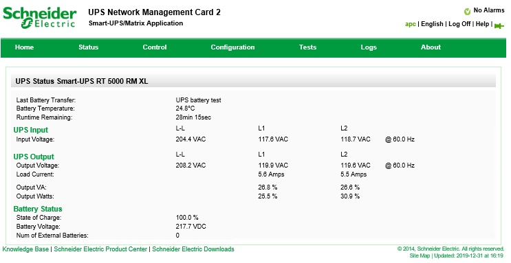

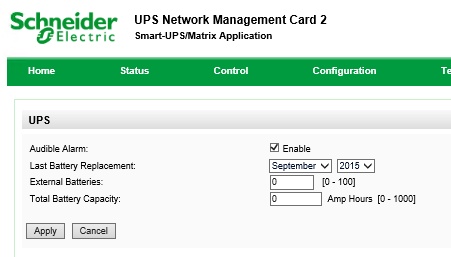

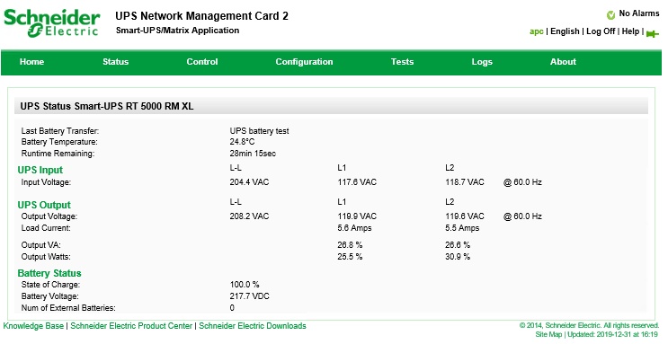

Categorically untrue, in my experience.Batteries in an APC die after 2-3 years
Four years and three months - still 100%
I'm sorry you have been swindled for decades and, in the classic clueless IT fashion, I feel sorry for your users who have to deal with your lack of knowledge.Put up, or shut up.
Proof? You said 2-3 years, I showed a system with over 4 years. You moved the goalposts with a "way out of range" claim. I've been talking about 1500VA to 3000VA Smart-UPS units - a 5000VA Smart-UPS is not "way out of range", it's just the next step up "in range".It's unconscionable that APC generates thousands of tons of toxic lead waste by purposely lowering the lifetime of their batteries.
I've been talking about 1500VA to 3000VA Smart-UPS units - a 5000VA Smart-UPS is not "way out of range".
APC is very good about recycling their batteries - they even include return shipping coupons for sending the old batteries to recycling centers. You've not only failed to justify your "2-3 year" claim, but you've moved the goalposts again with a recycling claim.
