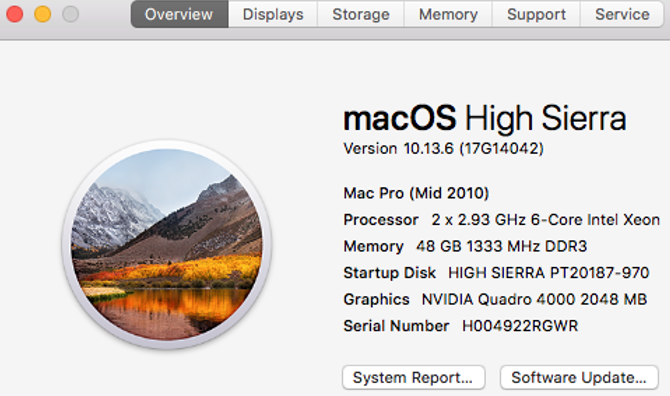

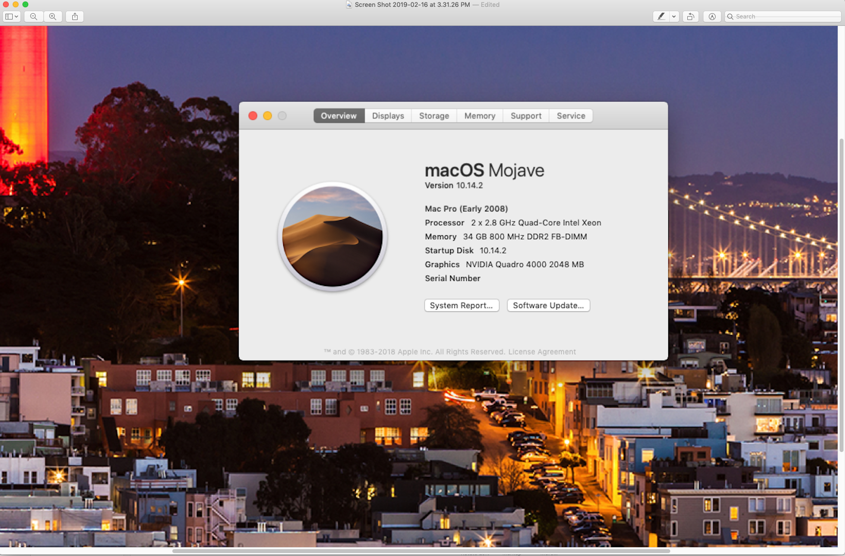

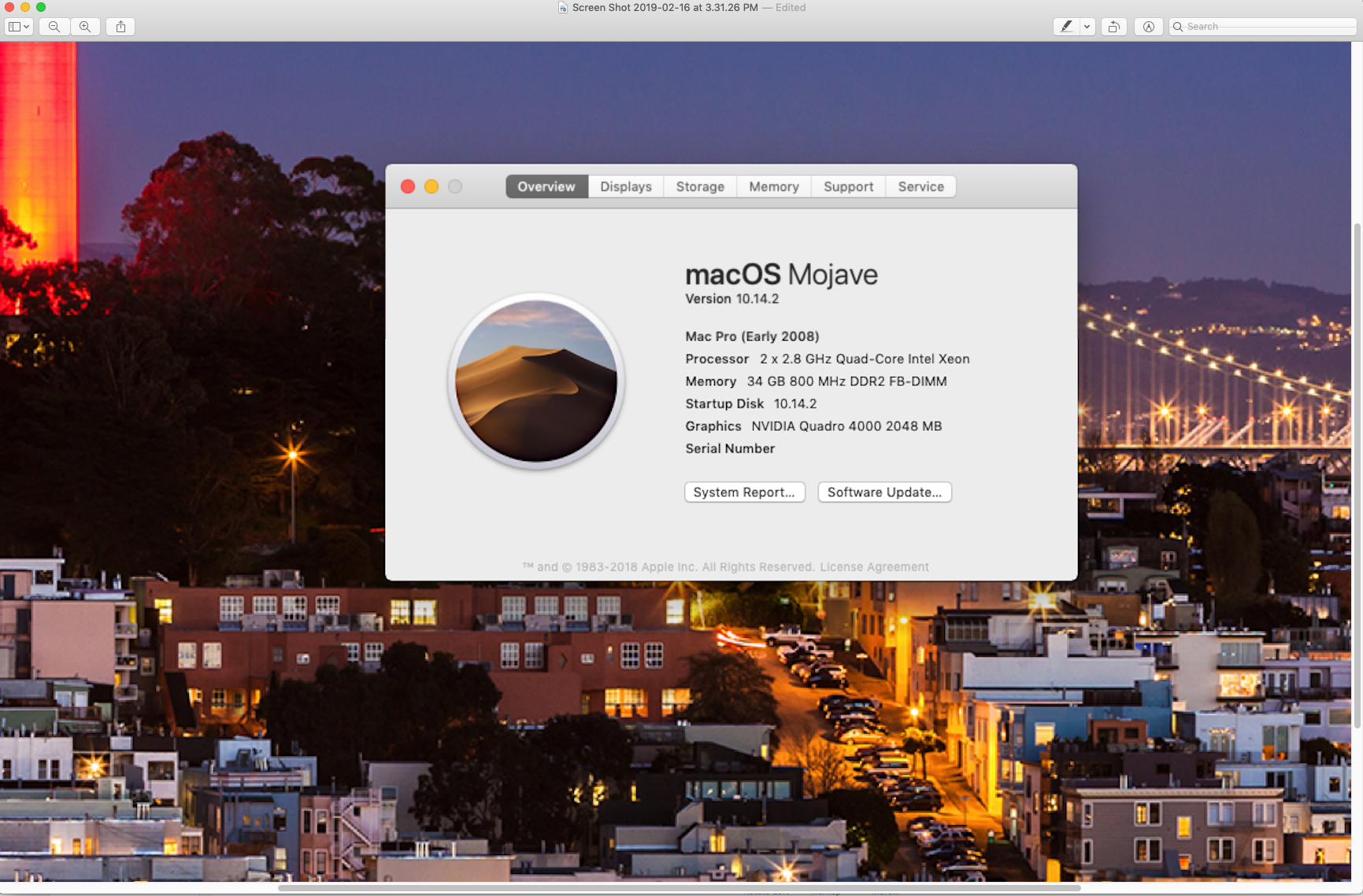

I've installed Mojave in a 2012 Mac Pro without having to do anything with the drivers or anything else. The Mojave installer properly recognizes it, but I did see some artifacts when moving windows around. I did not do extensive testing as I just needed to be able to get Mojave installed and running on a Mac Pro for specific testing that did not rely on graphics performance.

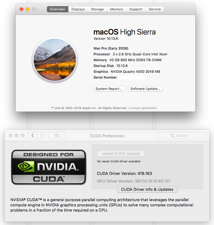

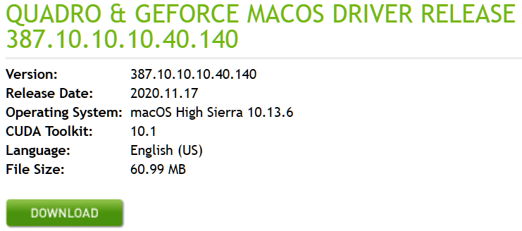

I guess I'm staying on High Sierra with the useful info provided by Alex. Anyhow I have *two* Quadro's running. I installed the appropriate drivers from NVIDIA 387.10.10.10.40.140 along with CUDA 418.163.
After I installed CUDA it won't let me login in to my computer, but if I shut down and disconnect the second monitor and restart the computer automatically boots up fine. I've tried switching to ( allow access to all users ), from restrict access to admin's only and it still won't let me boot with two monitors plugged in ?
Will only let me login with only one monitor plugged in. I tried to research and found an article about Xcode needs installed ? THANK YOU
Yeah it's weird that I can't run both on boot up. Going to uninstall CUDA and see if that makes a difference.
Probably don't even need CUDA since I'm just working in audio on Pro Tools and not doing any video intense work. THANKS
May I ask what High Sierra build you have. I have GPU Driver Version 387.10.10.1040.140 / CUDA 418.163 and have a red Exclamation mark on the page.

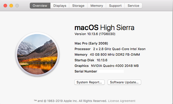

Sticking with High Sierra on this particular machine running both Quadros. I did a fresh install so I could completely remove Cuda which was not letting log on to my computer, only when I removed one of the cards I was able to login. Very strange and couldn't find any info as to why that is.
But should I install the Nvidia web driver, or just stick with Apples driver. I only use this machine for Pro Tools and not doing a video.

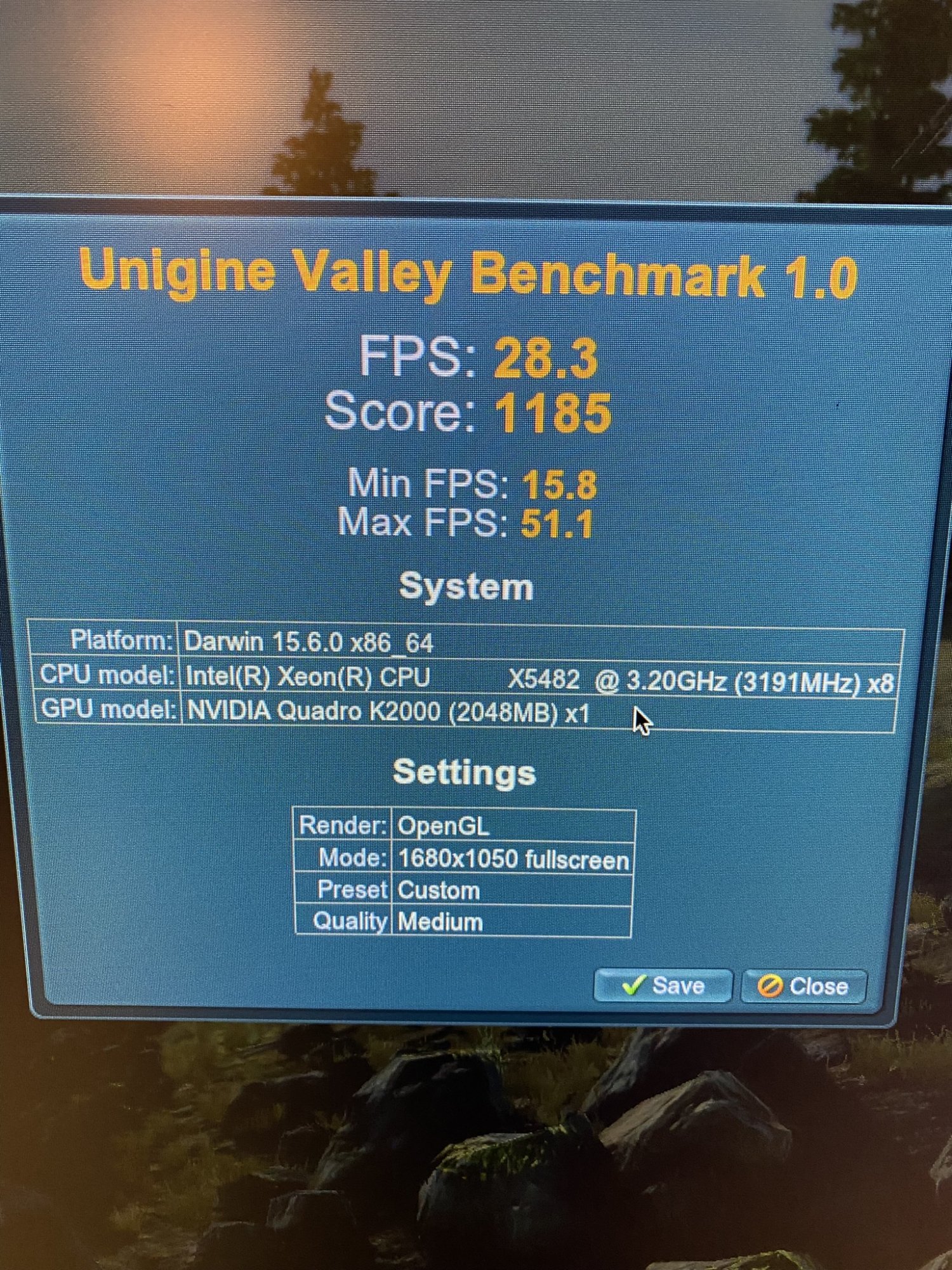

Hi Philip,
I think the K2000 works great, I’ve seen zero issues so far (minus the goof up I made during the install with the legacy video drivers).

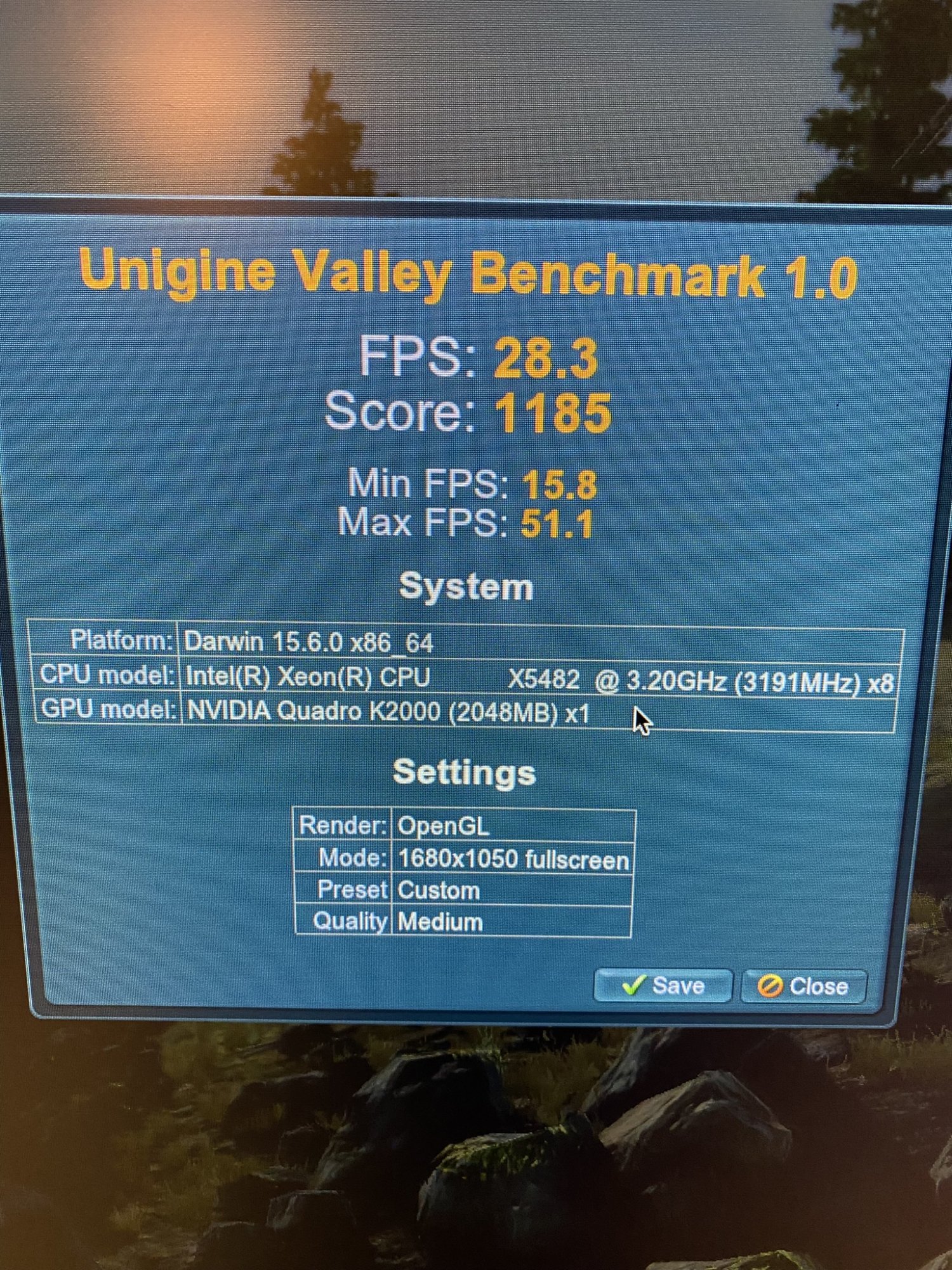

I’ll attach a photo of the “Unigen Valley Benchmark” that I ran on the 3,1 with the K2000 so you can see those numbers.

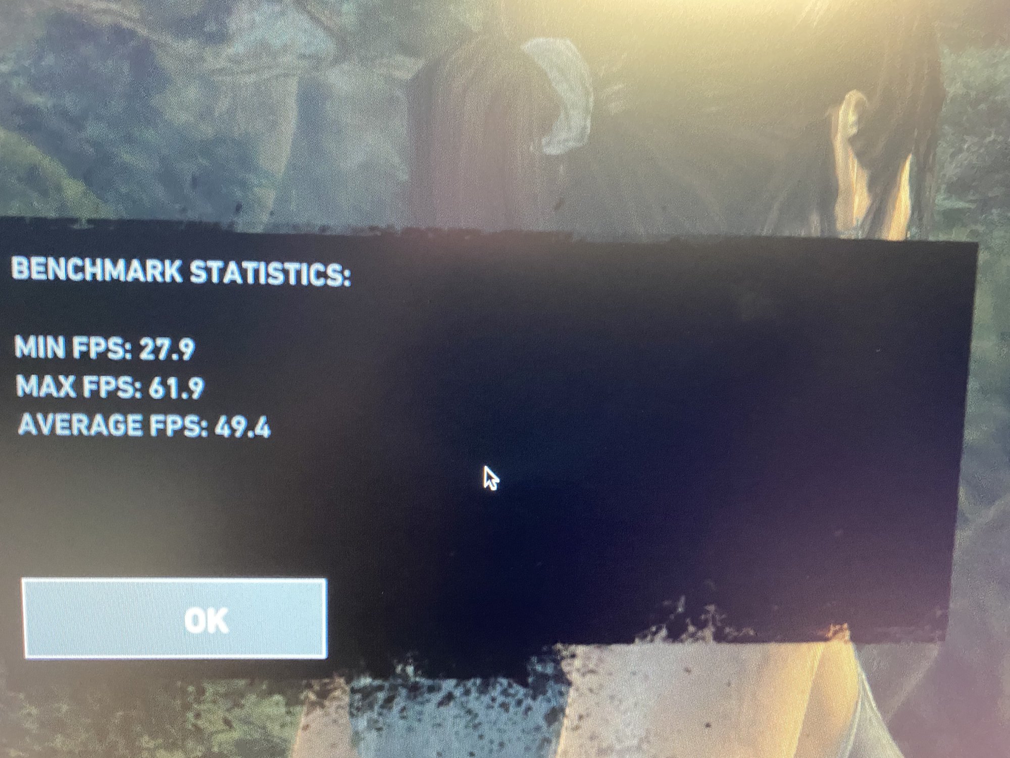

I also installed Steam and some of my games there and will attach a photo from the “Tomb Raider” game benchmark results.
Honestly though I think that benchmarks don’t really show the whole picture and with that said I really like the Quadro K2000. If you could get a K4000 that would be even better.
